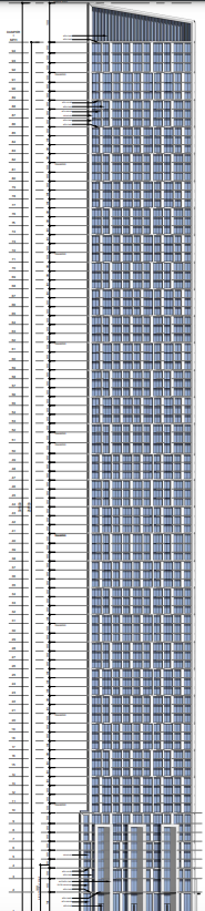

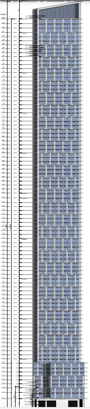

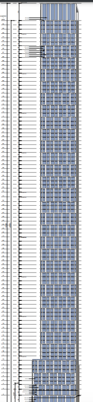

Okay, higher-res images for everyone, pixel-for-pixel from the architectural docs:
My take on these being the only renderings is that this is an early salvo, that they know the City will not accept this as submitted, and therefore they don't want to spend more than they have to on renderings until they have a massing agreed to sometime later.

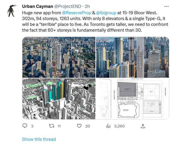

@ProjectEnd is out with some thoughts on this proposal. As usual, he's completely on-the-fence in his opinions, and your just not clear on what his take is........LOL
Seriously, PE is raising great points; I'd go a bit further........
Lets talk about potentially serious problems.
1) Evacuation in the event of a fire. 94 floors is along way down even for someone able-bodied, never mind the problem of someone in a wheelchair or the like. There's also a time elapsed question. If smoke is filling a building, how many minutes of breathing that in can one sustain? PS, the time model for an older adult using stairs is typically 1.3 seconds per step. Assuming 22 (or more) steps between floors, depending on ceiling height, that's 32 seconds per floor. At 94 floors, that's over 45 minutes to exit the building.
2) Evacuation/need to exit can be an issue for just routine life in the event of an elevator failure or power failure. Are we considering exactly what back-up power needs to be able to support?
3) We've seen examples of people who literally couldn't access their units by elevator for weeks. Sufficient redudency to each floor is crucial.
4) A few buildings have now made clear the problems of water supply to upper floors, both in the mainline risers and in fire suppression systems. Pumps are required, and pumps can and do fail. Not only do we need to reduce the risk of failure and ensure backup power for these; we also need to talk redundancy.
5) Even with firefighter operation of an elevator, we need to talk response time impacts over such long distances (same with EMS and Police).
That's without getting into myriad other details; and the complexity of future maintenance for condo boards as well. Many have performed poorly on much smaller buildings and simpler buildings, this becomes an even greater concern with a building such as this.
In addition to these concerns, would this project be AODA-compliant?
I've never been on the elevator of a 70+ floor condo like Aura or One Bloor. How long is a typical wait for the elevator, say at 8:30 am or 5:30 pm?
Love to see someone photo shop this building by cutting this building's width in half. But keeping the height and remaining part of the tower to the west portion of this parcel of land. To be further away from The One tower in the photo up above might just look better lol!

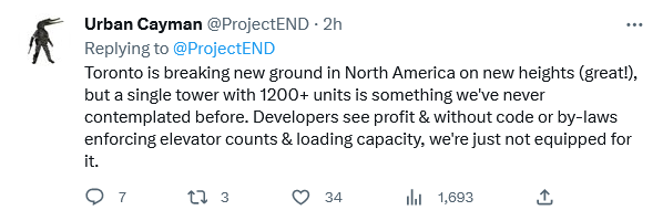

We've put a front page story up now too, looking at the various numbers here, including things we've been taking more notice of lately like the number of units per elevator, the tight separation distances, and this time we've also noting the FSI, which is the highest we've ever seen in this city.
