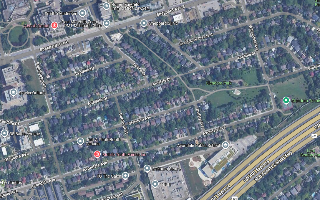

Every single development in this area should be acquiring lots to expand Glendora Park.
This serves 2 distinct purposes, one it gives a base area, that when expanded could add a new sports field.
Second, there is a buried creek underneath this corridor (Wilket Creek) and with enough width in place, it would be possible to surface the creek here, and add a small amount of nature on either side.

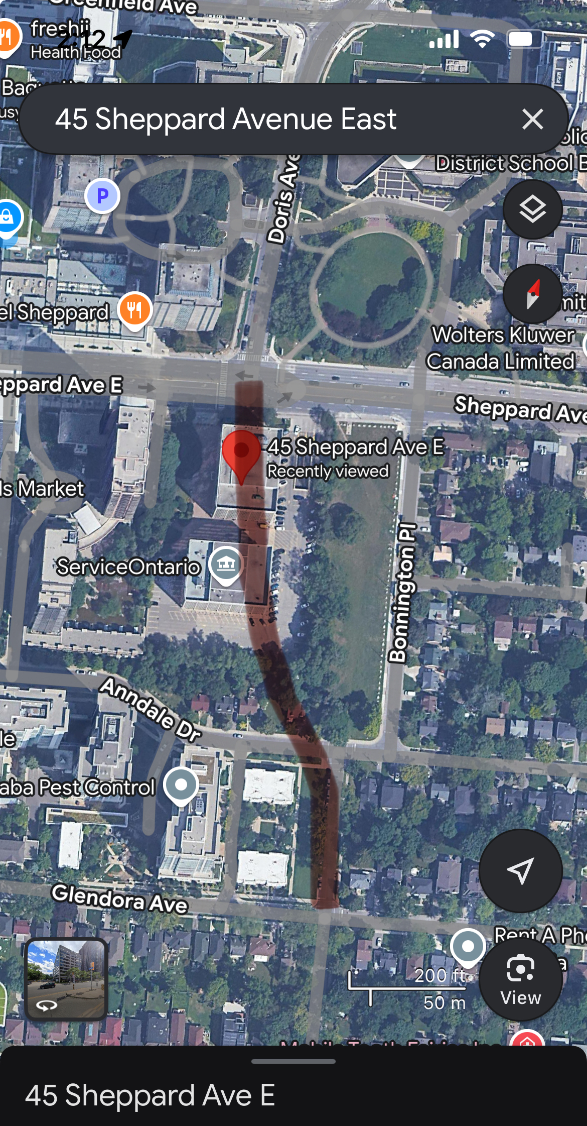

Surely something more like this could be devised with this new development being planned around the road.

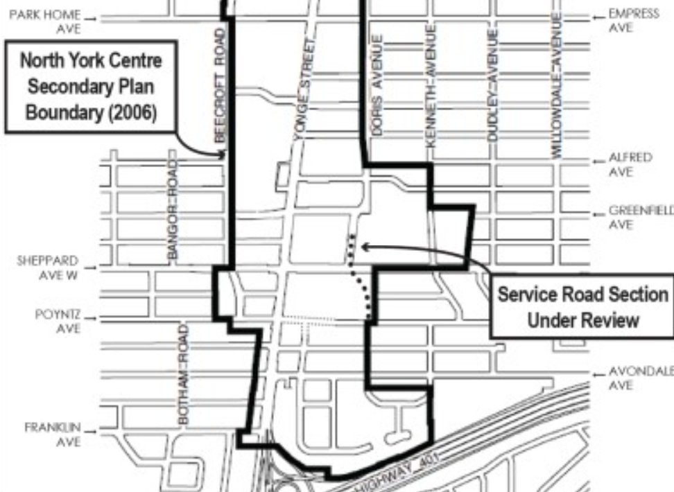

An issue with the above proposal is Doris Ave tends to serve as the boundary for the North York Centre Secondary Plan area - so if you extend Doris through the middle of this Subject Site,... the western portion closer to Yonge would allow high density,... but the eastern portion might only allow single residential houses or townhouses! And even if this eastern portion were to be higher-density,... it's adjacent to Single Residential House Neighbourhood zoned area along Bonnington Place would be protected by a 45 degree angular plane that limit the height of the higher-density area - likely to about 11-15-storey with terrace top, depending on lot depth!
That's why it's much better to have a road as boundary to Secondary Plan - one side can be high-density with no tapering,... while other side is Single Residential House Neighbourhood

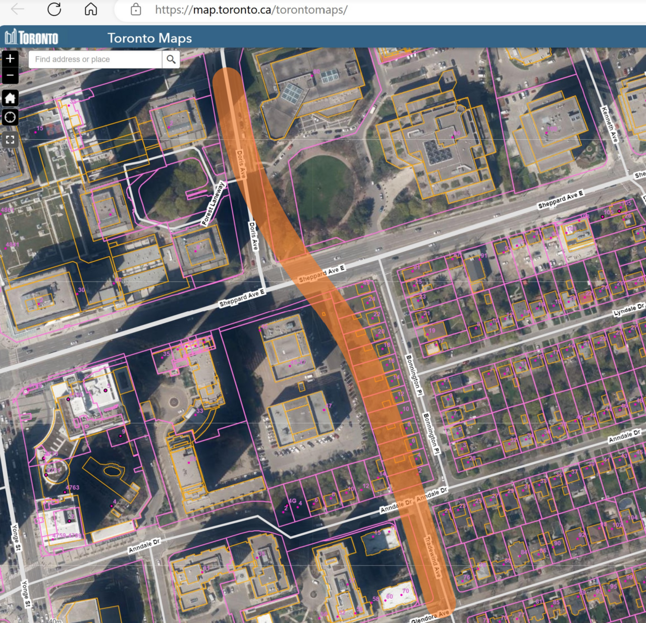

This image shows property lines (pink),.... and I would envision the Doris South Extension to intersect Sheppard with soft S-curve like this:

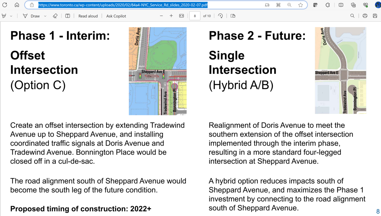

- this preserves the Circular Mound at MooreHead Park (POPS at NorthEast corner of Doris & Sheppard) - CityPlanning (actually North York Community Preservation Panel aka: Geoff Kettel) wants to preserve it & that's why Doris South Extension was 2-phase intersection at Sheppard as I previously pointed out.
- NorthEast corner of this Subject Site would be conveyed as part of Redevelopment process,... that likely involves moving the proposed parkland dedication off-site and moving the NorthEast tower southward
- At NorthEast corner of Doris & Sheppard, their SouthWest portion of land can be expropriated,... but more likely wait for a Redevelopment proposal.
- also utilizes the City-owned land along westside of Bonnington Place, that the City got mainly via expropriation,.. about 4 lots were Land Conveyance from area Re-Development proposals like Tridel HullmarkCentre
I know you know this............but the Neighbourhoods designation is likely going away on anything between Sheppard and the 401 in this area......
I know you also know the angular plane is dead.
Now the principles that inspired it live on, but with greater flexibility.
