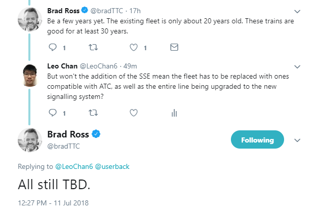

How will it cost an extra 3.5 billion to reconfigure line 2? Scarborough subway trains are supposed to be stored in tail tracks, signal upgrades will cost at most a 1.5 billion dollars (line 2 is about 4 Km shorter than the then line 1), and new rolling stock should only cost 1 billion dollars. It’s arguably unfair to even group these with the sse (which, admittedly, at this stage, is getting out of hand) since they are required (along with the Kipling yard) regardless if the extension is built or not.
I kind of asked the above, but it's still to be determined.
The answer is no.
The Spadina Extension has the ability to work in ATC mode and manual fixed block. And so will the SSE.
So they could potentially run the entire system in fixed block mode with the current T1 cars and some new TR cars all in fixed block mode until they replace the entire fleet with TRs.
The only reason the Sheppard subway got TRs is that they are planning to run the entire Line 1 in ATC mode come end of 2019, and they don't want to have to interrupt the ATC mode on Line 1 to bring T1 cars down back to Davisville yard.
You can run parts of a system in ATC mode like we are doing on Line 1 right now from Eglinton West to Vaughan MC.
You can also run the entire system on fixed block mode, they've had to shut the ATC off a couple of times on the extension and the converted part on Line 1 (Eglinton West to Sheppard West) due to teething problems. Fixed block manual mode is always available as a backup, even on newer extensions.
