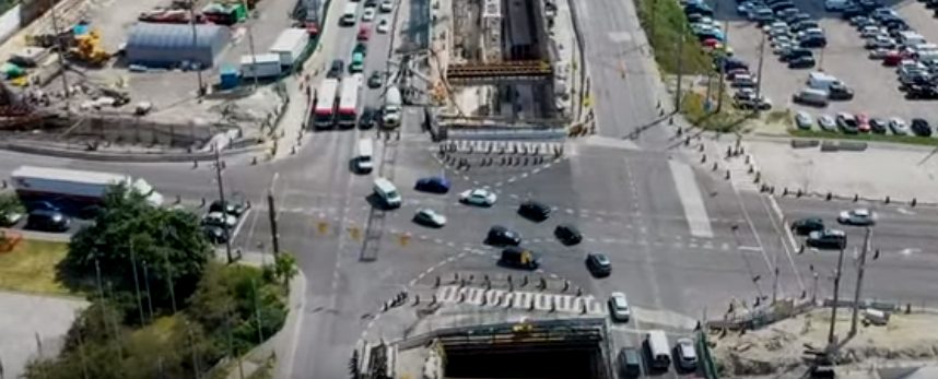

isnt it great how they put the LRT ROW in the middle of the road at Leslie, so trains will now have to stop and let cars turn left onto Leslie, instead of putting it on the south side of the street, where it would be unaffected by the intersection?
... F@&#ing morons man...

Clearly no one can follow line markings in TO. The lead car has to take most of the blame, the rest of the idiots followed. "I'm gonna turn like I do in every intersection without looking at what i'm driving into". I don't know what lane the east to north lead car is turning into? Maybe he hopes to hit the right turning bus? Or the pedestrians behind the pylon?

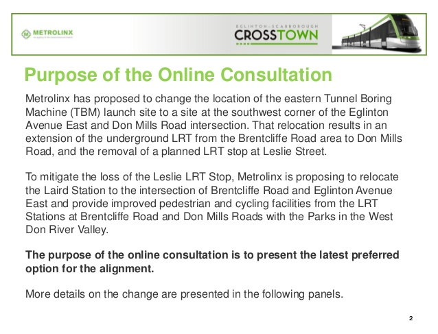

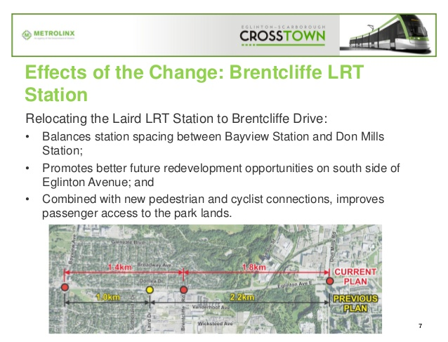

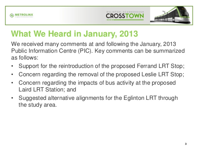

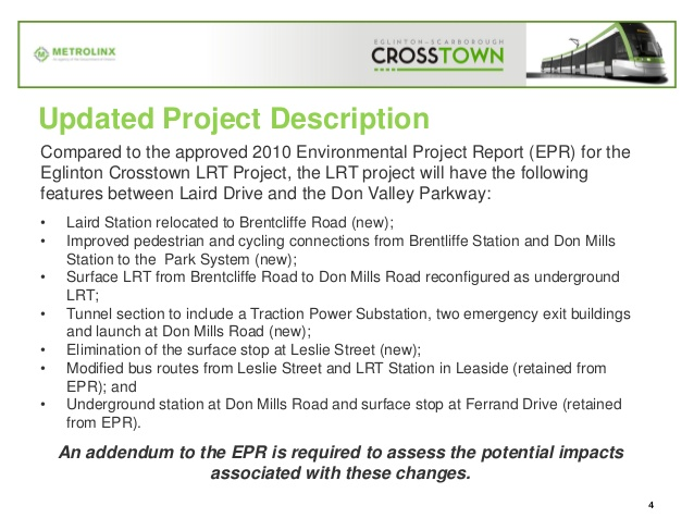

That aside... not mentioned at all in this discussion is that Metrolinx pushed to have the section between Laird and Don Mills changed to a bored tunnel beneath the Don Valley, with the Leslie and Ferrand Dr stops eliminated. They may have considered other surface options, but those were rejected in favor of a tunnel. Of course the documents have since been deleted as per Metrolinx's usual contempt for transparency, however I managed to pull a few slides from the deep web from a public consultation.

As for why we switched back to the original plan, you and @Steve X are correct. To elaborate... political posturing by councillor Robinson on behalf of some Leaside residents put pressure on Metrolinx to back down on eliminating the Leslie stop. The only way this would be feasible is to either go back to the original surface alignment, or pursue the "south side alignment". However because the latter would have required approval from city council, which at the time was too busy ripping up transit plans every six months and dealing with the mayor's crack scandal, Metrolinx had no confidence in their ability to make a decision in a timely manner and stick with it. Needless to say, "Fuck it, we're not touching you guys with a ten foot pole" was the easiest thing to do.
