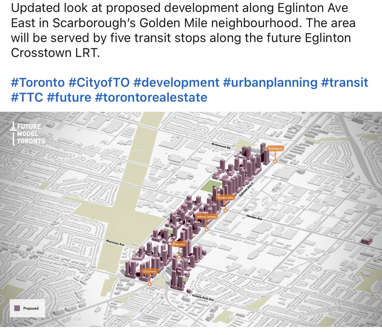

Development along Eglinton Avenue East from Victoria Park to Birchmount. Close to 100 new condos/mixed use buildings have been proposed. Also this isn't including majority of the south side of Eglinton which I anticipate proposals coming in for in the coming months. Good luck to the EGLRT East corridor along this route going to be a disaster waiting to happen.
The City should get funding from each of these developers to tunnel the east side of the LRT imo in exchange for permits.
:eek: :eek: You mean none of the parking lots were designated as "heritage sites"? Oh the humanity! Or inhumanity, depending on your point of view.:eek:

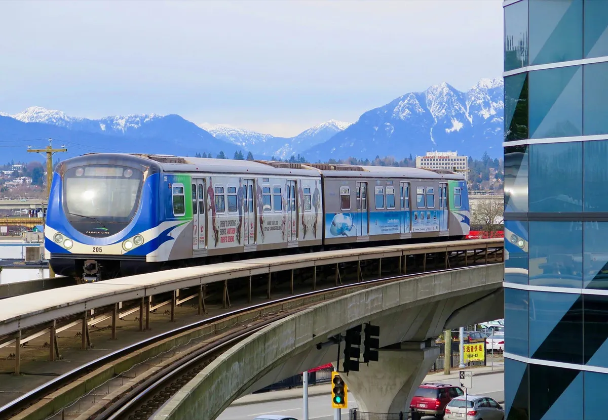

Not true, and the stations are built for 90m trains, how much shorter do you think they could be?
An 80m train running every 3 minutes has the same capacity as a 40m train running every 90s.
This is why the Canada Line has the same ultimate capacity as the Eglinton Crosstown.
That would be true if the trains were all pre-loaded and just running through a tunnel. Halving the headways will add dwell time, which in turn reduces the operational speed of the line and in turn its capacity.
Though I don't disagree with your general point, that smaller vehicles more frequently may yield to comparable performance with larger vehicles less frequently. I'm just saying that it's not a directly proportional tradeoff. An engineer could probably actually math it out properly.
How?
If anything wouldn't halving the headways theoretically reduce dwell times since you're boarding half of the amount of passengers? Ignoring spikes of passenger inflow from sources like transferring busses, say every minute a station gets 60 passengers. A train running every 90s will on average intake 90 passengers, meanwhile a train running every 3 minutes will on average in take 180 passengers. If we assume that the former train is 2x smaller, but still has the same entry/exit throughput, nothing should change in terms of dwell times.
Furthermore, we have to consider other factors as well. Often major outliers that increase dwell times would be things like people trying to catch a train that's about to leave in the last second - holding the doors open. The more frequently that a train arrives, the smaller the chance that happens as people will be more likely to not bother to catch the train, and simply just catch the one that's coming in 90s.

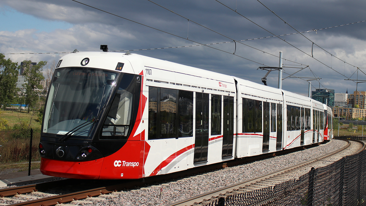

Finally, the point of comparison here is the LFLRVs used on Eglinton, versus High Floor vehicles used on the Canada Line. If you look at any low floor train such as the Alstom Citadis Spirit, you'll notice how irregular the door spacing on the train is. Because they need to squeeze mechanical parts like bogeys into specific parts of the trains, there are significant limitations on where doors can be placed, as well as how many doors per side. Earlier I said "If we assume that the former train is 2x smaller, but still has the same entry/exit throughput, nothing should change in terms of dwell times", however due to the limitations of low floor trains, we can't assume that they have same entry/exit throughput - the larger train in this discussion outright has a far worse throughput, and as such they have significantly worse dwell times than the smaller train.
