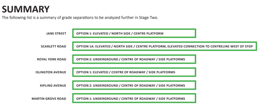

Three new files were just posted to their website:
These reports are better than porn for transit nerds.
From reading these, my fantasy set of grade separations are:
Jane: elevated, north side
Scarlett road: elevated, north side

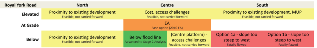

Royal york: elevated, centre of road but shift to north side for station (not considered)

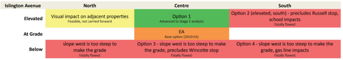

Islington:
elevated and north side with some mitigation measure for the visual obstruction, ideally expropriating the properties and re-developing them. If that can't be done then centre station.
This is the intersection in question so I don't think space constrains are insurmountable:

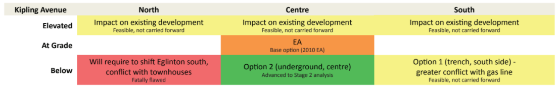

Kipling avenue:
North side, elevated:
Martin grove:
This is the most difficult to design for: elevated is listed as not an option because of the hydro corridor to the west, which makes sense. But this is also the intersection that has the most value in grade separating. At the same time, there is a gas line (running east/west?) that restricts underground options on the south and the reservoir on the north.
Centre, underground might be worth it, and it would avoid having to reconfigure a bunch of highway ramps. But I feel like there must be unexplored options (lowering the road, etc.) for this stop that would avoid having to bury it.
Islington:
Kipling avenue:
Martin grove:
