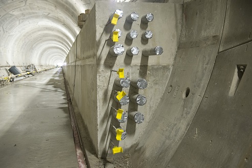

An interesting article on how power supply in the tunnels is being addressed.
http://www.thecrosstown.ca/node/2017

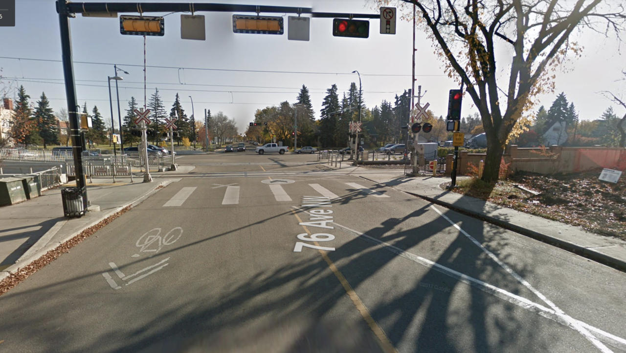

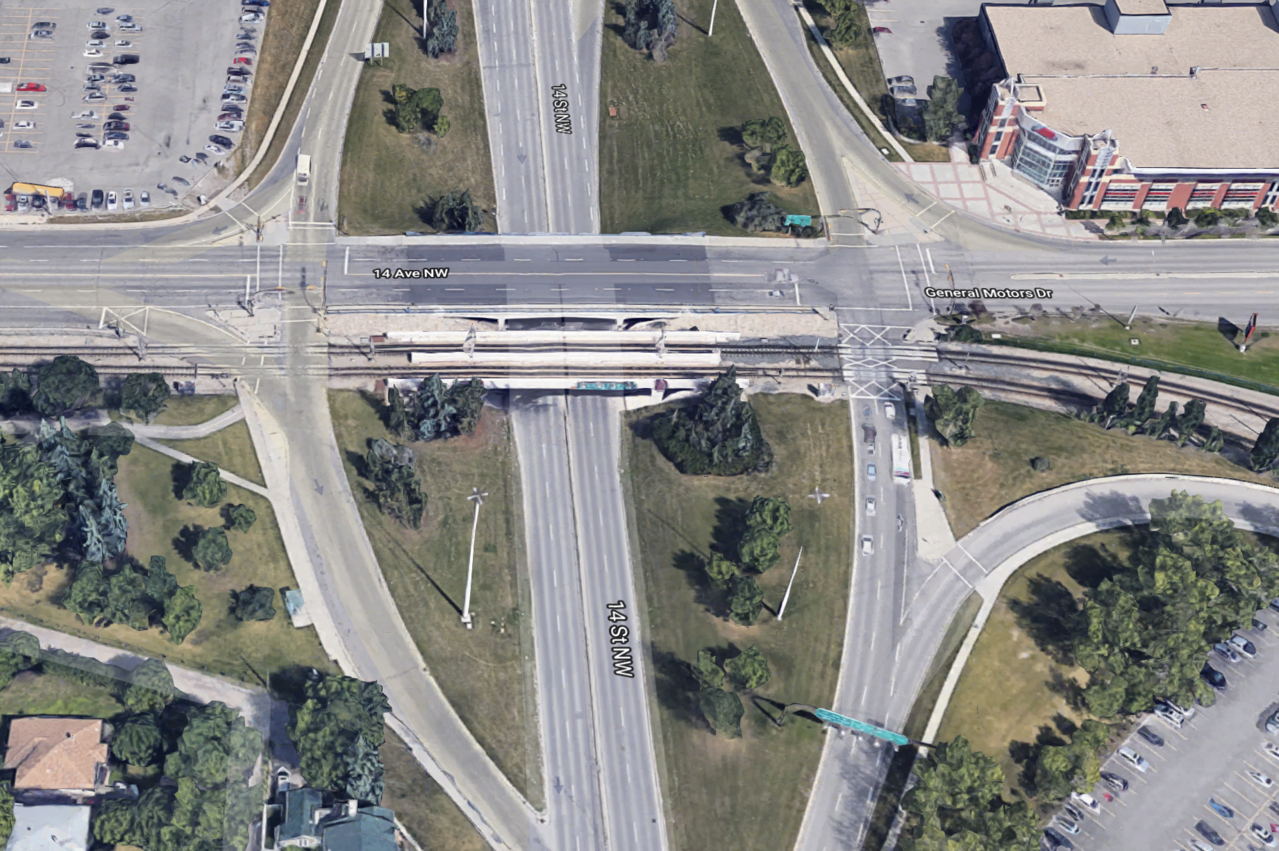

In my original comment I said that Seattle-style setup with crossing arms wouldn't reliably work, because pedestrians would need a certain amount of time (around 20 to 30 seconds) to safely cross Eglinton Avenue. With trains approaching any given intersection on average every 90 seconds, this would mean that the trains would still have to frequently stop to allow pedestrians to finish their crossings. This is true, but only for train right-of-ways in a centre-of-road alignment.
Looking at both the Calgary and Edmonton examples you mentioned, noticed that the LRT is running adjacent to the roadway, rather than in the centre. This means that a 30 or 40 metre pedestrian crossing is reduced to maybe a 10 metre crossing (I'm guesstimating here). Accordingly, the minimum time pedestrians needs to cross the street is reduced, and thus the Transit Signal Priority system doesn't require anywhere near as much advanced notice of an approaching train, compared to the Seattle setup. This allows stations to be positioned much closer together.
So this would likely work on Eglinton if the tram right-of-way was using a side of road alignment. Whether or not the side-of-road alignment is a possibility on the Eglinton West LRT depends on if their are properties adjacent to Eglinton Avenue that require access to the street. There are certainly homes and businesses on parts of Eglinton Avenue that require street access, so to accommodate them, the LRT would have to switch between centre-of-road alignments and side-of-road alignments. This weaving would require either a signalized intersection (similar to Queens Quay when the streetcars switch to side-of-road alignment), OR there would have to be a grade separation, to allow the LRT to switch alignment unimpeded by car traffic. I suspect these restrictions would render the idea infeasible for nearly all of the Eglinton West corridor.
Calgary:
Edmonton:
Calgary:View attachment 130008
Edmonton:View attachment 130009
The Minneapolis example I gave has the line in the middle of a large arterial road, as do much of the systems in Calgary and Edmonton. Pedestrians only need to cross as far as a refuge; this is no different whether the rail is in the middle or on the side. Even the weaving between side and middle alignments that you describe as making the idea infeasible is routinely done in other cities (this is where those selective grade separations I was talking about earlier are often used). The issues you're bringing up aren't the showstoppers you present them as.
