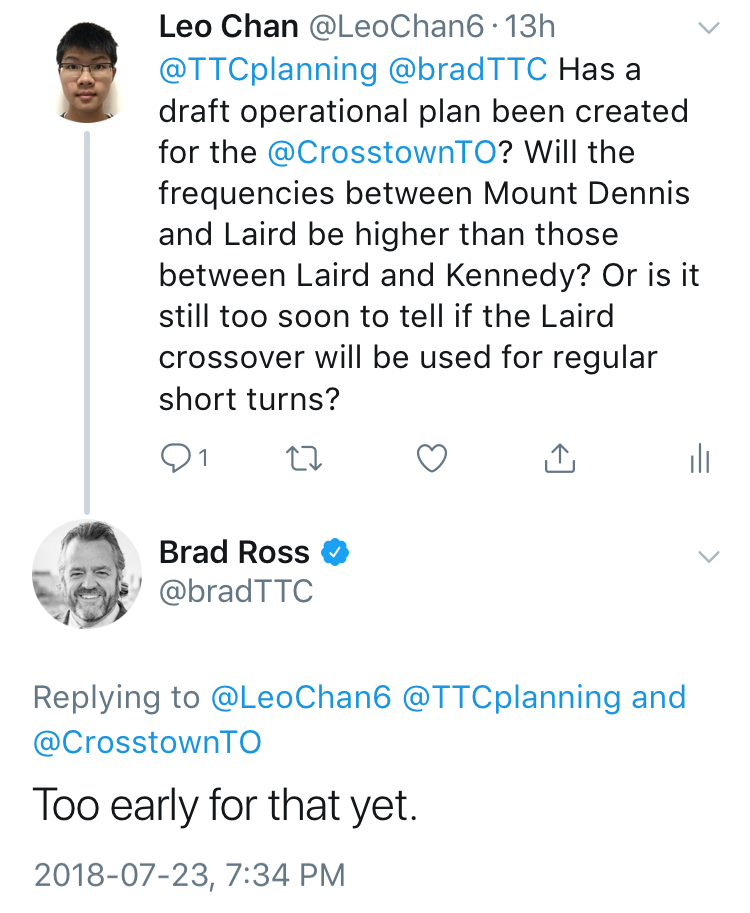

[QUDoes anyone know if it's been discussed how it will operate like will trains run the entire length of it or will some only serve the above ground sections and you will have to transfer at Laird
IF they had a loopback for service, it would be the other way around, some trains would only serve the underground sections. Ridership is lower on the above ground, it would make no sense to run more trains there.
Also, the TTC is going to have a hell of a time with train spacing/bunching and scheduling on this line. Trains will fly through the underground portion, to only be met with traffic lights, closer station spacing and other obstacles above ground. No amount of traffic signal priority will fix this.
I think it was a BIG mistake to not have a loopback at Laird, and this will be the biggest issue of the line.
What will probably happen is that the TTC will decide to switch to 3 car trains at less headways to stop the bunching problem.
What do you mean? There will be underground storage and crossover tracks at Laird.
How is it bad? It is close to the demand point, right?
The major demand point will be at Don Mills, even without the DRL reaching Eglinton, this is beyond where full service would operate with half the trains turning back at Laird.

It was a mistake not to grade-separate the Eglinton line between Laird and Don Mills. But, let's not overrate the impact of that mistake. Most likely, the line will still work fine.
Only if the demand greatly exceeds the current forecast, the inability to run more frequent service between Yonge and Don Mills will be felt.
DRL Long, if anything, would somewhat mitigate the said mistake. A large group of riders would transfer from the westbound ECLRT to DRL, reducing the demand west of Don Mills.
Line 1 has very uneven stop spacing, varying from ~ 400 m south of Dundas to 2 km (or more) north of St Clair. That, by itself, doesn't cause delays. Where the stop spacing is wider, trains run at a higher average speed and there is greater distance between trains. In the downtown section, trains run at lower speed and closer to each other. The number of trains per hour passing through every station is same (if we discount short-turning, that doesn't normally occur in the PM peak).
Likewise, the Eglinton trains will run at higher speed and more widely spaced in the tunnel section, having a lower speed and being closer to each other in the street section.
