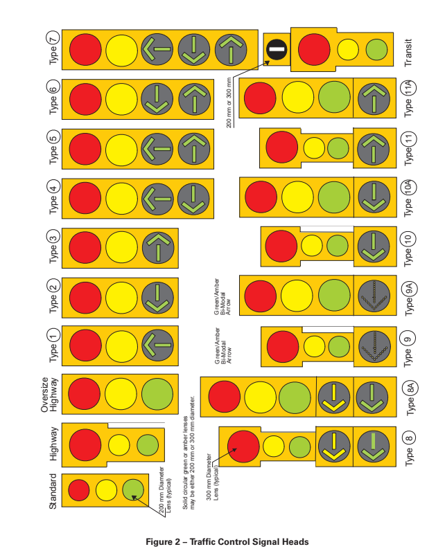

Regarding the dicussion of transit signals,
The only approved transit signal by the MTO is the single vertical bar atop a regular signal head:
IIRC Ion LRT got special permission to use the more traditional european signal head:
MTO updated Book 12 in 2024 and didn't include this style which is a massive disappointment.
