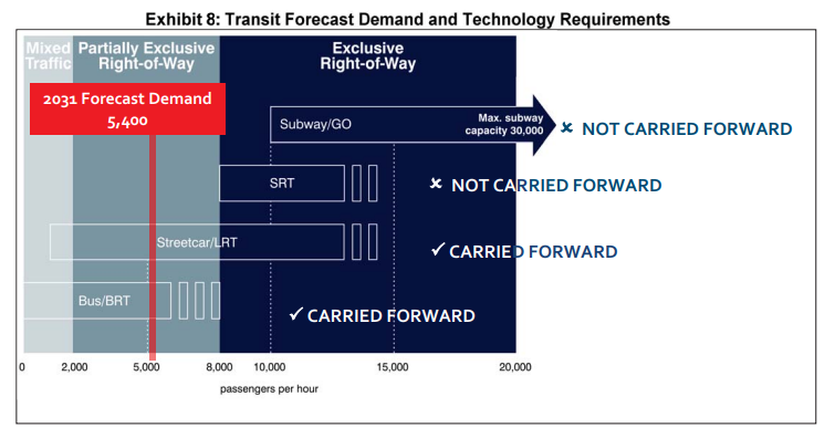

From the Crosstown EA from 2011:
My issues is that I hear a lot of speculation when saying that the expected 5,400 pphpd number is under-estimated and that the line is going to be at capacity very fast, but I don't see any actual evidence of that actually being the case. Has the City or TTC or Metrolinx updated their expected demand numbers?

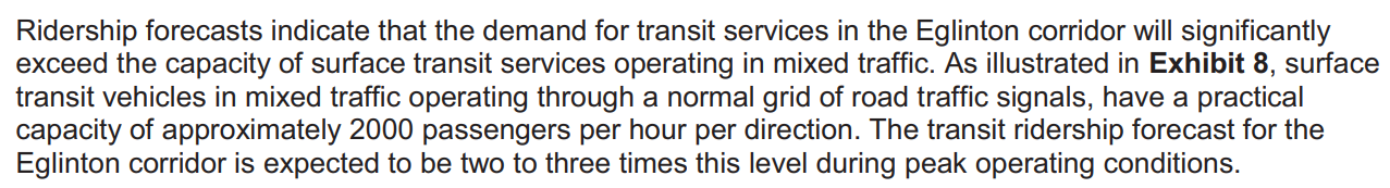

You're right, I mis-typed when I said the 34 bus has a capacity of 2,000 pphpd. According to the EA for the Crosstown from 2011, the maximum capacity for mixed traffic bus operation is 2,000. Meaning even in the areas of Eglinton East where there are multiple buses, the theoretical maximum is 2,000 pphpd. And that itself is pushing it as it'll be a bus every 1.5 minutes with 50 passengers per bus!
Yeah that number I would question, I've seen significantly higher numbers used to estimate peak hour bus capacity, 2000 might be for one line but I can think of lots of cases where its much much higher.
Yeah I question the validity of the numbers in the EA. Again they are from a time when Toronto was not growing like it has in the last decade. But also being familiar with ridership numbers for all kinds of lines and systems around the world they feel very low. 5,400 ppdph is not high for a line like this! Most other "rapid transit" lines in Canada carry significantly more people in peak hour - including in smaller cities like Calgary and Ottawa.

The numbers from the EA are pretty much moot IMHO. We have changed plans and projections of density so much across the upper city that only time will tell if we have added enough transit capacity for the density as it appears.
Please share the source of the significantly higher bus capacity. 2,000 pphpd is based on a 50 passenger bus coming by every 90 seconds. We can hardly do that with ATC operated trains, do you really think that is possible with mixed-traffic buses?
As seen below, mixed-traffic buses peak at 2,000 pphpd. You'd need BRT to take buses further.
