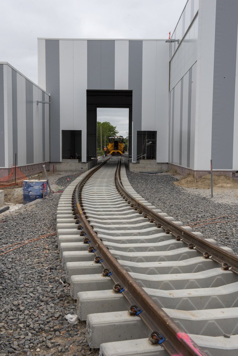

I know it's just the yard but...wooden ties? Are they serious? If Waterloo region can get concrete ties in their yard, why can't the crosstown?
I saw a while back that the only wooden sections are switches, presumably due to it being easier for modifications. My understanding is that the rest will thankfully be concrete.

Here's a #CrosstownLRT fact to start off your Monday - #DYK there will be approx. 8.5km of track laid at the Eglinton Maintenance and Storage Facility at Mt. Dennis? The progress is unbelievable and some parts of the track are even live already!
