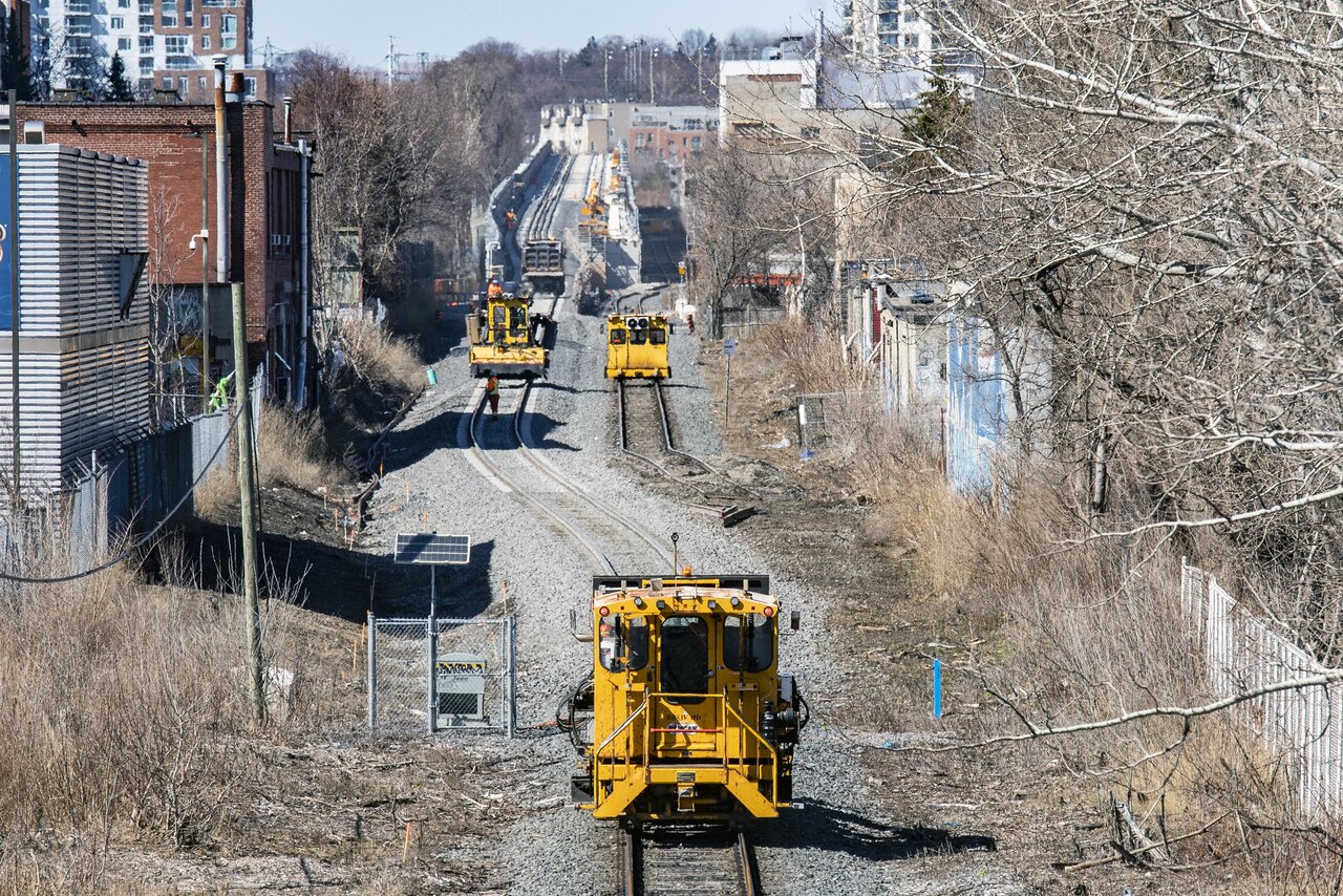

An update photo, taken today, Sunday (April 2).
Pardon my ignorance, but is emergency egress and evacuation simply a long walk or are there emergency exit/fire-EMS access points? That crew looks to be working on a hatch or opeing, but it looks like it will be right where the second track will eventually go (maybe it's perspective and it falls between them.
Why not build in switches from the get-go and make the transition pictured here a potential crossover track in the future? Doing that now would have avoided having to temporarily close the tracks in the future to complete the double tracking in this area.

The corridor will have to be upgraded to 2 track at a later date once the Bloor Station is built, the 2nd track bridge in place but most of all, the 2nd track for the whole line. Having a switch install now will require block signals tie into dispatch centre at a unnecessary cost when the current line is single track in the first place. I expect switches and block signals will be around Lansdowne and leave it to other in the know as to location.
The thought of having a switch tie into the old track and new track will not fly for CP as it offer a chance of disrupt to its mainline service as well having an impact on GO service as in the past. Its not one switch, but 2 using the old line.
Extra cost with no increase to service is not good use of money.
It’s always difficult to judge from long-lens shots, but to my eye the new track is not in its final alignment, and may be shifted further once the full width of the ramp is completed. Adding switches now might only complicate the task, and if crossovers are not required at this location for the longer term - why bother? Switches wear faster than straight rail, so there’s added wear and tear and added maintenance.
