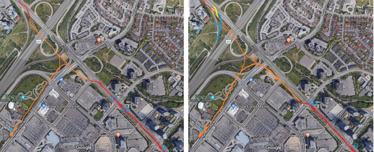

I'm pretty sure that this is what the Province intends to do:
If the northbound Robert Speck stop platform remains on the south side of the intersection like the existing 103 stop, there ought to be enough clearance for the guideway to elevate into the T intersection as depicted. I didn't draw the through-section for clarity but this should work.
Your Robert Speck North stop would be at-grade. This leave you only 150m (190m minus a platform length) to Square One Drive.I think this is what Drum was suggesting is not enough to elevate in.
Your diagram doesn't quite match what Metrolinx had on their site.
The line at Sq One will move from the center to the side at this time where I have noted. To do what you want would require another set of lights for the southbound lanes.
Without drawings, it's hard to describe. I imagine my option would have similar traffic signal requirements - but located at Robert Speck and not Square One Drive. (I also eliminate a traffic signal completely at Square One Drive).
Here a previous post diagram. https://urbantoronto.ca/forum/attachments/c4ecaedd-4e21-4954-8767-3752474da229-png.182852/
Based on this, I see the proposal that (going south to north), the line switches to the West side within the Square One Drive Intersection. For both NB and SB LRT movements, crossing arms would go down (green) on Square One Drive and on the ramp from Hurontario to Sq. One Dr (I don't think you can trust traffic turning right on red without the arms). (it doesn't really matter where the Robert Speck stop is located). From here, it elevates over the Centre View ramp, the 403 ramps, and 403 itself. The famous Y is located here. It then moves back to the median at the traffic lights on the north side of 403 for the off-ramps. The LRT can access this when the signals are green for the 403 off-ramp traffic. It requires the stop line for the SB Hurontario traffic to be moved north a bit.
On the right, I show an option. Move the transition to the west down to Robert Speck. The stop line for SB Hurontario would have to move north a bit. It could then elevate about Sq. One Dr. and Rathburn, and essentially follow the same path. [I showed an option of making the SB 403 on-ramp more of a 90 degree ramp - but I don't think it really accomplishes anything, so I would keep it as described above (and in yellow)].
Your first plan is close to what I have seen without the Robert Speck stop
Couldn't my conception work if both the NB and SB platforms of Robert Speck Stn were on the south side of the intersection then? There's many creative ways that this could work. Remember Square One Dr already dead ends at Hurontario St so it's possible to angle the curve at which the elevation begins in such a way as not to disrupt traffic (perhaps prohibit anything over 3 metres like trucks from using that section of Hurontario to allow for enough clearance).
It all depends on how important it is to no block Square One Drive. That question goes for my route as well. Every intersection to the south , all the way to the lake, has LRT blocking the intersection.
Why is this Square One Drive so special?
Another question is how much worse is it for traffic to have the LRT switch from centre of road to side of road at an intersection?
An unrelated question is why they are doing so much here to avoid interfering with the highway ramps, but they are doing nothing for the Eglinton LRT and DVP, and nothing for the LWLRT and 400? I suspect those had major complaints from traffic engineers at the time, but the political forces shut them down.
