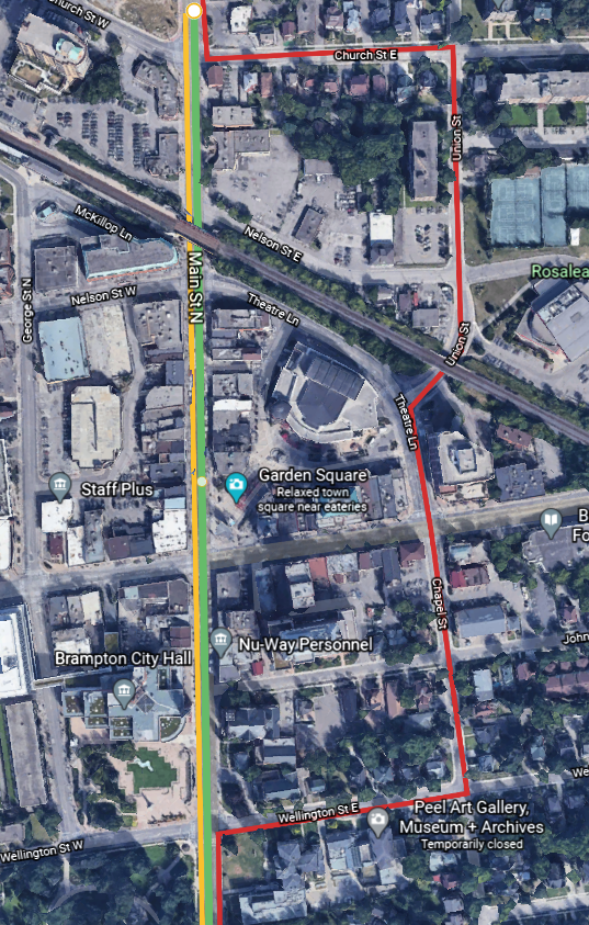

Tunnel is far from the only way of solving that problem. Make a pair of 1 lane, 1 way roads. I think northbound could go a block to the east (there is even another rail underpass). Adding a slight detour for cars is not at all a problem.
For clarity, put the LRT on the east side of Main between Wellington and Church, widen the sidewalks and reduce Main to 1 lane southbound only, with some sidewalk cut-outs for loading zones. Maybe pedestrianize this stretch altogether and eliminate curbs. For northbound traffic, direct it east on Wellington, and north on Chapel St. Rebuild Theatre Ln & Union St T-intersection to give priority to northbound traffic. Northbound lanes resume on Main north of Church St.
Yellow = southbound 1 lane general traffic
Green = LRT (buses can also use these lanes)
Red = northbound detour

No, this doesn't loop the LRT. It reduces car lanes and keeps the LRT on Main, moving car traffic to another street.

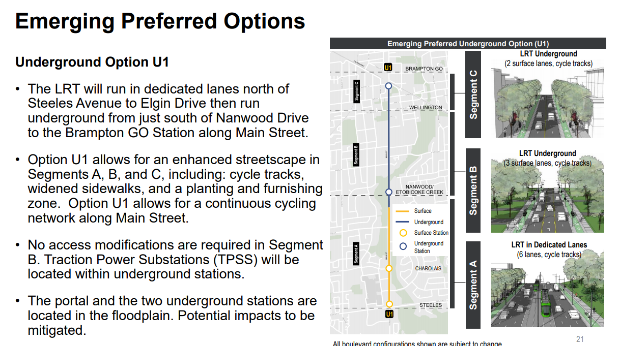

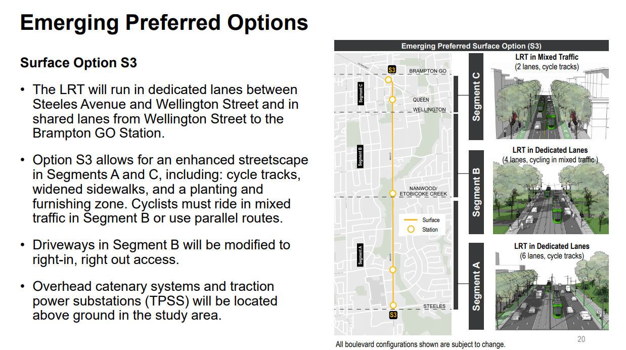

Preferred surface option:
Preferred tunnel option:

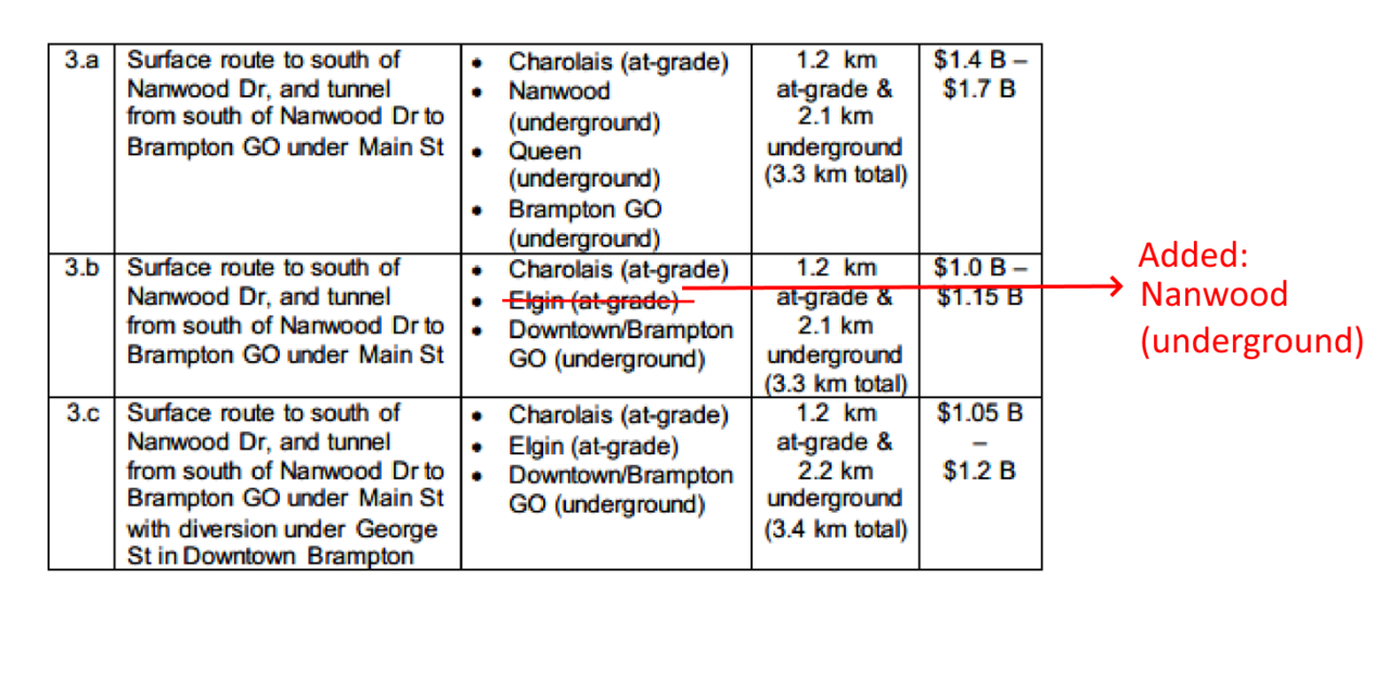

The surface loop option has been dropped. The preferred tunnel option does not include an at-grade stop at Elgin, but does include an underground stop at Nanwood.

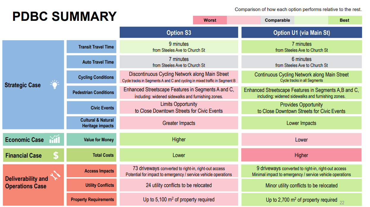

Summary:
A revised cost isn't provided but based on the May 2019 information with the various options, so some guesswork might be required based on the other options.
Summary:
