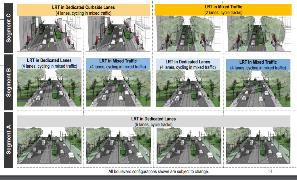

Preferred surface option:
This is almost right.
Just, for section C, eliminate the cycle tracks, make Main one way south only, speed limited to 30 kph (slap in some speed tables/midblock pedestrian crossings for good measure to ensure low speed), shared use with cyclists (with a contraflow cycle lane). Leave the LRT in a dedicated right of way. Northbound car traffic detours.
And section B: get your heads out of your butts and put a MUP on one side for bi-directional cycling + pedestrians. The west side in particular has essentially nothing within 4m of the road that would stop you from putting in a MUP, other than some nice old trees. Sorry, people deserve safe cycling infrastructure more than rich people deserve some old trees. Plant some new ones.
They have mixed-traffic LRT operations in Greater Manchester, in sections where the road width is the same as Main Street. The Hurontario LRT will be fine with this, especially as the mixed-section is now shorter than before (previous EA had mixed-operations from Nanwood, not Wellington).
The cycle tracks are a key part of the Downtown Reimagined streetscape project, but as I've repeated throughout this TPAP project, they should just close Main Street off to general traffic and create a transit mall. This was the *preferred* option during the first consultation of the streetscape consultation, an option that the city scrapped for whatever reason.
Main Street between Brampton Mall (Etobicoke Creek) and Wellington Street was recently reconfigured to have one through lane in each direction, one bike lane on each side, and a centre turn lane. It works quite well in that configuration because of the common left-turn movements from Main northbound to Harold, Frederick, and Wellington Streets, southbound to Clarence Street, and the occasional left turn into a residential driveway, the Ward funeral home, and St. Mary's Church/School.
As long as LRT vehicles don't stop between Etobicoke Creek and Wellington, I could even see this work with mixed traffic and bike lanes.

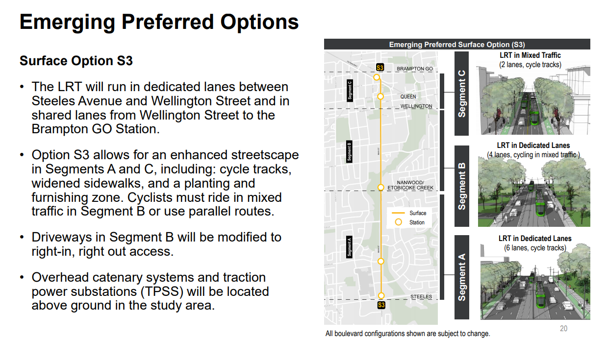

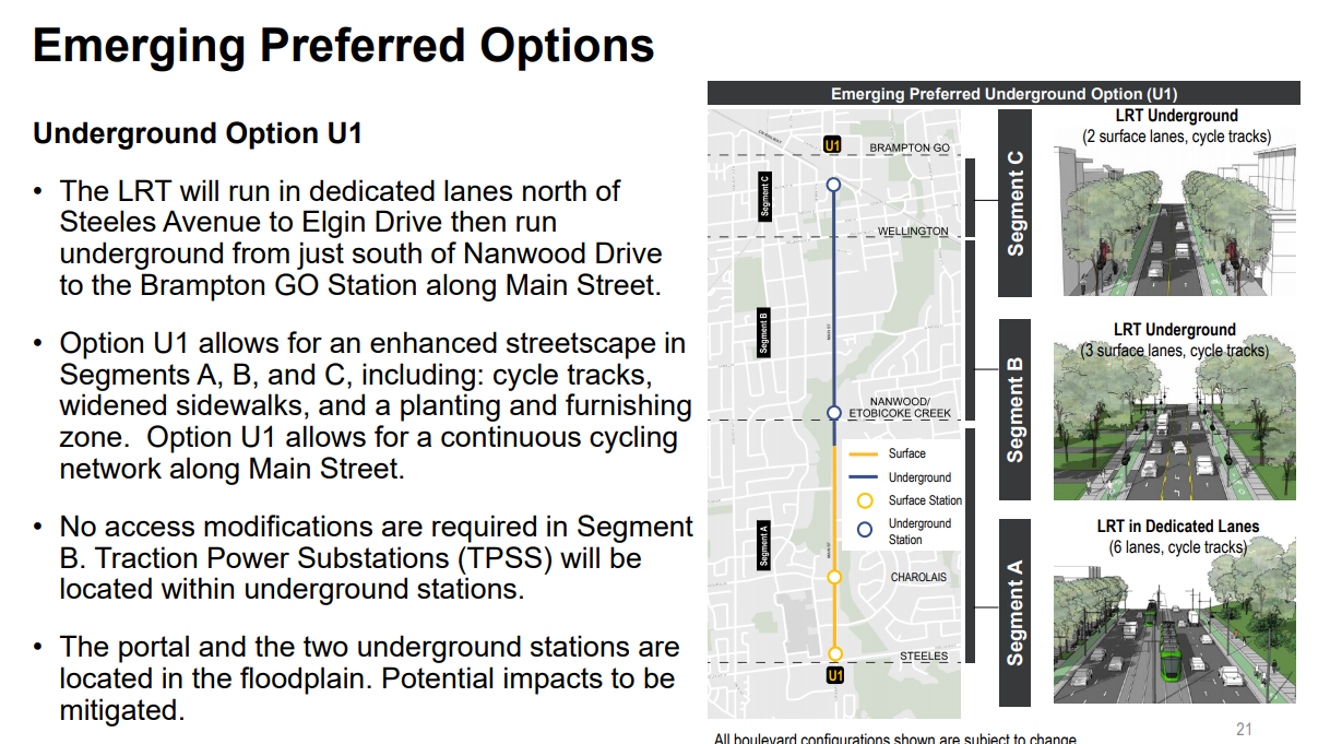

Preferred tunnel option:
The surface loop option has been dropped. The preferred tunnel option does not include an at-grade stop at Elgin, but does include an underground stop at Nanwood.
I'm a bit confused by the preferred options, since the two options that would make the most sense to me weren't even present in the long list of options. These would be either:
  1. Dedicated centre lanes through downtown (either as a transit mall or without the bike lanes)
  2. A tunnel for the ~600 metres from south of Wellington to the GO station
Why isn't dedicated centre lanes an option for the downtown portion? The only options with dedicated LRT lanes shift them from the centre to the curb.

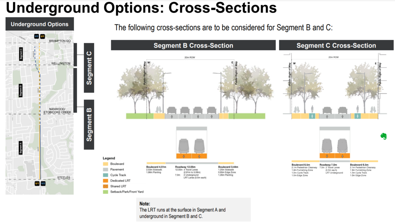

For the underground options, they compare different surface cross sections and they compare a George street alignment (not sure why they bother considering it performs worse in absolutely every metric) but they don't compare portal locations.
There might be a valid reason for this (gradient, portal location, avoiding building a new bridge over Etobicoke creek, water table, etc.) but I find it strange that the only underground options all start from south of Nanwood:
  • It tunnels for an extra 1.25 km through an area with plenty of RoW and generous setbacks
  • The portal and Nanwood stop are both located in a flood plain

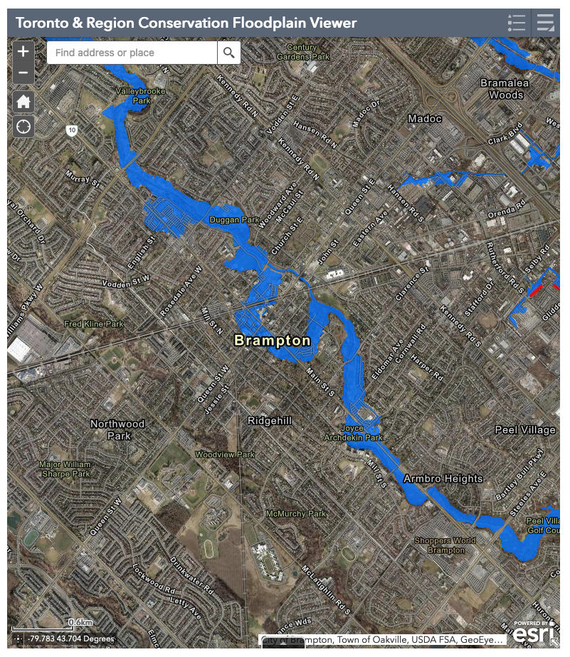

Talking about "flood plain"...
From link.
From link.
Thanks for sharing.
Interesting how all of downtown Brampton is a "flood plain" but not the park space directly bordering Etobicoke creek (Meadowland Park, Centennial Park). From this map it looks like instead of Main street the Hurontario LRT might as well be extended along Etobicoke creek for the same "floodplain" impact.
There's a (split) stop at Wellington/Queen Street in the Downtown portion. There's no room in the road right-of-way to accommodate four lanes + a centre/side platform. Putting the LRT on the sides allows you to use the sidewalk for that purpose without turning into a TTC streetcar stop (which does stop traffic).
Thanks for sharing.
When the previous Brampton council debated the Main Street portion, a certain anti-Main group proposed putting it in an elevated guideway along the creek. The TRCA shut that option down pretty hard.
