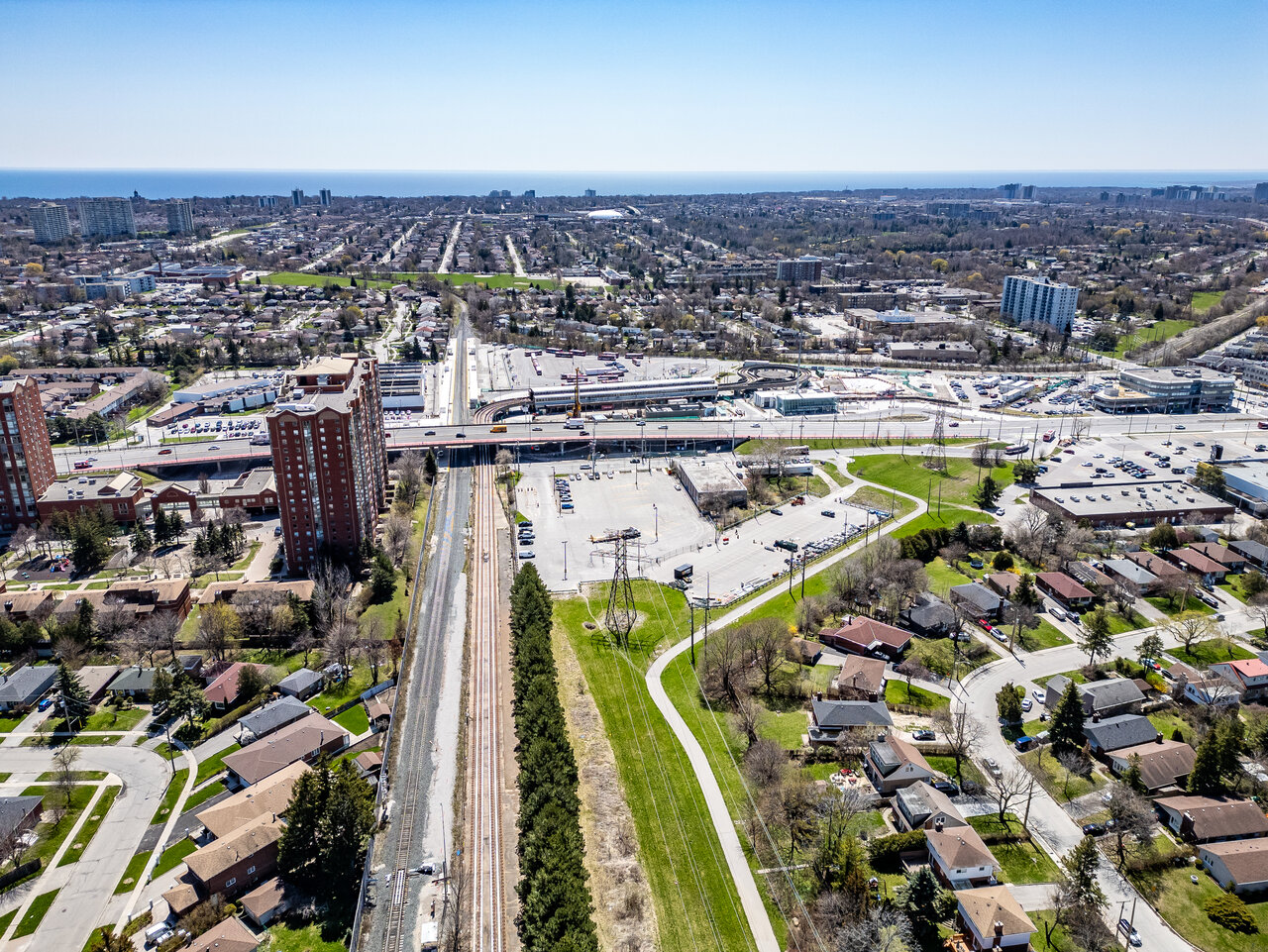

On the substance, Alex doesn't outline the amount of parking to be provided, but he does say it will occupy 3 full floors; that's going to be several hundred spaces for a development that's right at a Transit Hub with a subway, an LRT, great bus connections, and a supermarket literally adjacent to this proposal.

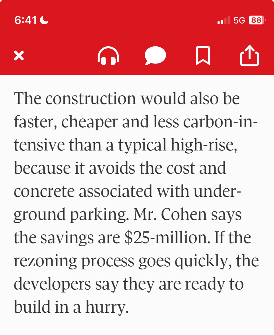

Irrespective of whether parking goes above ground or below, savings could be booked by providing a whole lot less of it.
If it's well camouflaged above ground, I can live w/that; but my 1st choice would be zero parking, and 2nd would be a single-level of parking, underground.
The podium could be put to better use as a considerably enlarged community centre, or a new home for the Kennedy-Eglinton Library which is just to the other side of Kennedy in a moribund strip plaza and is distinctly undersized.
This paragraph needs discussing:

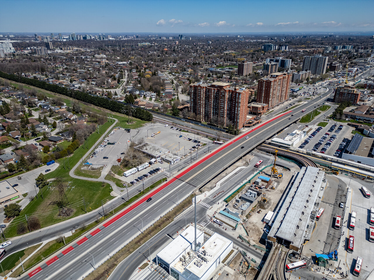

Whatever money may be saved by placing parking above ground, could be lost by having to construct a small mountain to link the hydro corridor landscape to the building; that is not a cheap undertaking at all.
Without seeing a site plan, I can't be sure, but it also strikes me that it could be quite a steep ramp, given that Hydro will not let them start raising the grade materially under their wires.
With great respect to CCxA of whose work I have generally been very fond, I am not sold on this concept; I think it reads and very maintenance intensive for a start. Parks does not have money lying around for a large horticultural commitment; they can't maintain what they have now properly.
I think something closer to the Meadoway concept, which is meant to be relatively low maintenance in the longer term is probably a better way to go, with CCxA integrating attractive and useful elements such as upgraded path, seating, drinking fountains, and possibly a thoughtful community garden as well.

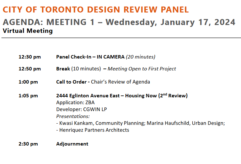

As I noted this is before the DRP today.
The recording link is here:
Planning is asking for comment as per the below:
Gregory Henriquez spoke for the proponents. Below are slides from his presentation:

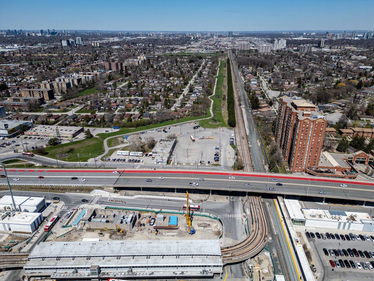

This next one addresses a concept we heard about of ramping up the Hydro Corridor landscape to meet the top of the podium for these buildings.
I will note that the concept requires a portion of the adjacent private property.......... as well as modifying the hydro corridor.
I'll pause here to note that Gregory mentions in passing that they had a meeting with Hydro One this morning and apparently got an enthusiastic response.
While I'm encouraged by that, it also means they don't in fact have a done deal with Hydro One...........so that may pose a challenge to schedule, we shall see.
