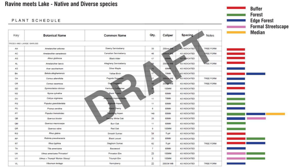

A couple of notes and images from the above-linked presentation:
This is only the trees and large shrubs, many other plants listed separately.
I have serious complaints about the third one down, marked AG. This tree is the European Alder, and is a non-native invasive
Black Locust marked as RP is also a non-native invasive.
The rest of the list is pretty decent..........even if someone didn't spell everything correctly on it......
I am curious about the choice of Yellow Birch mind you. That species tends to like its feet damp. The rest of the species on this list don't really go with it.

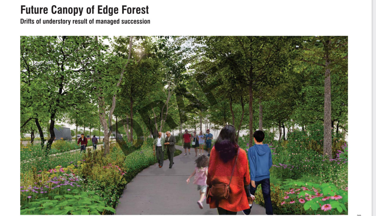

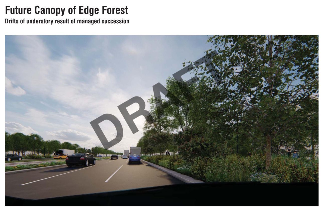

They are clearly envisioning a pseudo-natural landscape in some of the boulevard areas:

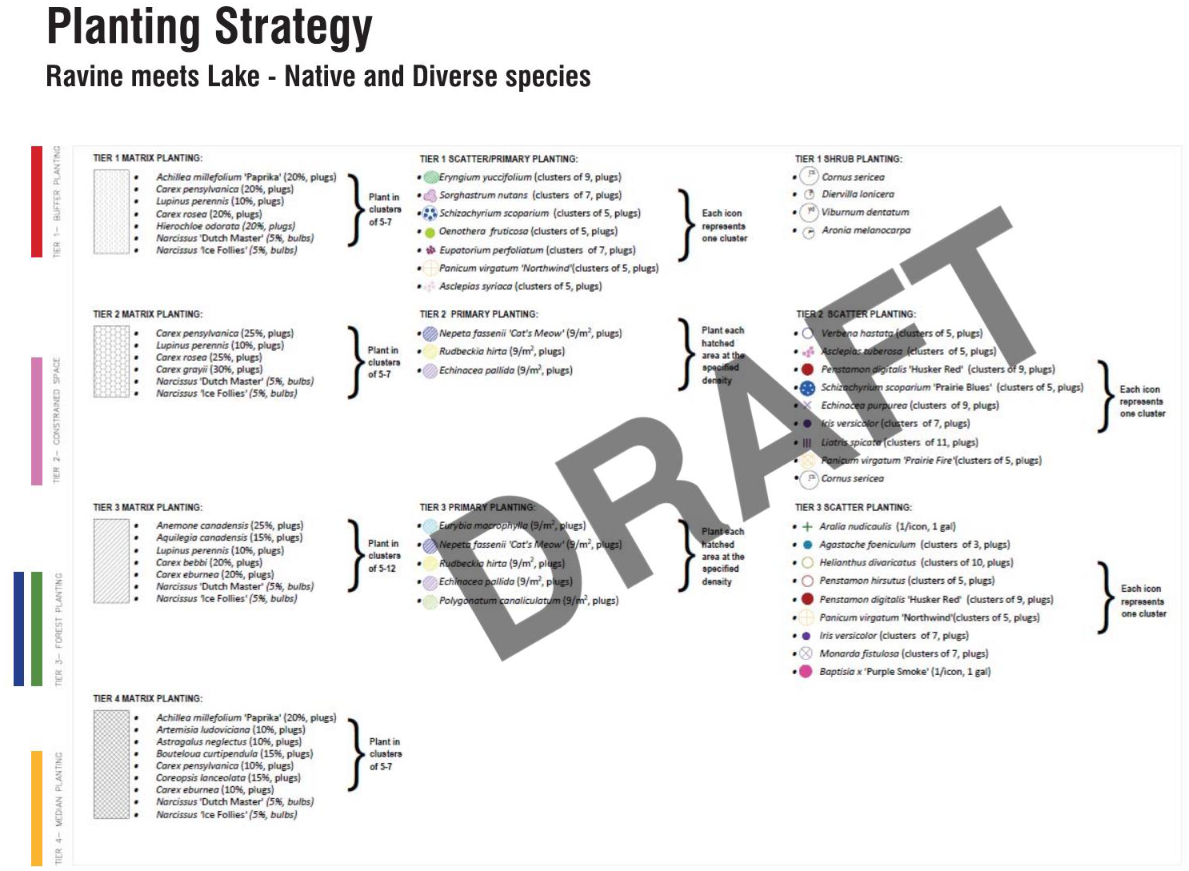

Rest of the plant list here: I need to read this more and will comment shortly.

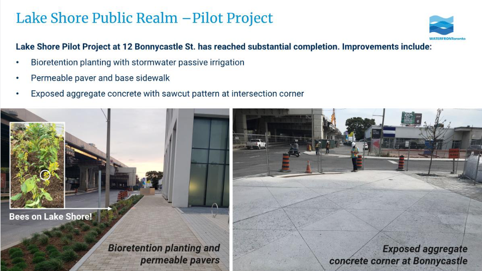

A couple of pictures of the test plot on Lakeshore @ Bonnycastle.

So, I've had a chance to review the smaller shrubs and wildflowers proposed.
Nothing is egregious.
Though lots are cultivars (not true natives) and a few are a tad....ummm..........goofy.
But....overall, on balance...none I would make a big fuss about; given that these are alternatives to plain, ordinary sod.
There are actually some very good plants in the mix from Bee Balm to Wild Columbine.
But the 2 non-native, invasive tree species really need to go.
And I'm really challenged to see how Yellow Birch will work.

I wonder why black locust is chosen. I have a managed forest east of Toronto that has been planted for habitat restoration for 36 years. Upon the advice of the local conservation authority several non-natives have been planted over the years. One species that I regret planting is black locust as it spreads like crazy. I don't even want to mention some of the other non-natives that were planted over the years that are invasive and don't support native fauna well at all. And, much thanks to Northern Light; overall he is quite right in his assessments.
