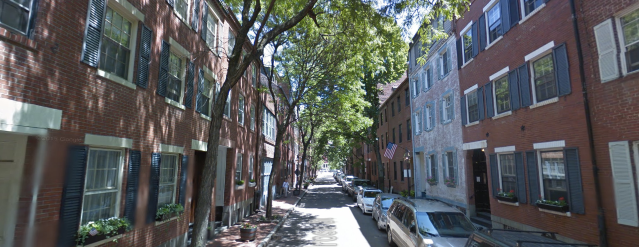

I think you need to find me examples we can discuss. Don't get me wrong, there are attractive mews and such...........but, well, lets take this 6M wide street in Boston:
Source: https://amateurplanner.blogspot.com/2016/02/there-has-been-lot-of-discussion-in.html
The sidewalks are not accessible to those with mobility aids /wheelchairs / strollers. Its too narrow.
There are no trees, and none will grow here, but even if they could, there wouldn't be a road at all anymore.
Toronto Fire would definitely balk.
Is it cute, sure, though I like my trees, but to be clear there are some very real tradeoffs.
From the same site as above:
ROW has trees, works for me....but, but.....
First, you have a 3-4s street wall and the ROW has now stretched to 11M wide. But notice the sidewalk with trees is again impassable to anyone with a stroller/wheelchair etc. They would have to walk in the street. Now imagine snowbanks.
I was in Beacon Hill recently, so I was amused that you happened to choose a few examples from there. Indeed - in a lot of cities with intact, circa 1700-era neighbourhoods (Boston, Philadelphia are the two I'm familiar with) you'll get narrow streets, narrow sidewalks and 2-3 storey high streetwalls. Trees are a rarity because they just can't grow without encroaching onto the roads or into the foundations of houses themselves.

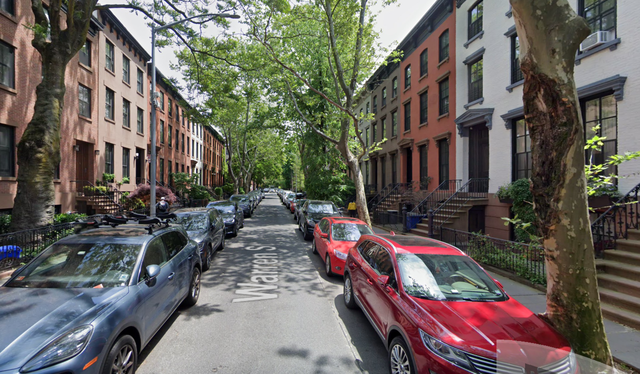

That said, I think you could look at neighbourhoods in Brooklyn
I think I measured the road as ~7m. The sidewalks are wide enough for trees and strollers. I don't know about accessibility devices. Basically all of Brooklyn Heights, Boerum Hill, Cobble Hill etc. look like this. 3 storey streetwalls are the norm, and I believe (don't quote me on this) - but 4 storeys are allowed on redevelopments in anything that isn't heritage.

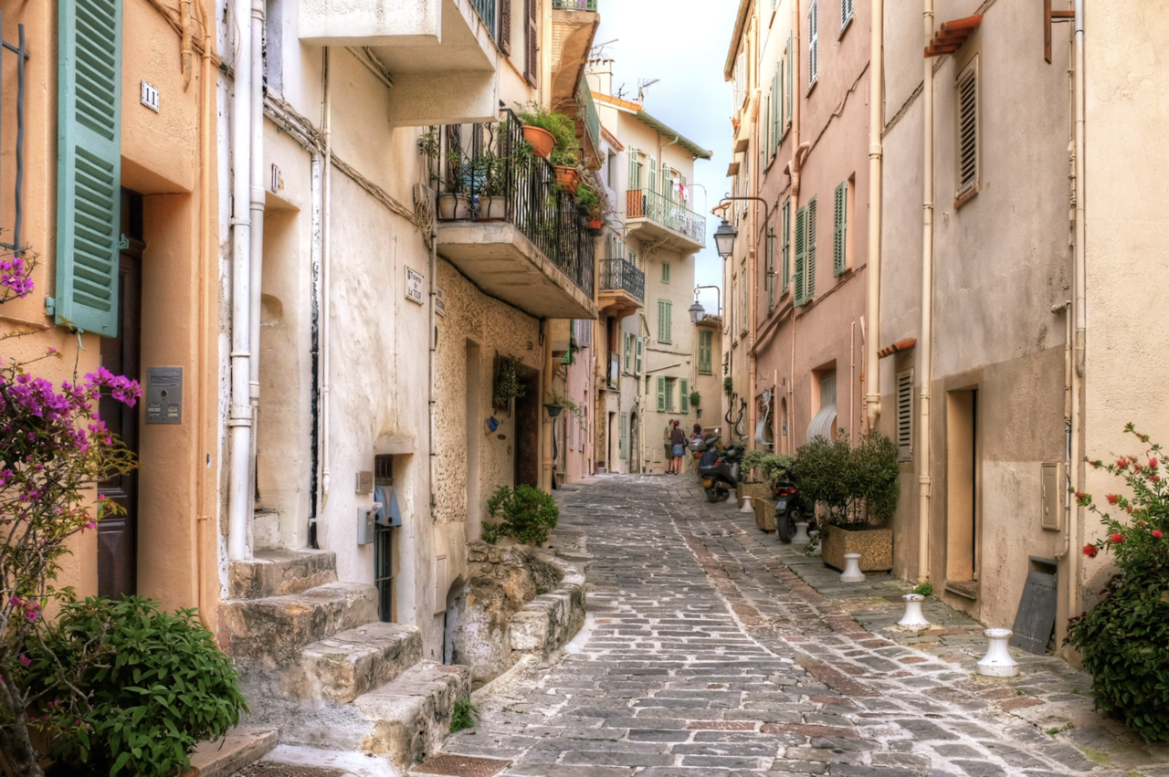

Cannes is another good example. Tall building walls. Not a car in sight. Villiers should have the density of Cannes. Otherwise, boom... future St. James Town.

Cannes France is another good example. Tall building walls. Not a car in sight. Villiers should have the density of Cannes. Otherwise, boom... future St. James Town.
Pretty photo, no trees, the uneven paving would not meet accessiblity standards, also, what 'tall' street walls, these do not exceed 4s. Where I've had issues w/people advocating tall street walls they've been advocating for greater than 4s, which is my recommended limit. (not overall building height limit, just street wall)
Great pic, though lets let others see it w/o the click:
First, on the ROW, building face to building face, its 18M (16M from fence to fence).
Second, Curb to Curb, roadway is 9M.
Third, I take no issue w/streetwalls this height, 3.5s; everything in Villiers is already this tall (proposed), others are arguing for much taller streetwalls than these. I'm find w/streetwalls up to 3s on mews and 4s facing streets.

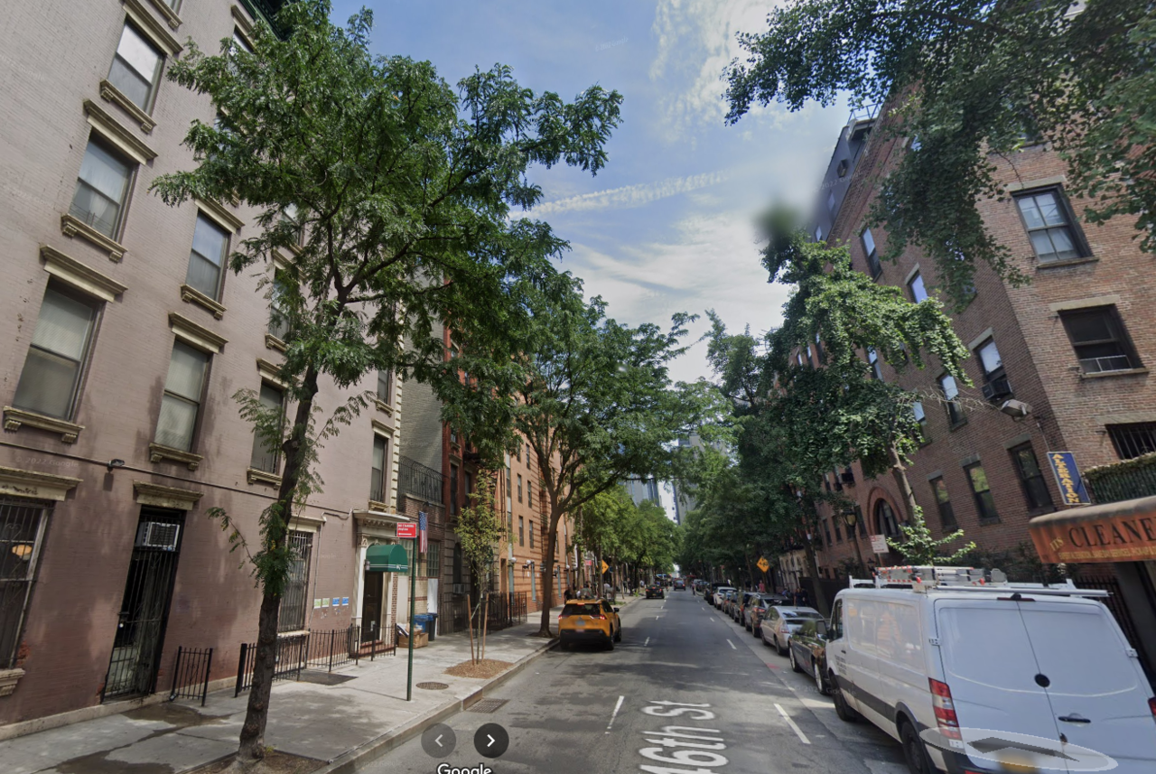

So Perry Street, overhead view first:
Ok.....can we talk about the absence of towers here and how this is much lower density than Villiers?
ROW (building face to face) is ~14M
Curb to Curb is 7.5M for the most part.
Now for Streetview:
Hmm, that looks like its working super well........ lots of cars, truck parked on the sidewalk blocking that accessible width..... insufficient space for a fire truck......

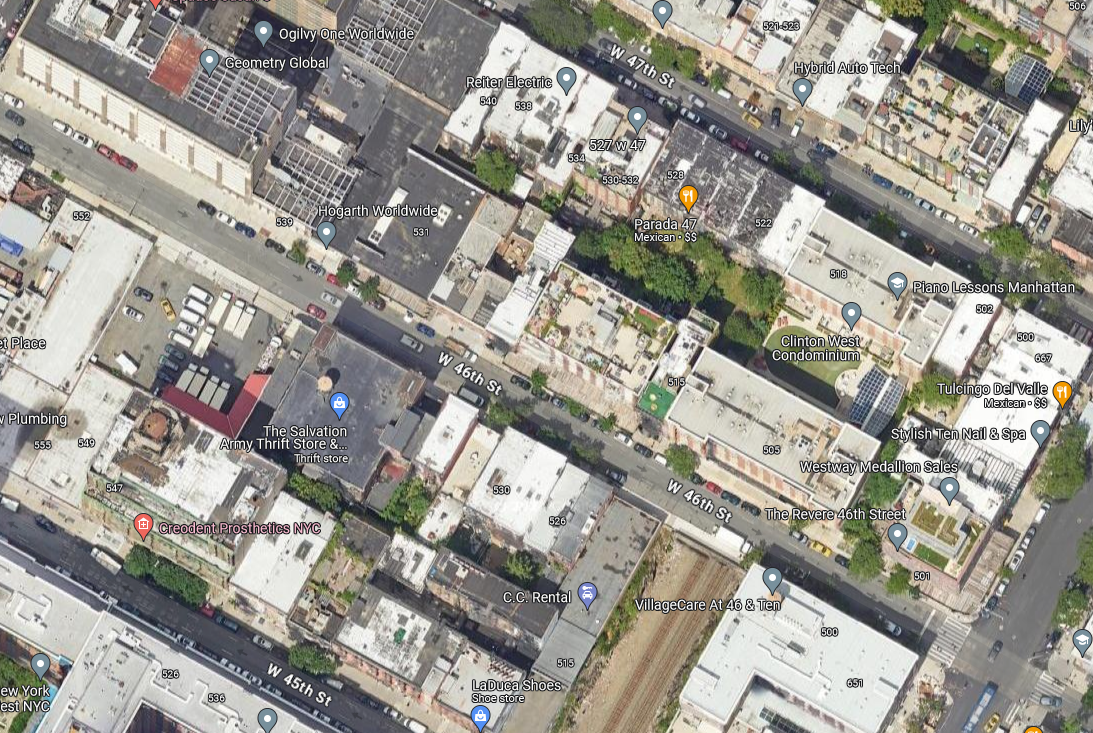

Lets bring this one forward too:
Aerial first:
ROW: ~17M
Roadway: ~7M
Observations: Zero Towers; less dense than Villiers, lots of on-street parking, no cycling facilities, sidewalks do not meet accessibility standards due to trees and encroachments.
I looked up the population density of Hell's Kitchen as a whole. Its 103,000 per mile2 which is 39000 per km2.
Villiers is proposed to be 59,000 per km2, or 50% denser than Hell's kitchen.
I think people keep confusing feelings and anecdotes with math....
We can build Villiers similar to this, but we will have to cut the density by 1/3 and eliminate bike lanes, and build a subway.

The previous picture in West Village has small apartment buildings. The WV has a mix of small apartment buildings and row homes depending on which street you’re on. I haven’t done the density calculations.
NYC buildings aren’t burning down left, right and center, so maybe it’s not as big an issue as you imagine? Also, FDNY is pretty aggressive: if you’re in the way they WILL destroy your property to get to the fire. Finally, anecdotally, NYC has a different approach to fire houses than Toronto does: a lot more dispersed, smaller houses, so a single fire call scrambles units from 3,4 or 5 stations that all take different routes.
Out of curiosity, how do you know it doesn’t meet accessibility requirements? Also, Hells Kitchen has plenty of larger buildings. The NYU Langone hospital, for example is one of them.
Oh, so FDNY will intentionally crash into that truck on the sidewalk and potentially injure people walking by............this is not a serious argument.
Accessibility requirement is 2.1M free of any encumbrance. No streetlight poles, no signs, no trees, no stairs, 2.1M of clear, level surface. You can measure that using google via aerial photos.
