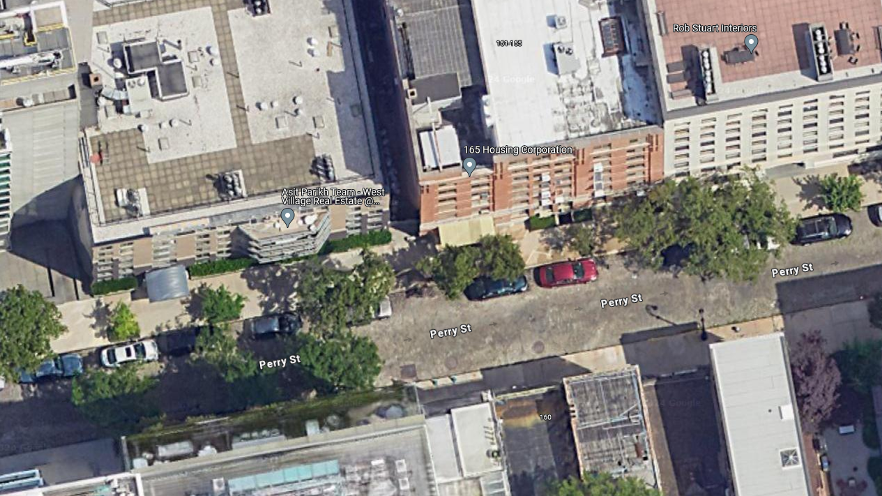

So Perry Street, overhead view first:
Ok.....can we talk about the absence of towers here and how this is much lower density than Villiers?
ROW (building face to face) is ~14M
Curb to Curb is 7.5M for the most part.

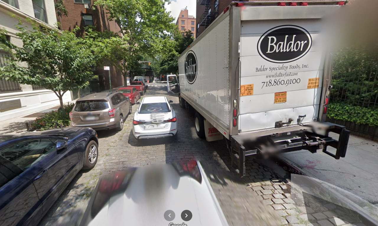

Now for Streetview:
Hmm, that looks like its working super well........ lots of cars, truck parked on the sidewalk blocking that accessible width..... insufficient space for a fire truck......

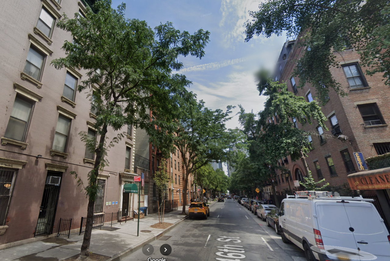

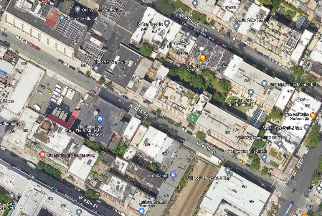

Lets bring this one forward too:
Aerial first:
ROW: ~17M
Roadway: ~7M
Observations: Zero Towers; less dense than Villiers, lots of on-street parking, no cycling facilities, sidewalks do not meet accessibility standards due to trees and encroachments.

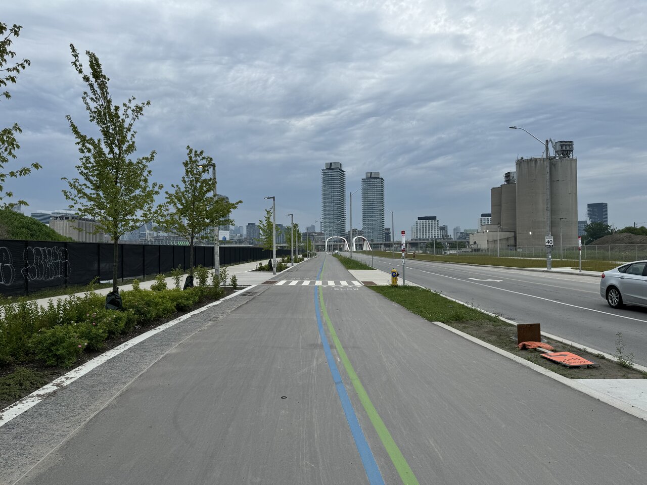

This one pic caught my attention.........ahem, bus shelters. I'm sure they are in the plans, but the road and trail are open, and there is no other shelter available (under a building canopy etc.) in the area.
