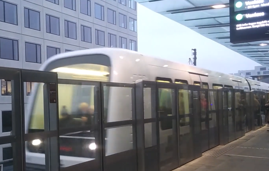

The platform doors have to stay in order for the design to work. The Metrolinx people have been citing Copenhagen, where PSDs are a major element of meeting a reliable 120 second headway time. It's going to be a very small part of the overall expense of building some of these stations.
That said, we are likely to see variance in the PSDs themselves from one station to the next.... for example, you don't need full-height doors outside. Copenhagen:
I wouldn't be surprised if we saw something similar to this in Overlea, and maybe even Exhibition.
The largest benefit of PSDs is a capital cost reduction by being able to install platform edge pillars to support structures above it. No super long horizontal spans. Side benefits or detriments won't even factor into the equation against the ~$30M per station savings. Ontario Line is quite cost conscious; platform screen doors would be installed even if they regularly cause service issues requiring maintenance staff on platforms (see Ottawa LRT).
