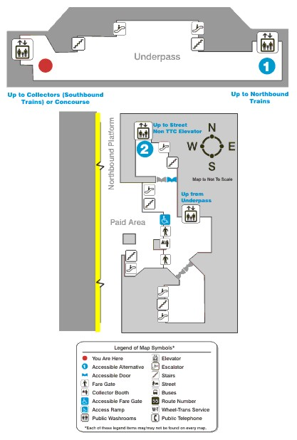

There are 2 connecting paths from the NB side to the SB side of Queen Stn.
One is inside the fare paid area, one is outside the fare paid area.
Both partially encroach on what would be platform space of any Queen subway.
They are side platforms.
There is some additional space beyond the locked doors but not a ton (given space for tracks).
The video I've linked above is with formed TTC CEO Andy Byford and Brad Ross and includes a section shot in Queen Lower; that begins at approx. the 2:55 mark.
This diagram shows how placement of the elevators at Queen , which don't encroach on prospective platform area; but the access corridors to them do.
The above is from: https://www.ttc.ca/Subway/Stations/Queen/Accessible_Alternative.jsp
Steve Munro concurs this will be a challenge.
He will have more to say on his blog later today.

Steve Munro's comments are up on his blog.
His comments as they pertain to Queen Station:
Metrolinx says that this station will “make use of an underground cavern below Queen Street, built during construction of the first section of the Yonge Street subway”. In fact, that cavern is not very long, and is already occupied by assorted machinery in the portion that is not already used as an underpass between the northbound and southbound platforms.
There is also the matter of the capacity of vertical access between this area and the station above given the amount of transfer traffic likely at this location.
I have asked Metrolinx for clarification of the vertical arrangement at Queen Station.
