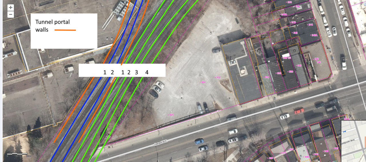

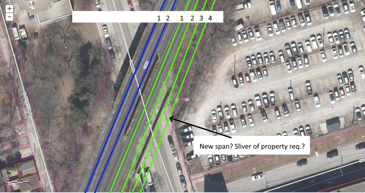

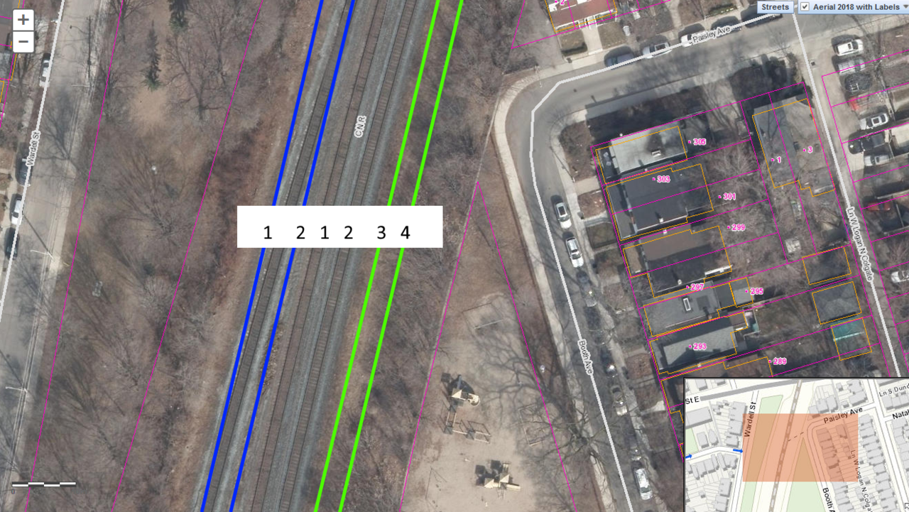

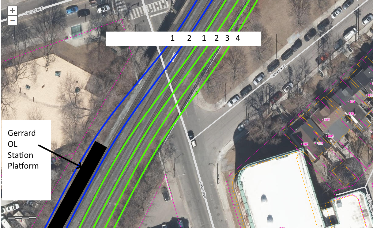

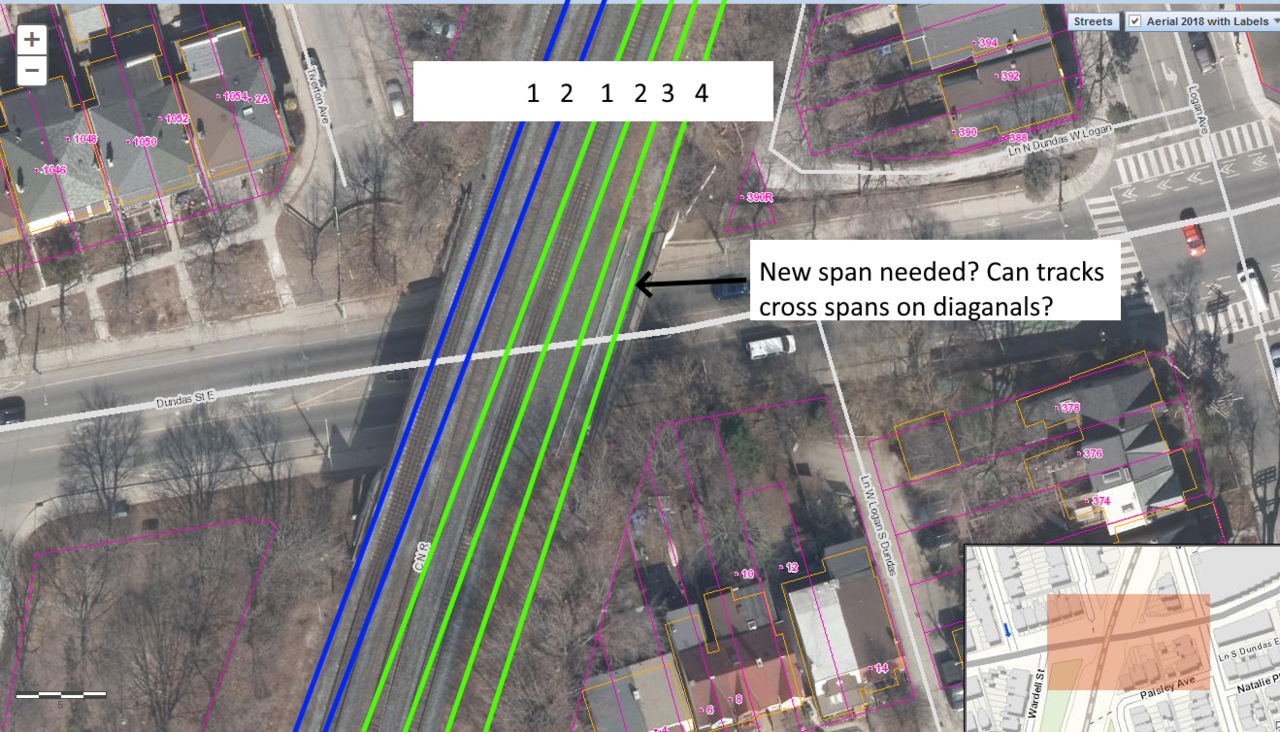

I could be completely wrong, but is it possible they may replace two GO* tracks on the west/north for OL, and add two GO tracks to the east/south? Just don't know if there has to be a certain clearances between the OL and GO tracks. Just wanted to visualize some options. Not a civil engineer and haven't measured this, and not aware of the requirements. So it's just for general discussion purposes. The below images also don't take into consideration the clearance requirements for the OCS poles for OL or GO, and any noise walls proposed. Speaking of noise walls, Metrolinx blog post on it today.
* and VIA, but for simplicity of the images below I'm just saying GO.
Given what appears to be the property lines from Toronto Maps v2, I wonder if this shows why Metrolinx is saying that they can generally accommodate the 2 OL tracks and the 4 GO tracks within their ROW. I believe they've been saying that but stand to be corrected. Using v2 is helpful because it shows property lines. I realize the images below don't perfectly align with the track location ideas but the property lines disappear on v2 if you Zoom out beyond this view.
OL - blue lines (surface OL in the Metrolinx maps is pink, but that's the same colour as the property lines)
GO - green lines
Relevant Metrolinx map here: https://www.metrolinxengage.com/en/content/ontario-line-neighbourhood-updates-east
I haven't had time to do the West Don Lands Portal (west of Cherry) to the first image below, but maybe I'll post it later as part 2 of this.
As for the disruption/cost of shifting existing GO tracks, I know it was done for the Georgetown South Project and I believe some work on LSW, and around the Bayview Junction. Any thoughts on how those projects compare to the potential shifts to to the GO tracks in this stretch @crs1026 @smallspy ?
From south to north
South of Queen St E, north of Eastern - option 1:
Option 2 (in case more room is needed between OL and GO. I haven't carried this option all the way through):
South of Queen St E with the OL Leslieville Station Platform:
I realize the Metrolinx map has this station straddling Queen St E. But I wonder if they'll shift it further south so that they don't need to touch the DeGrassi Street ROW.
North of Queen St E:
Further north of Queen St E. There could be some generous space available here because of the former Riverdale platform. Mentioned in this UT article in September 2020 and this Metrolinx blog post.
Again, further north of Queen St E:
North of Dundas St E:
At Logan:
Carlaw:

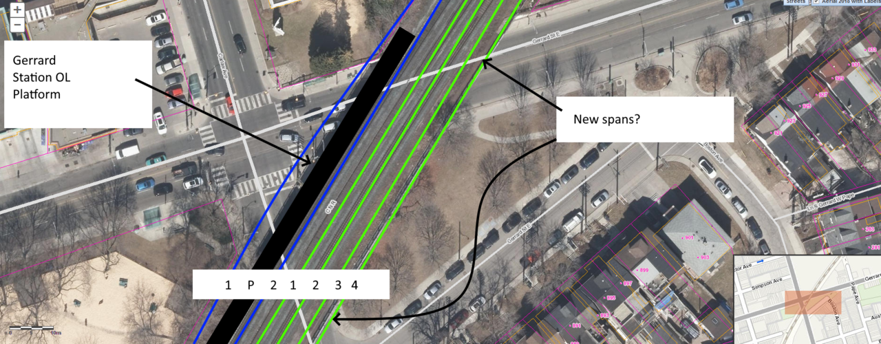

Update: I realize I put Gerrard Station further south than the Metrolinx map so here's another version.
North of Gerrard:
OL heading north into the tunnel:

^ Updated with one more map to correct the location of Gerrard Station. Of course I'm basing this off of Metrolinx's former OL-spanning-GO design, so maybe this OL station would change now it's going to have a centre platform. Also updated to note where Metrolinx shows the Leslieville Stationed compared to where I've shown it.
