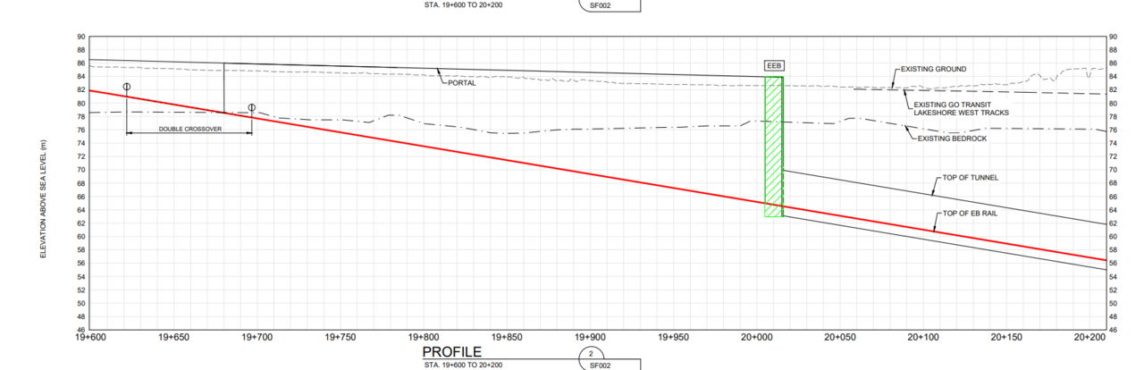

is it me or is that a reallly steep tunnel?
It's not that steep. The horizontal direction has a smaller scale than the vertical direction, so while the profile measures 44 meters from top to bottom, it measures 600 meters from left to right. So, eyeballing it, the tunnel and the rail appear to be about 4 times steeper than they will be in reality.
