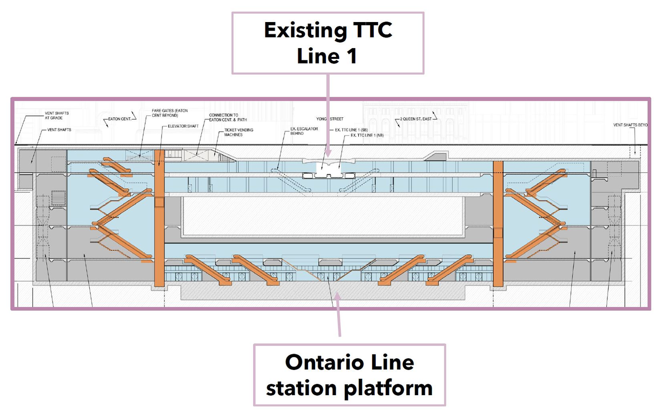

From going through the EA, one thing that I'm not a fan of is they are keeping the deep station design for Queen and Osgoode stations. These are going to be very busy interchange stations and the current plan has passengers going through 4 sets of escalators/stairs to get from Line 1 to the OL and vice versa. They should keep interchange stations as bi-level designs to maximize speed and convenience of transfer from one to the other. This is actually even worse than the transfer from the BD subway at Kennedy to the SRT.
Was there any reason given for this design decision?
Here is the rendering from one of the open houses for Queen Station:

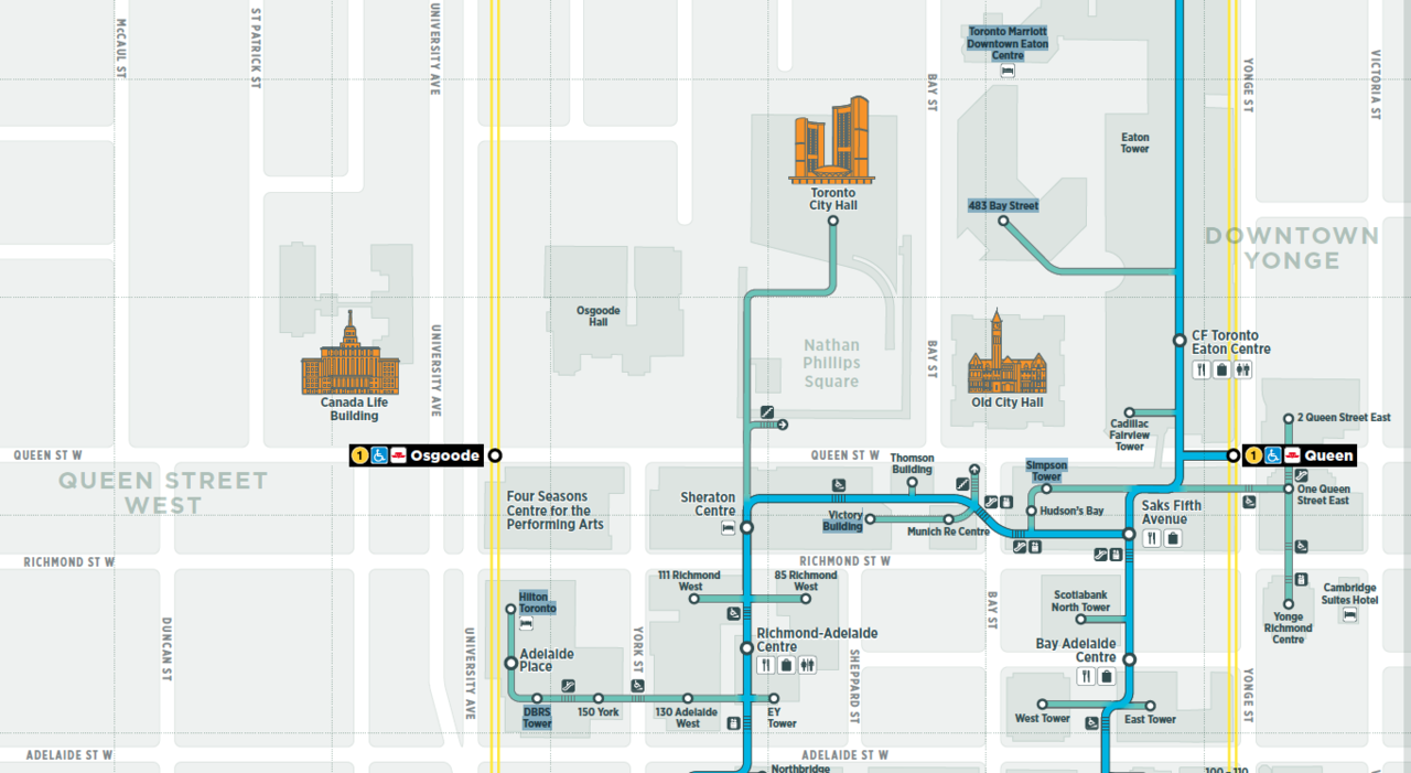

Would people actually be transferring at Queen or Osgoode stations? Wouldn't the blocks around the stations be the final destination for most?
From link.
There should be underground passages that lead to both the Ontario Line and Line 1 stations from the surrounding building. In fact, the PATH could be expanded to include currently unconnected buildings. For example, they could add underground passages to and from St. Michael's Hospital, maybe even bypassing Line 1 and going directly to the Ontario Line stations.
