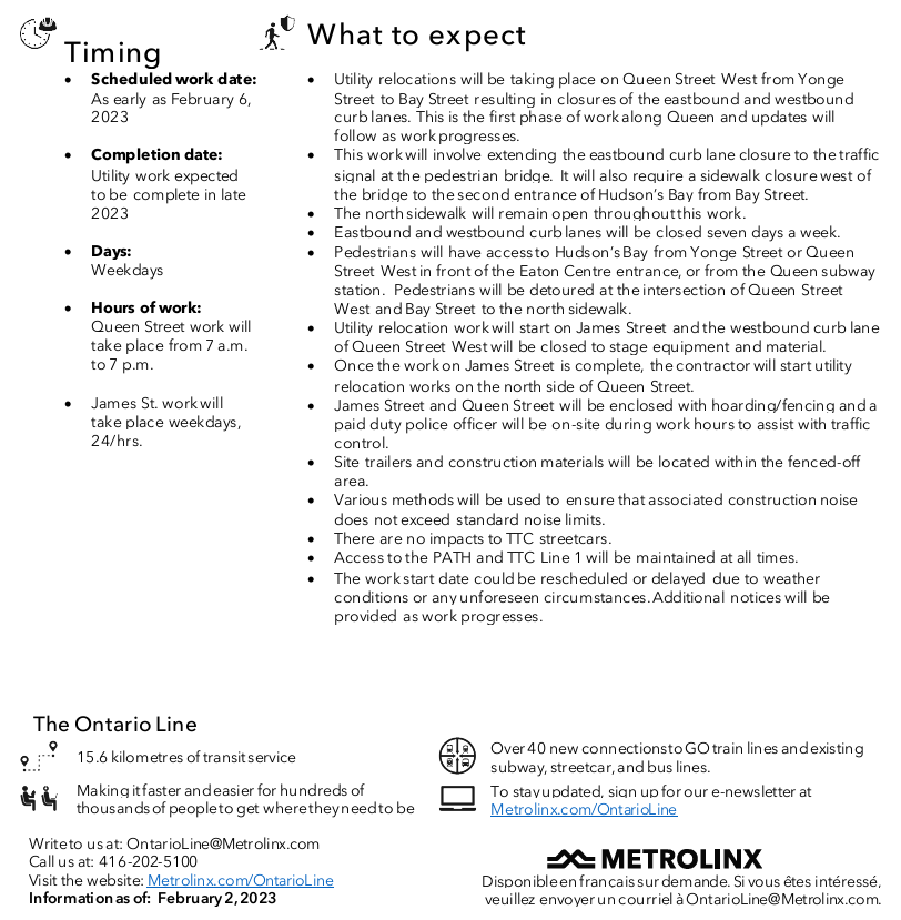

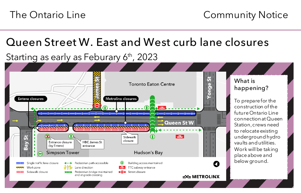

Received this notice below. I was told that the start date for this work is now Monday, February 13, 2023.
