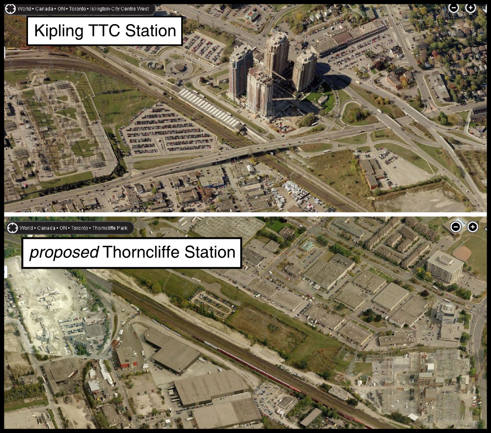

The difference between Kipling station and your version of Thorncliffe Park, is that Kipling is well connected to arterial roads, GO transit, and many TTC bus routes (and eventually Mississauga). It's another example of how high density is not a prerequisite for high ridership. Development here was a no brainer because it's a huge transportation hub, and there's lots of easy surface parking to work with. But Thorncliffe Park station doesn't benefit from any of that. Not only is the land occupied by employment uses instead of surface parking, the location is far removed from the arterial road grid. Any development here will be just as isolated as the apartments of Thorncliffe Park. Fortunately you won't be seeing a whole lot of cranes here anyway. I mean, who the hell want's to live in an industrial park? No development here would actually be better for everyone.
