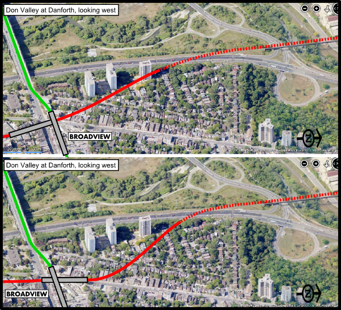

Cool rendering. A couple points:
The sightlines from Riverdale West wouldn’t be that extreme. And a transparent sound barrier built onto a short concrete elevated section of track shouldn’t be all that complicated, costly, or likely to be ‘bait and switched’. Back in Sept/Oct I jumbled together photos of different techniques found worldwide. I’ll make another collage at some other time to give an idea of how the viaduct could look. This piece in Chicago quickly comes to mind for a cheap installation, and the image does a good job of showing an EL hidden amongst trees:

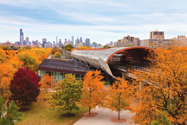

Even if they only used it for a third or so of the total length or excavation of the construction, they still had to use cut-and-cover for a significant proportion of the station. So yeah, I think that it is fair to say that it has been used at every single station thus far, and in the foreseeable future. Unless you know something that we don't, and that they aren't going to be using cut-and-cover to build the stations of the Eglinton Line.

Never planned on it. Whether the DRL crosses the valley underground or above ground - at Queen, at Gerrard, or near Leaside Bridge – there wouldn’t be stations along the crossing point. It should be pretty obvious why. Very few planners would push for nodal development based around stretches of track without a station. Nor would they consider station-less sections of track to be part of a line’s catchment - particularly when in an unbuildable area such as a floodplain, or 60ft underground.

Regarding the commenters denouncing elevated rail; have you ever been to the quadrant of Old Toronto south of the Danorth? Almost the entire Stouffville/Lakeshore East/future-SmrtTrack corridor between the Don River and Woodbine is elevated – at least on one side of the line. Between Pape and the Don the whole thing is most definitely raised up. Sure, it’s not all that high, and it’s an earthen embankment instead of a concrete or steel viaduct. But for all intents and purposes it is very much a man-made raised section of track. And if you support SmrtTrack or RER, then you support ‘surface subways’ running on said elevated track. Not to mention elevated stations at Gerrard, Queen, and Unilever. If we can’t build a short section of viaduct in a park’s periphery in a floodplain, then I think we can rule out the 150m long platforms cantilevered above the street - complete with elevators and flights of stairs. All alongside century-old single family homes that won’t be going anywhere any time soon.
I'm specifically referring to your alignment near Thorncliffe Park, which has the DRL running in the middle of a hydro ROW and adjacent to a CP switching yard. This is a lost opportunity compared to running the line under Overlea. Redway Drive also sandwiched between a rail corridor and a ravine with a hydro station to the northwest. You're not going to see any significant development here.
