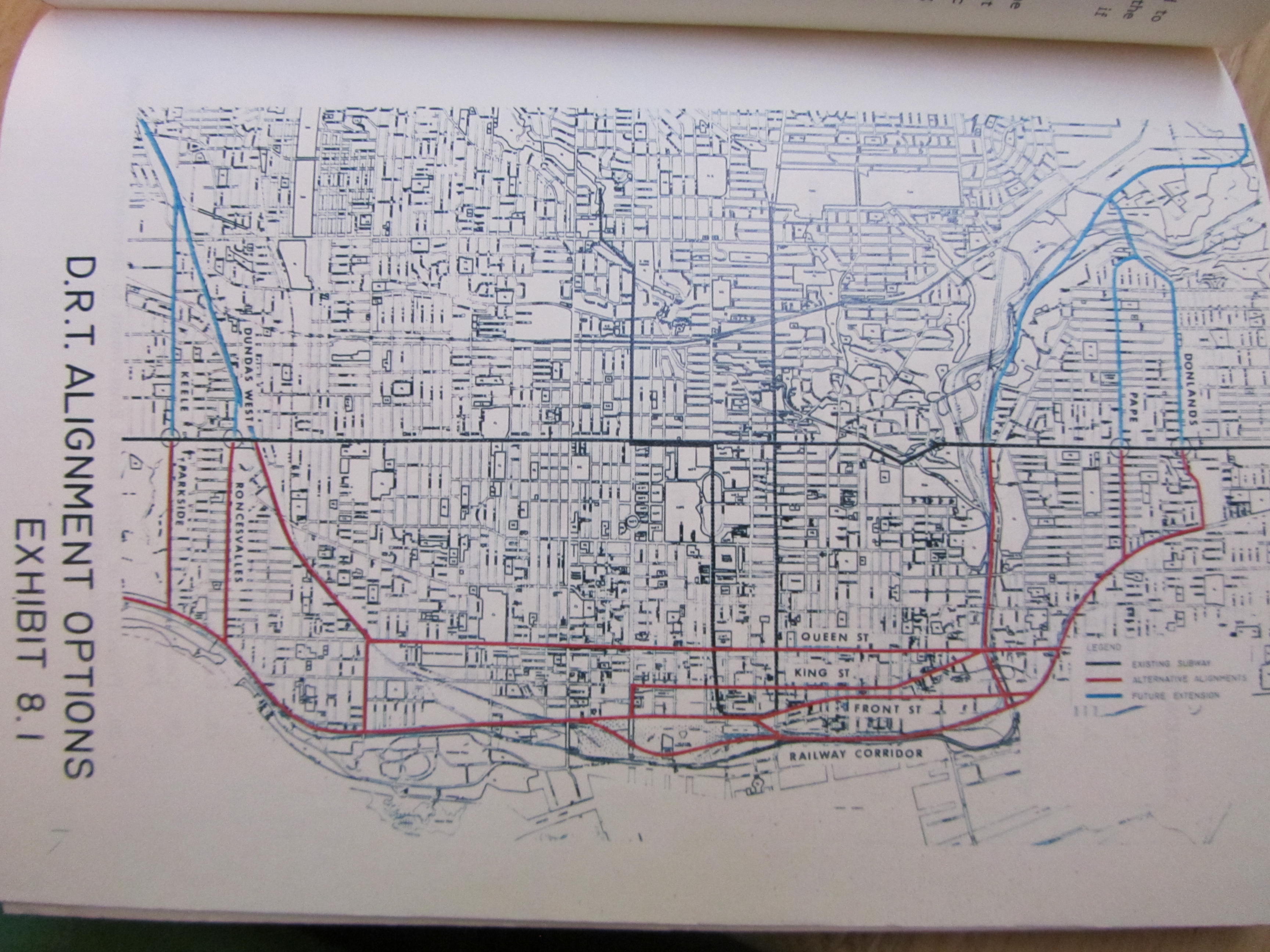

All the more reason the west should be studied. The ridership numbers are no doubt there. Both thirty years ago (and in the last three) the eastern RL had a broader range of corridor options. It was only through proper study that we came to the conclusion of what's most optimal. Unfortunately we never got the chance to do that in the west. So hopefully we plan this thing knowing in advance where (and when) it will be extended, even if the phases turn into generations/lifetimes.
I agree it should be studied, or at least should have been studied. The point is that if a big pot of money fell into our laps for near shovel ready projects, the DRL East could be built up to Seneca because the route is basically known and only fine tuning needed.
The West route is nowhere near known and for sure there would be years of debate to decide if it should go to the Ex, Yordale, York U (via Jane) or Rexdale.
Quickly looking at the past few pages, I would say Queen to Parkside to Keele to Weston to Jane to York U would be my choice.
