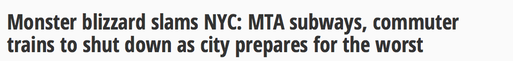

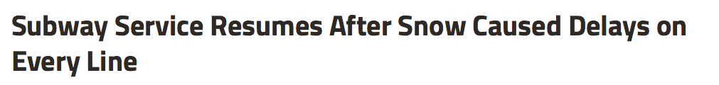

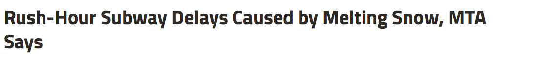

The TTC actually like underground lines better as they don't have to worry about Ice and snow building up on the line and interfering with equipment onit like switches and trip arms. On the colder days on both lines they have trains that are equipped with sprayers that they use to spread deicing fluid on the third rail too keep ice from building up on it. Because of the high current flowing through the third rail it snow melts on it but can become sticky and ucy if it's cold enough that's what crippled the TTC during the storm of 99, they had to run trains only in the tunneled sections of the lines.
New York and Chicago seem to handle snow/ice on their surface rail just fine, thank you very much.
If you want to be rude, at least try not to throw around baseless claims like that.
I'm in favor of above ground subways wherever possible, but it's incorrect to assume that snow and ice never cause problems. Not to mention that heat waves and strong winds have forced TTC slow orders on surface subways.
