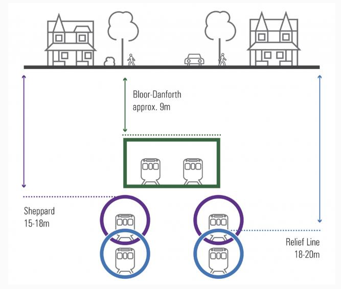

I think the key is station depth. If the line is built by TBM, stations are deeper and more costly, and thus become farther apart to f it the budget. DRL bragging that their tunnels will be deeper than anything Toronto has seen before just means even fewer stations.
If they could go cut-and-cover, than 700m station spacing can be done. It is up to planners, locals, and politicians. If they all insist on deep bore TBM, or if they refuse to even consider cut-and-cover, then they are just saying they don't want stations.
There was a nice graphic on the recent UrbanToronto article about the Carlaw alignment, comparing the depth of the relief line vs other subways. I haven't seen it before.

What does the new alignment mean for the homes at 227–241 Langley? Tunnel is bored, not cut-and-cover, in current plan correct? (Especially because of the depth of the station at Carlaw/Gerrard.) So aside from noise and vibration from construction and train operation, there probably won't be expropriation correct?

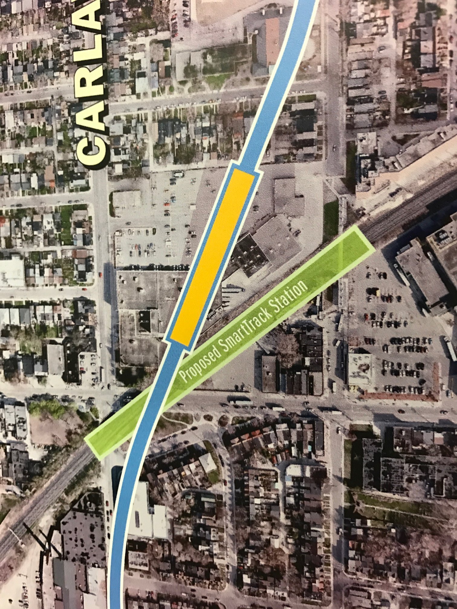

In the public meeting, I don't think there was one single mention by city staff of GO RER. Instead they kept referring to a "SmartTrack station", and how the DRL "connects to SmartTrack". It's so infuriating that we still haven't moved on from this, that somehow it still lives on inside the planning departments at city hall and Metrolinx.
This will continue. It's a little bit about political masters, but more about who pays for what.
