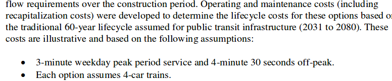

Take a close look at not only this reference, but all through the case study:
"based on the traditional 60-year lifescycle". 4-car trains. But you claim that's only "initially"

And how can the modelling for "60 years" be accurate if the cars are only "initially" for four car lengths? There's still a massive hole in the story. Are there to be only four car trains until the *long* section is added? If so, then the modelling lends itself to an even greater error. The "4-car trains" are mentioned in many comparative charts through-out the report.

Exactly...if you wish. You do realize you've now made my point on the 60 year life cycle being based on "4-car trains" as being very faulty?
If the Relief Line Long requires exiting trains on the line to be upgraded to six-car sets, the incremental cost for those additional cars is attributed to the Relief Line Long, not the Relief Line Short. Those extra cars need to be purchased because of Relief Line Long, not Relief Line Short.
