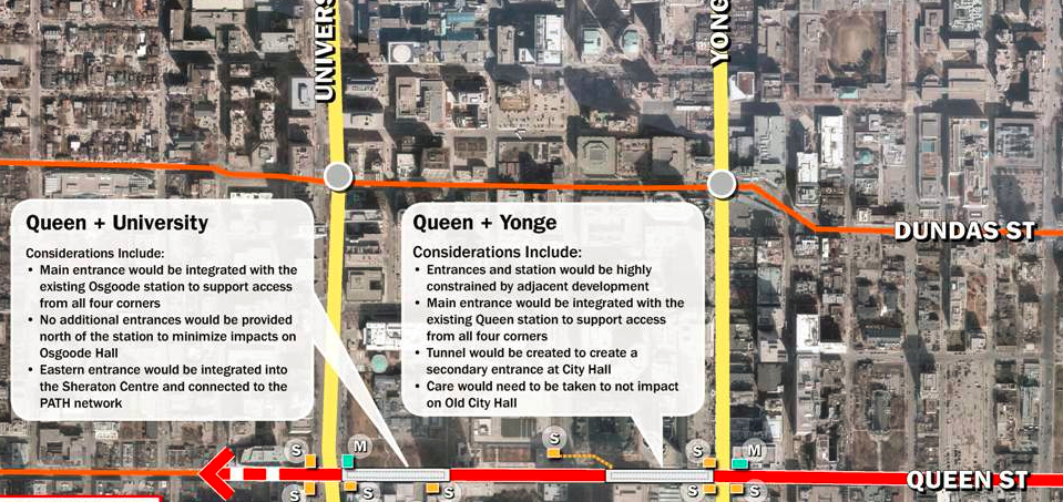

If the line is only going as far west as Osgoode, where are they going to extract the TBMs? In the centre of Queen Street, or Osgoode Hall's lawn? That wouldn't make sense. Best to bring it as far west as possible in the initial run, and the only way to do that is by studying for it today.
Based on the last version of drawings I saw posted, the box would extend as far east as the edge of Nathan Phillips Square. But they have that massive parking between there and Bay Street - how deep is that?
Looks to be about 230 metres between the station boxes for Queen and Osgoode stations. I'd assume they'd pull it out east of Yonge.
Still pissed about that platform alignment at Osgoode. Would have made for a good west entrance/exit towards Queen and John area.
Its only preminlary. They stated they had to choose that location as 250 University would interfere with the standard Station Box, and once detailed planning starts they will see if they can modify it. Its also the same case for Yonge.
