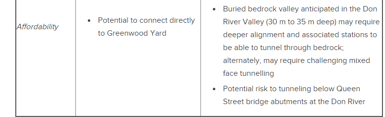

And it was pointed out in the Pape vs. Carlaw debate that this would be the deepest subway in Toronto, deeper than Sheppard, since it needs to get under the Don River. So either it would have to be very deep cut and cover, or they'd mine the section under Yonge and under University and keep boring?
