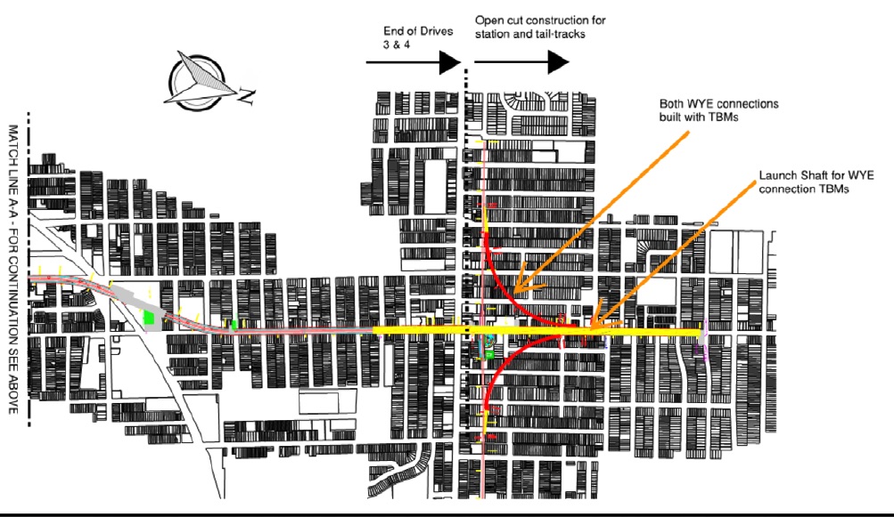

According to the EA, there will be a wye north of the Danforth Station, built using TBM's.

This depends on the model chosen for the tender (assuming the EA is accepted by government).
If it's done Spadina style or even split like Eglinton, possibly within 24 months for start of excavation of the TBM deployment hole. I don't generally count prep work (moving sewers, gas lines, etc. out of the way) as construction for the same reason I don't count demolition of existing structures as construction.
If it's an AFP model tendered as a single package then it's still at least 40 months away (1 year to put together a tender, 1 year for bidders to evaluate it, + 1 year to ramp up and purchase tools like TBMs). That said, once it hits financial close (around 30 months) then it'll be finished even if we'd prefer it wasn't.
