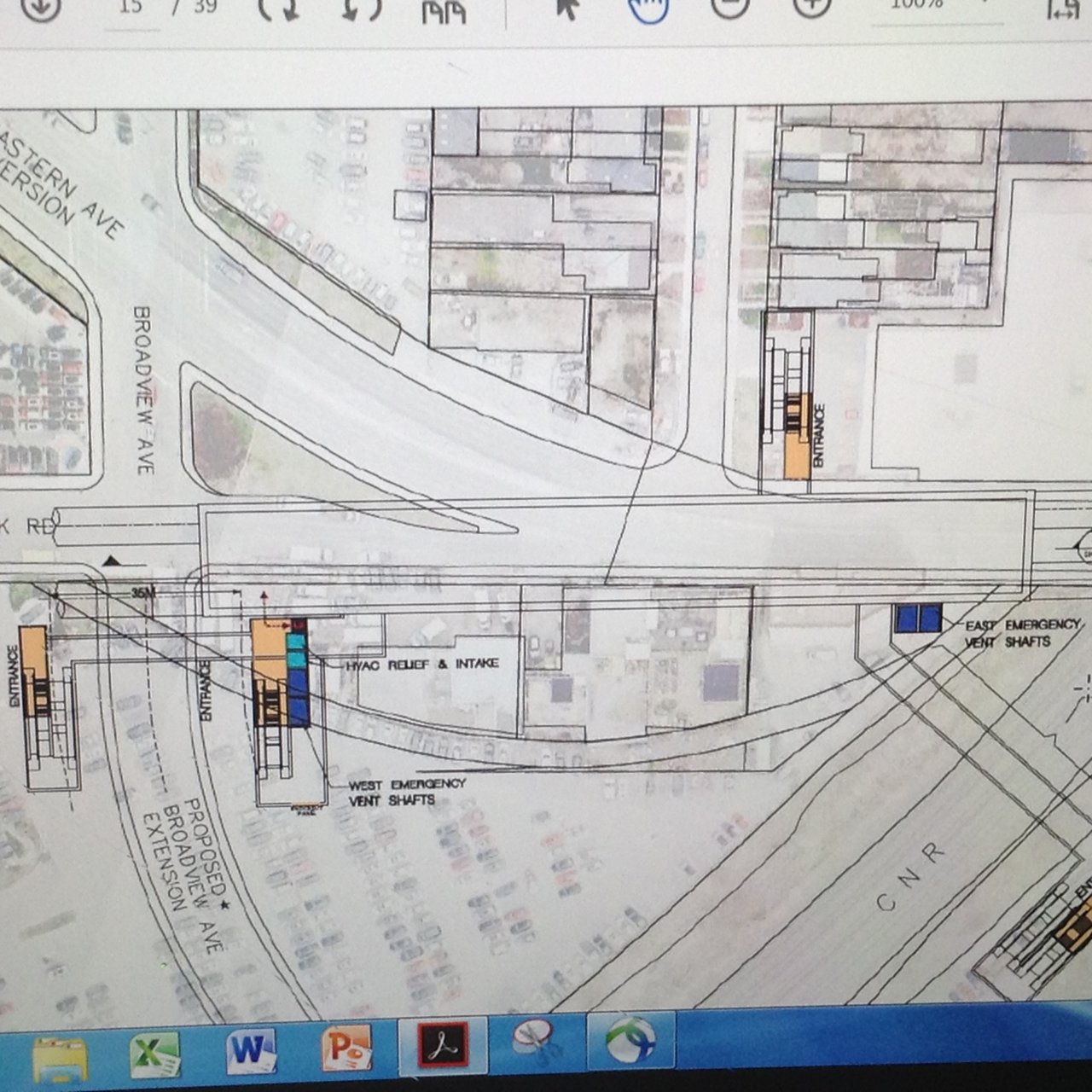

steveintoronto has brought up tunnelling and geotechnical challenges with having the line cross above the Don and DVP but I contend there are simpler geometry issues that make this essentially impossible (nothing is "impossible" but the scale of impacts do not make it feasible).
One just has to look at the plan views of the proposed station, focusing on where the platforms are located relative to the rail corridor:
View attachment 184551View attachment 184552
Scenario 1: At-grade (elevated) with the rail corridor
Not feasible, due to the obvious conflict with the existing rail corridor. Btw, I see absolutely no chance of this line being interlined with the LSE corridor, which is the only way this scenario could ever resemble something that is feasible. Raise it over the rail corridor? Non-starter, again for obvious reasons, plus the platforms would have to be on a serious gradient.
Scenario 2: Lower to Eastern Avenue grade east of the DVP
We're now in conflict with the Broadview Avenue extension, not to mention the rail embankment, and Eastern Avenue when the line turns northward. Remember, the platforms have to be at a zero gradient and their eastern ends are at the rail corridor.
Scenario 3: Lower below Broadview Avenue profile east of the DVP
To clear the DVP and then to be sufficiently lower than the roadways and subsurface utilities on Eastern and Broadview, that's one heck of a roller coaster and our platforms will not be at a zero gradient. Plus, if you're now diving below grade for the station, why not just tunnel the river and the DVP?
Bottom line: this is another example of wasted time and money with only the consultants on poorly scoped, cost-plus assignments benefitting from it.

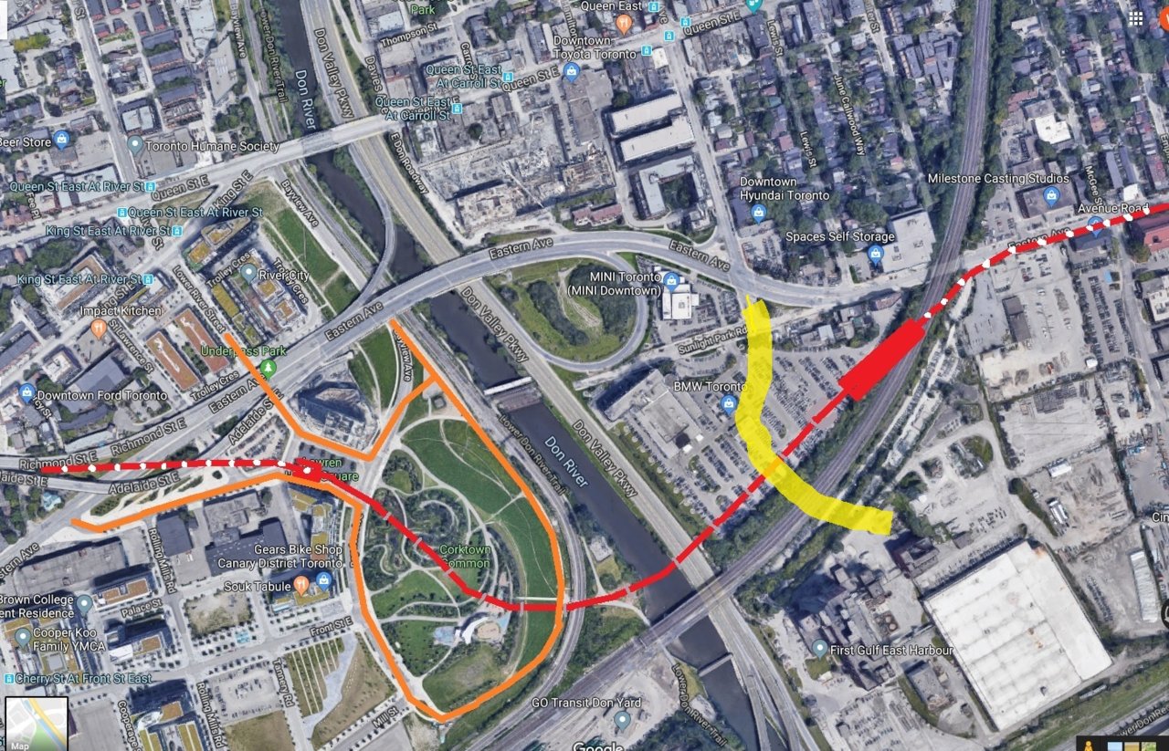

Scenario 2. First, the platform would likely be shorter in the Ontario Line plan - with the entire platform, and especially the west end of it, moving eastward maybe 100m or more. Second, Broadview could take a shift to the west, and be lowered marginally, to go under the OL and LSE-GO. Finally, I think stations can be at 0.5%, not 0%.
Regarding lowering Broadview, you're now lowering the intersection with Eastern Avenue and all existing approaches on the north, east and west sides in a floodplain and in a way that will affect the DVP ramp alignments. It's also important to note that any alignment design for Broadview will be driven by streetcar/LRT parameters, as it will be extended south into the East Harbour development.
Even if the platforms can be on a 0.5% gradient, that's not very much rise/drop available to make the kind of elevation changes that would be needed in the relatively small space that's available here, given all the existing conflicts and fixed points that already exist.
Hopefully the platforms and trains aren't shortened too much...it would be a shame to restrict capacity on a brand new "relief line" and at a key interchange station with "Union Station East", as Verster refers to it.
Not to say there are not potential solutions, but this a very constrained site with lots of restrictions and fixed points.
Maybe I didn't say it, but from my crude sketch, if lowering of 2 or 3m is needed, it is clear that the only lowering will occur south of Eastern over about 150m distance that exists.
