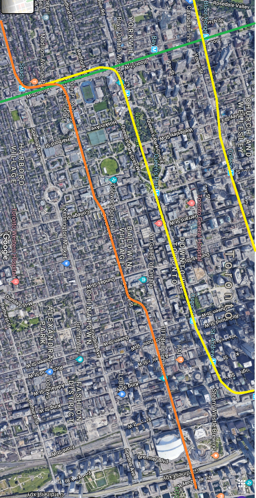

Assuredly there'd be a stop at Harbord. Front and King could be consolidated into one stop (Clarence Sq being the southern exit). Here's an idea for replacing the 510 with an extension of the Spadina Subway. The Yonge-University Line now ends at St George Stn:
This hits many nodes en route: U of T (a PATH system could even connect the Harbord stop directly to Sidney Smith and Robarts), CAMH, Kensington Market, Chinatown, Fashion District, West Queen West/SoHo, King West, CityPlace, Rogers Centre, Harbourfront Centre, One York, Queen's Quay Ferry Docks, Weston Harbour Castle, Scotiabank Arena/Jurassic Park. It's also very complimentary to the Ontario Line.
One of my comments was on disruption to the Spadina LRT during construction. It is a nice straight run down Spadina, whereas jogging over from Spadina to St. George would take some effort.
Speaking of Ontario Line, would it make more sense to go along Richmond for this same reason. It's less than 100m to Queen, but would allow Queen streetcars to run uninterrupted during construction.
