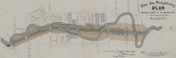

And of course, it should be noted that the Don River was not always channelized. The historic alignment of the Don River may have looked something more similar to this:
(Source: Bateman C., blogTO, That time the Don River was straightened)

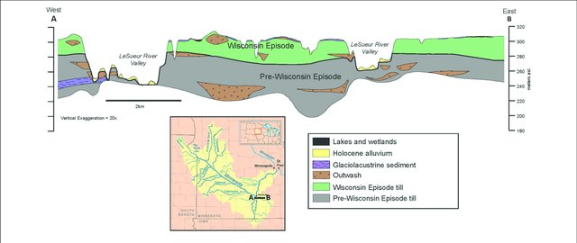

I'm sure you can see the large sinuous curves. These sorts of curves would carve out bedrock over millions of years and several glacial periods, creating a subsurface profile that could conceivably look similar to the one shown below:
(Source: Andres A. et al., Impacts of Quaternary History on Critical Zone Structure and Processes: Examples and a Conceptual Model From the Intensively Managed Landscapes Critical Zone Observatory)
Note: This is not the Don River.
However, it is a river that formed through similar soils (glacial till) during similar glacial-interglacial periods. Thus we can extrapolate that the area of the Don we're looking at would have a similar profile. You can see in the river valleys that the soil is not flat or horizontal, but are quite undulous. This presents similar problems of volume loss, but there are more severe issues than slight surface settlement.
In this case, the transition zone could see a switch between soil and rock as bedrock maps show it being relatively shallow here. If this occurs back and forth, you'd essentially have a very rough transition zone across the entire stretch of river. And remember, the "river" is not just the 40m or so channelized one that exists today, but includes all the historic alignments and curves which leave an impression in the bedrock. These possible difficult geological conditions would exist under water pressure. We might expect to see similar issues to other TBM projects under rivers:

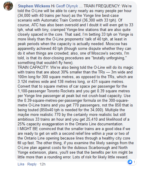

A fellow well known in transit activist circles, Stephen Wickens is loudly making known his issues w/OL capacity projections; and he's put his reasons why down for everyone to see.
A fellow well known in transit activist circles, Stephen Wickens is loudly making known his issues w/OL capacity projections; and he's his reasons why down for everyone to see.
Just a rehash of what we've discussed on this thread endlessly.
