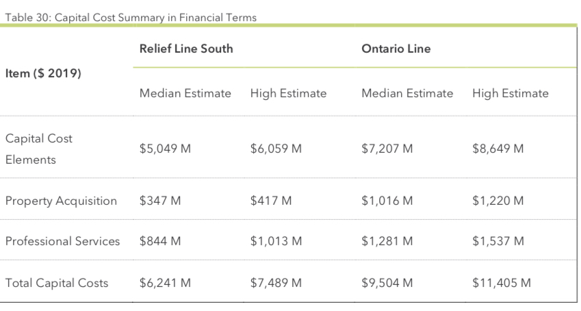

You appear to be right on the money. The BCA identified $1 Billion to $1.2 Billion for property costs
Not quite though. My number is strictly for the Leslieville section; the above is for the entire line.
I don't believe you would encounter the same problems w/the proposed elevated section at Overlea, in terms of expropriation costs; though there are other issues there.
Using their above numbers, in 2019 dollars, I would assume a total number closer to 1.7B * for the property aquisition (assuming its done now, and the property market has a lull) but that is deceptive.

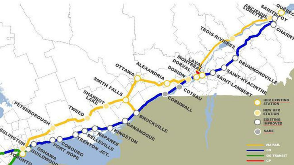

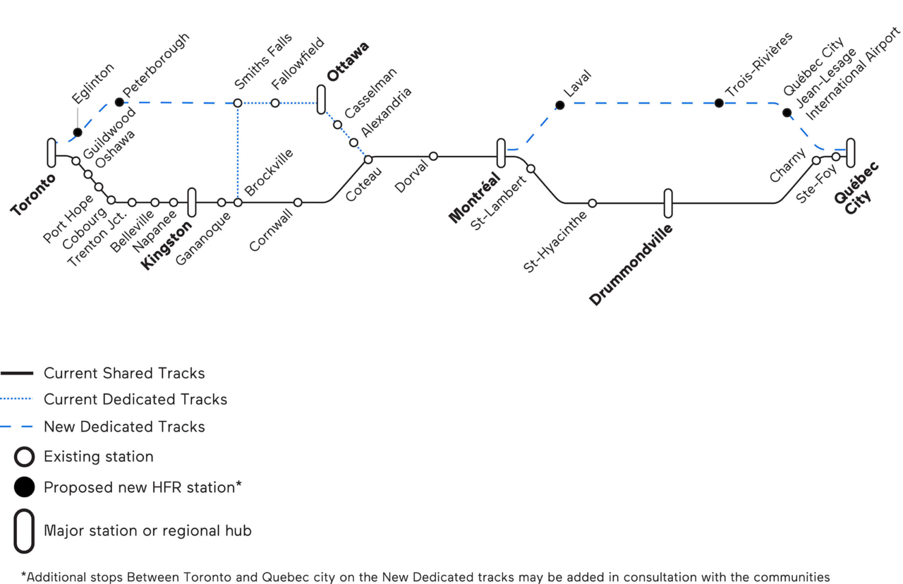

In looking at the concept maps produced by VIA, they might be leading more to the former CP Don Branch/Belleville Spur instead of the Lakeshore East Line/Stouffville Line for HFR. They only indicated "Eglinton" which could be here (Google Map link) or here (Google Map link). The Stouffville Line goes under the CP Rail line here. Also, see a post here by @alexanderglista.
No question that option is under consideration.
However, there are some serious capacity constraints on the CP Mainline, and some would be quite expensive to fix.
The Don Branch takes you up to Leaside, but then you have to get across ET Seton Park, if that bridge needs another track, the cost would be massive; Additional corridor space at other points is more workable; but the Lower Don is also flood prone, the big bridge by the Brickworks needs considerable work, not sure if the piers are ok, but the deck is toast.
Across a number of issues, coming up via Stouffville would seem the more prudent and cost-effective choice.
Without the OL in the way, there is ample room for 5 tracks in the corridor, give or take some bridges. (that are short)
The first bridge (Seton Park) is about 250m long, while the second (Brickworks) is 350m. If property is available, (build half new bridge beside, demolish existing, and built other half in the place of the first), its maybe $50M to $75M each to replace with a 2 track bridge.
Building a new single track bridge is very similar cost, building a temporary bridge to the side, moving the tracks, tearing down and building new bridge, and removing temporary bridge.
