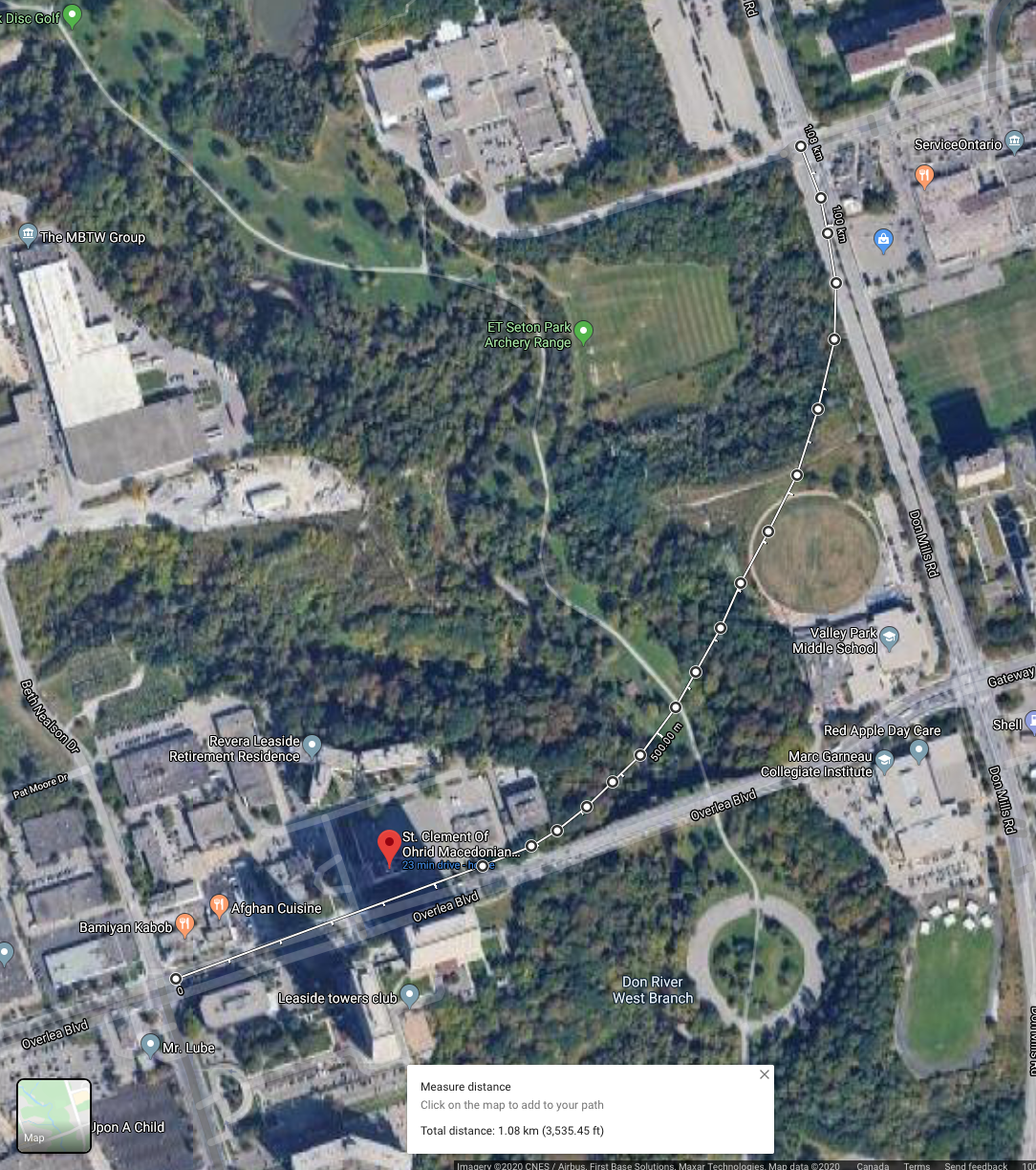

From Thorncliffe Park and Overlea to the creek itself, on the gentlest possible curve, is just under 1600 feet. At 3% grade, that's a potential 48 foot drop. Then it's 2100 feet to Gateway and Don Mills. That makes me think that it's physically possible (just barely) for a duckunder to be above grade at Thorncliffe Park, dip to intersect the hydro lines below grade, and be back up to a portal around Gateway. Cut and cover in the schoolyard won't create the need to demolish the school building. Perhaps the elevation of the Overlea Roadway would be adjusted to give a bit more clearance on the down slope.
So basically, there'd be a tunnel under the hydro corridor. This tunnel would end at a portal at gateway and Don Mills. Just making sure we're on the same page.
That tunnel would be running rather shallow and right at the edge of the valley. I'd be concerned about erosion.
Also, trains really don't like to make grade changes on curves. It increases the risk of derailment. Slow orders would likely be in effect for this segment
Might very well be possible though. It would just be janky, like everything else about the Ontario Line.

Yes on all points. The radius of that curve is probably ok for graded track - it would be no worse to (for instance) Line 2 dipping into the Humber and back up. We've never seen a problem on that gradient/curvature.
I could see the line being in an open trench with rooftops at grade at the point of intersection with the hydro lines....just to save a few feet of cover over the underground part. Maybe the up-grade runs up the west side of Don Mills and over the current OSC parking lot until it is elevated enough to jog over to the center of Don Mills. (Can't wait to see the renderings of that :^[ )

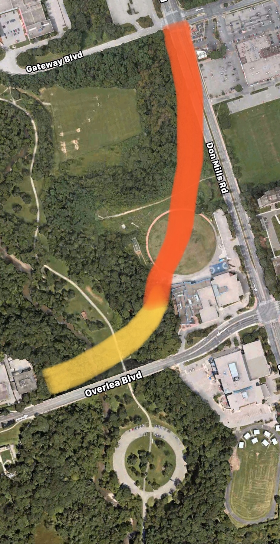

The elevated bridge would start at Overlea (orange), curve northeast, probably run a short segment at-grade at the northwest corner of the middle school (green), before utilizing an elevated alignment (orange) to cross under the hydro corridor. It would then connect to Don Mills Road. These elevated structures over the park would be more than 600 metres long.

Oh my gosh, I didn’t mean tunnel under the valley :eek:
The valley would still be spanned by an elevated structure. But once on the eastern side (Don Mills) it would enter the valley wall to become a tunnel. Just like how Line 2 transitions from elevated to underground at the Bloor Viaduct. The tunnel would end at a portal on Don Mills road, near Gateway Blvd, to become an elevated structure. That should be around 700 meter of tunnel
Something roughly like this image. Yellow = elevated and red = tunnel
