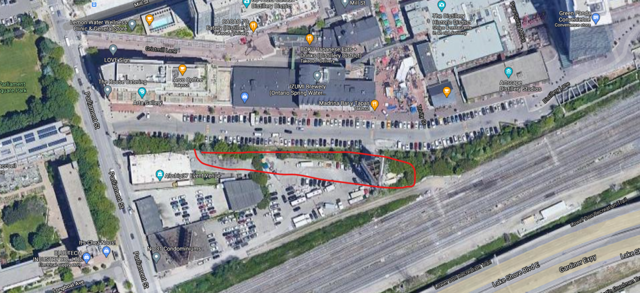

You could do a trenched/cut and cover station here, you would then still be low enough to pass under the 2 tracks of the GO Richmond Hill line.
I saw that area on GoogleMaps and thought a portal could go there with an elevated station (or at the level of the GO embankment) a bit to the east at Distillery Loop, which also shows a big empty lot online but I don't know if anything is being built there. A portal might work in the area you marked with Parliament Square Park providing an area to dive down to get below area condo underground garages.

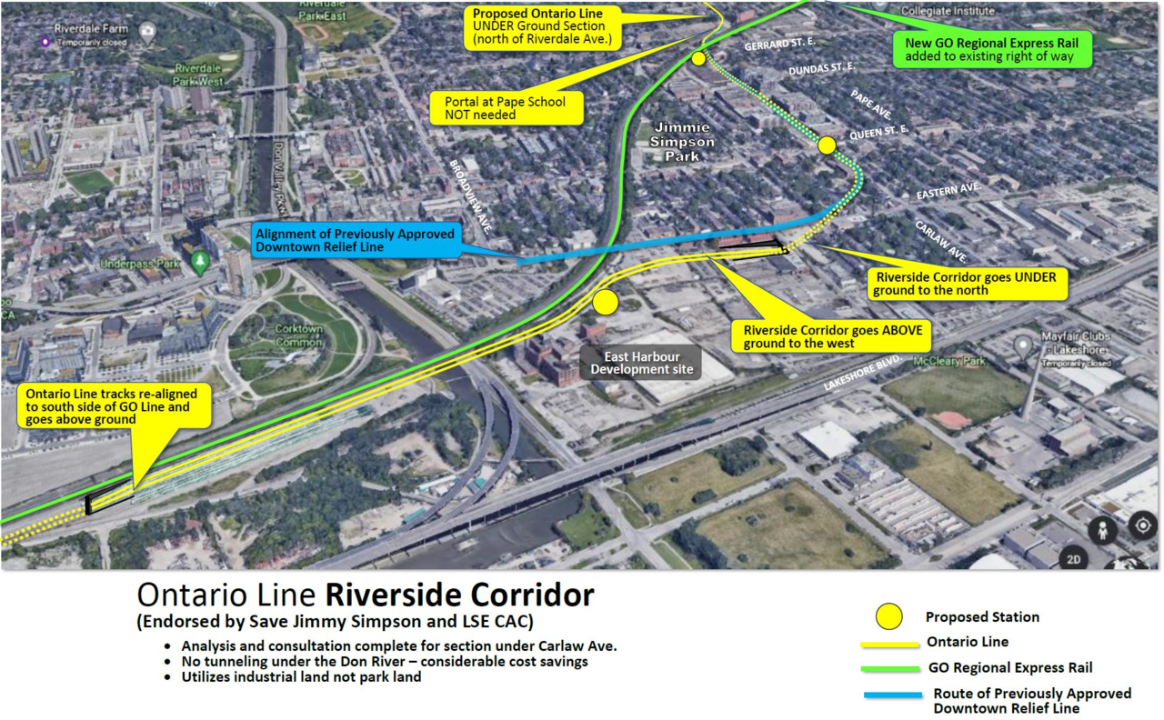

Did they resurrect part of the original RL alignment? LOL
I have to say my views (not that they matter in the grand scheme of things, LOL) on the OL are turning. Originally, I was in the wait-and-see camp. I was willing to give Ford and Metrolinx a chance on this.
But I think it's increasingly clear this is becoming another Toronto/Ontario transit project with delays, cost overruns and poor planning.
My preference is veering back to the original RL with a northern extension to Eglinton and the western segment dropped. As others have pointed out in recent weeks, it's odd Ford didn't announce an RL North during/after the election. Looking like a major missed opportunity at this point.
Yes.
I actually think it's a fine enough idea; the additional station at Queen is interesting. But I also know these same neighbours would be up-in-arms about increased density around the stations. They'd probably find a way to enlist TO Planning/Heritage to block declare large chunks of the area heritage to make it impossible to densify (as is infuriatingly being currently done along large swaths of the Bloor line and around other potential OL stations.)

Subject to design drawings we don't yet have, the probability is that putting all the tracks on the west side, would eliminate all the parks along Degrassi from Queen to Dundas.
Part of the answer lies in station placement; and part lies in deciding how to get the new tracks in there.
The suggestion was made that shifting the O/L tracks to the west will require physically moving all of the existing GO tracks to the east, which is disruptive and costly.
But if the intent is also that there be no extra bridge space on the east and no embankment expansion on the east, then it will, needless to say, all be on the west side, as would any station.
Absent detailed design drawings a high level of speculation is involved as to impacts.
But I remain of the view we're better off tunnelling this section of any relief line.
There are compelling operational and capacity reasons to do so other than any 'nimby' arguments.
I also have great sympathy for some of those 'nimby' arguments, even though I don't live in the effected area.
Its a lot of destruction of park space in an area without that much of it relative to growth demands.
I'm not sure why putting the tracks on the north side would impact parks on the north any more than the current plan. Ultimately it should have less impact because you have a narrow cross-section, with only one extra-wide spacing between the transit and GO tracks, rather than two. Presumably it shifts the fourth GO track further south (east).
Now, it might have more impact right at Degrassi/Queen, as presumably it shifts the station buildings north of Queen. At the same time it should have less impact at Gerrard/Carlaw as it would presumably shift the Gerrard station north of Gerrard, with the south portal no longer a constraint.
At the same time though, I like the plan the community has proposed to put it on the South. For one thing, it actually puts the Leslieville station back in Leslieville, instead of being ridiculously close to East Harbour. Secondly it let's them build the Gerrard Smartrack station, which was cancelled because there was no space left for it with the south portal.
You answered the your own query there, its the Queen to Dundas section that would be at issue.
This alignment does have some things to recommend it; its certainly better than the all above-grade proposal.
I'm slightly amused by the thought of them building a new above-grade alignment right through the middle of Parks, Forestry and Recreation's main yard and offices for South District.
The alignment would all retention of the on-site heritage buildings that front Eastern, but certainly require re-location of the Yard.
Not a lot of spaces to move a facility of that size.
Its a 10 acre facility, not including the heritage buildings.
I suppose you could city a 2-level parkade for the operations equipment, but the City hasn't done that before that I can recall.
You would also need a connection of the offices though.
