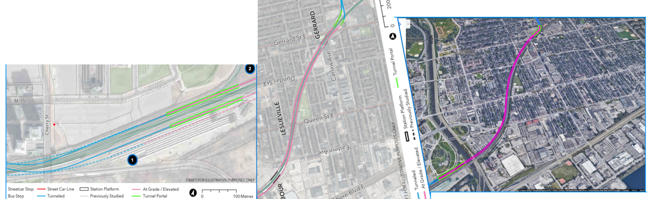

A rough interpretation of what I think is happening? Red = portals
[I've been corrected will fix]
Just wanted to update my earlier post where I got the location wrong. Very rough, not to scale, quick visual of the shift to both OL tracks on the north/west side of the existing LSE/ST/VIA corridor. It's at a high level so it may appear to show the OL tracks outside of the Metrolinx ROW but that's not the intent. I think I read in a recent post someone mention that they don't see Metrolinx removing existing LSE/ST/VIA heavy rail tracks? It just looks like when you zoom in that there could be space on the south/east side for the shift. Maybe if I have time I'll do a rough sketch in certain parts. The location that has that old centre platform is kind of interesting. Again, but be to scale and I'm not a civil engineer.
Map left from here - previous alignment of OL on either side of GO; map centre from here and ditto; map right - OL tracks on north/west side given the recent news using Google Maps.
I wonder if using open streets map from here would also provide a good view of the potential track arrangement (2 OL; 4 GO/VIA), or this map.
