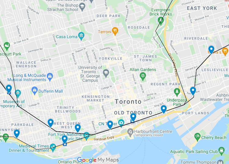

We're assuming here a tunnel under the LSE corridor, which would put the portal around, here?
I can't speak for certain but I don't recall this part of the line being considered that flood prone, not to mention this entire area is being redeveloped already so I believe flood mitigation is already being built.
I think it is in the floodplain right now, but the Lower Don project currently being built will alleviate that risk. It might still be prudent to install floodgates though just in case.
The spot marked with the red cross on your map is probably fine. But where will the other portal go? A short tunnel would have to emerge in the Bala Sub corridor, and would be very close to the river and at risk of flooding. In order to avoid the flood area, you would need to continue the tunnel to at least north of Gerrard and perhaps even further.
As I said the tunnel is under the LSE corridor - the way this discussion started is by discussing the limited trackspace east of the don river caused by the existence of the Ontario Line corridor. Its about making a tunnel that can dive under the Don River, and can give enough space on the surface for the OL and LSE before resurfacing where there's enough room to continue. The only real issue I can thing of is how feasible it is to clear the river. Now from what I can find, the maximum grade of HSR is 4% (although this assumes that the train is already moving quickly enough to make such a steep incline I believe, and there's probably even more in the way for this), and assuming such a grade descending under the Don that only leaves around a drop of 26.67m which I'm not certain is enough to pass under the river (It might be possible to keep the tunnel subsurface until a block - say parliament-sherbourne, but that depends on how many utilities are under these streets so how much room there is for the tunnel to rise), so this tunneled express idea might require to build underground platforms at Union.

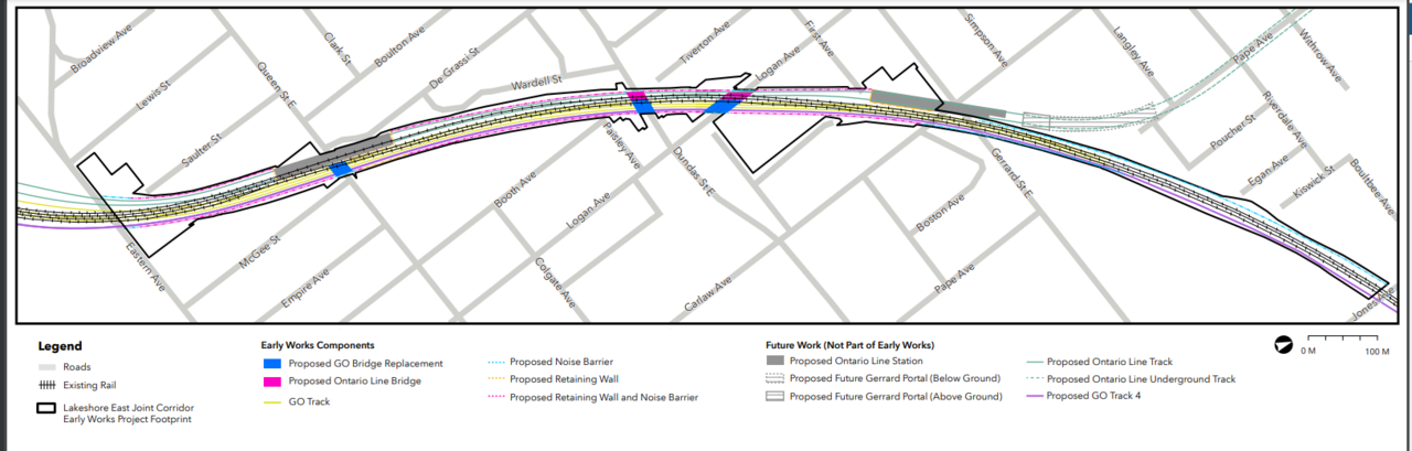

It will be difficult to build a tunnel for the Don Yard shortcut, the line to the Don Yard (same as Bala Sub / RH GO) runs on the west bank of Don and the tunnel portal will be vulnerable to flooding. It should be noted that both OL portals are located quite a bit further from the river; at least they got that part right.
