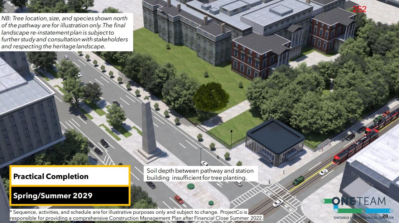

Wouldn't matter, the roots for these trees will not be able to get deep enough to reach the same level of growth the current ones did.

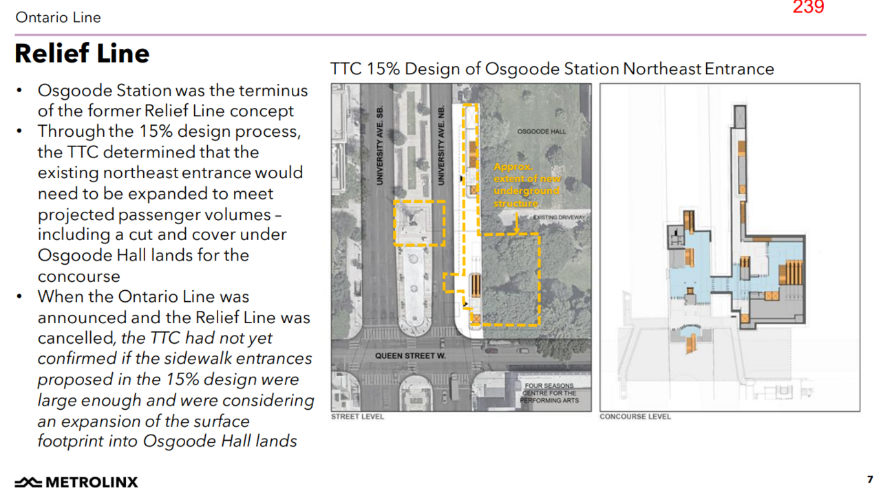

They might at Osgoode - I thought the tree removals there were for access more so than the small station entrance.
Moss Park is literally over the station - so it depends how deep the station is - it isn't shallow.

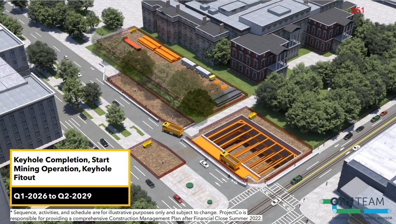

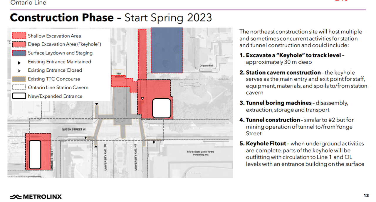

Trees cannot be planted anywhere on the keyhole site.
The station headhouse only takes up the south end.
From the factum:

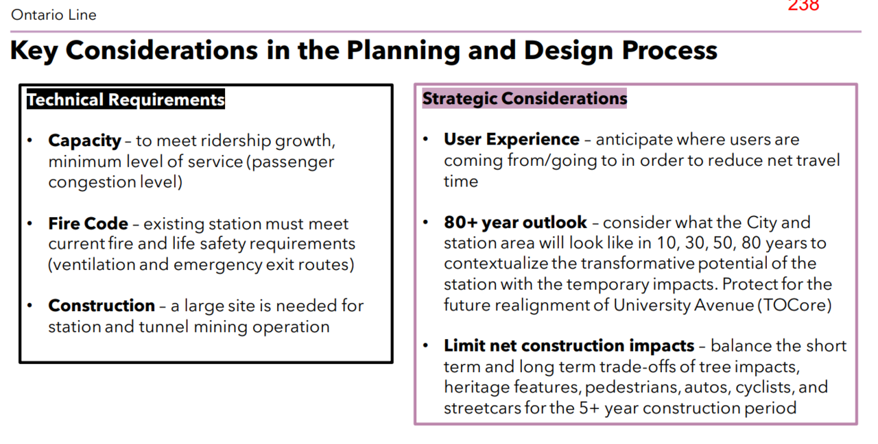

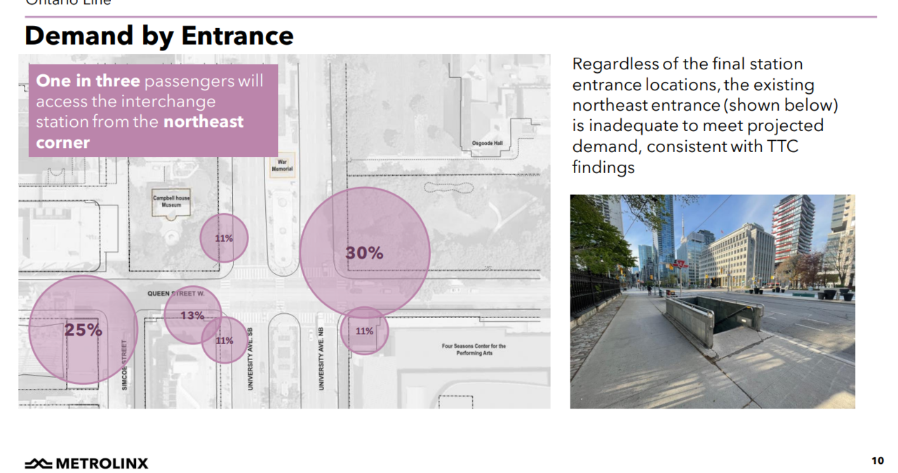

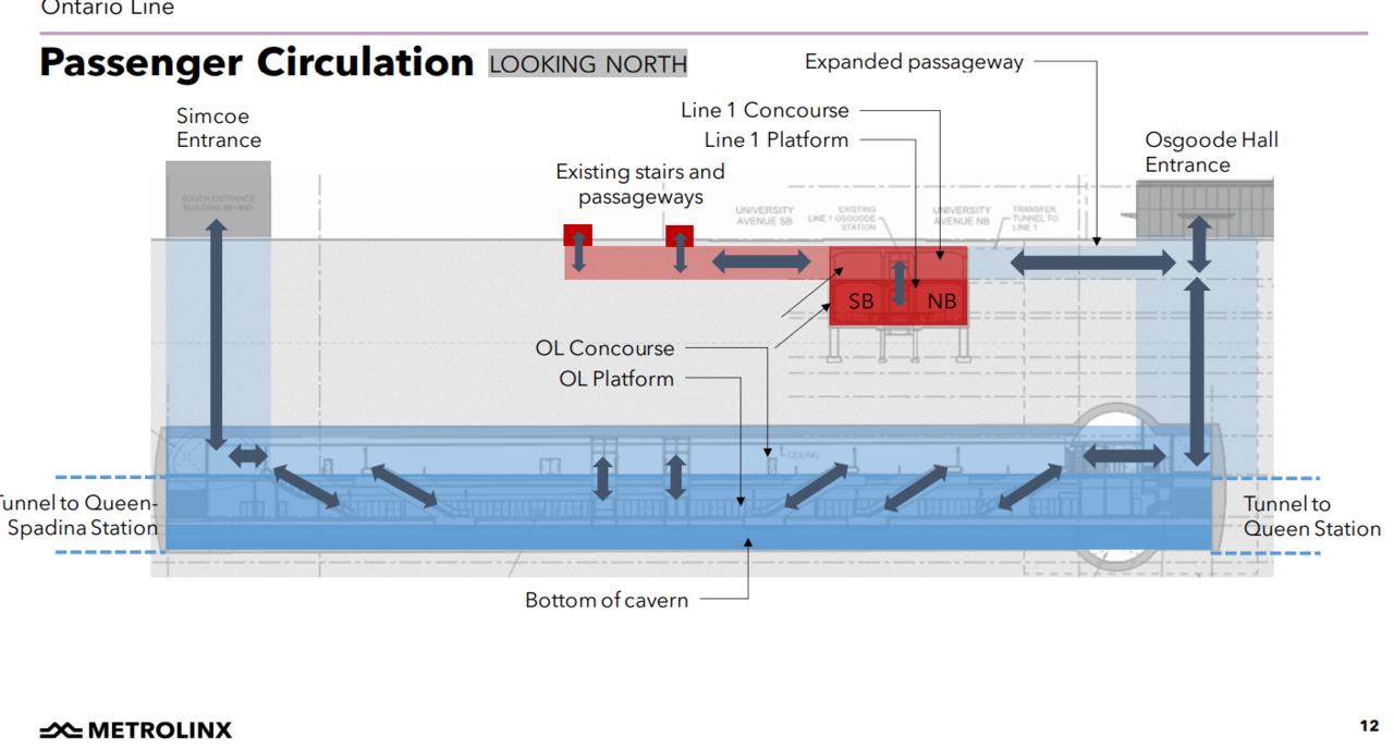

From the Factum, Metrolinx explaining why they think they need to build the new Northeast entrance

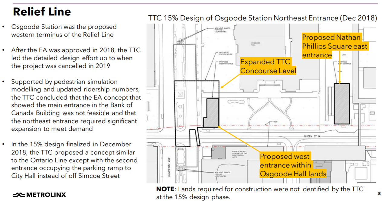

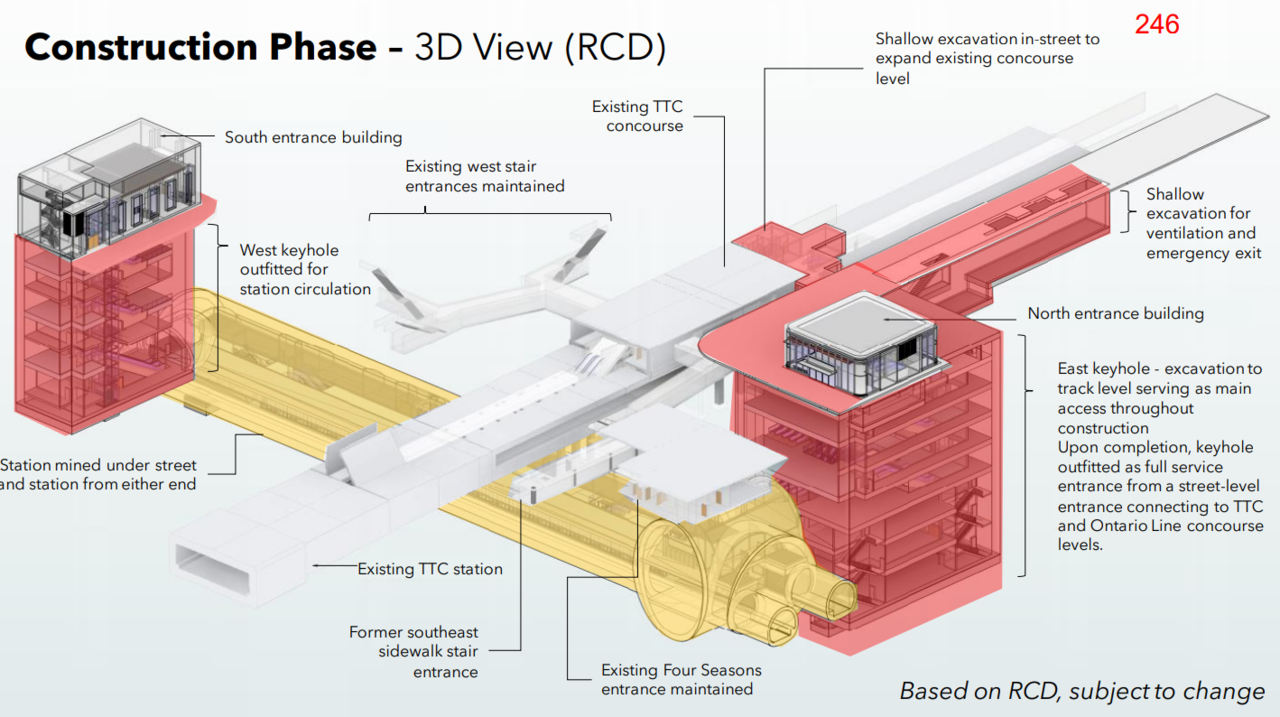

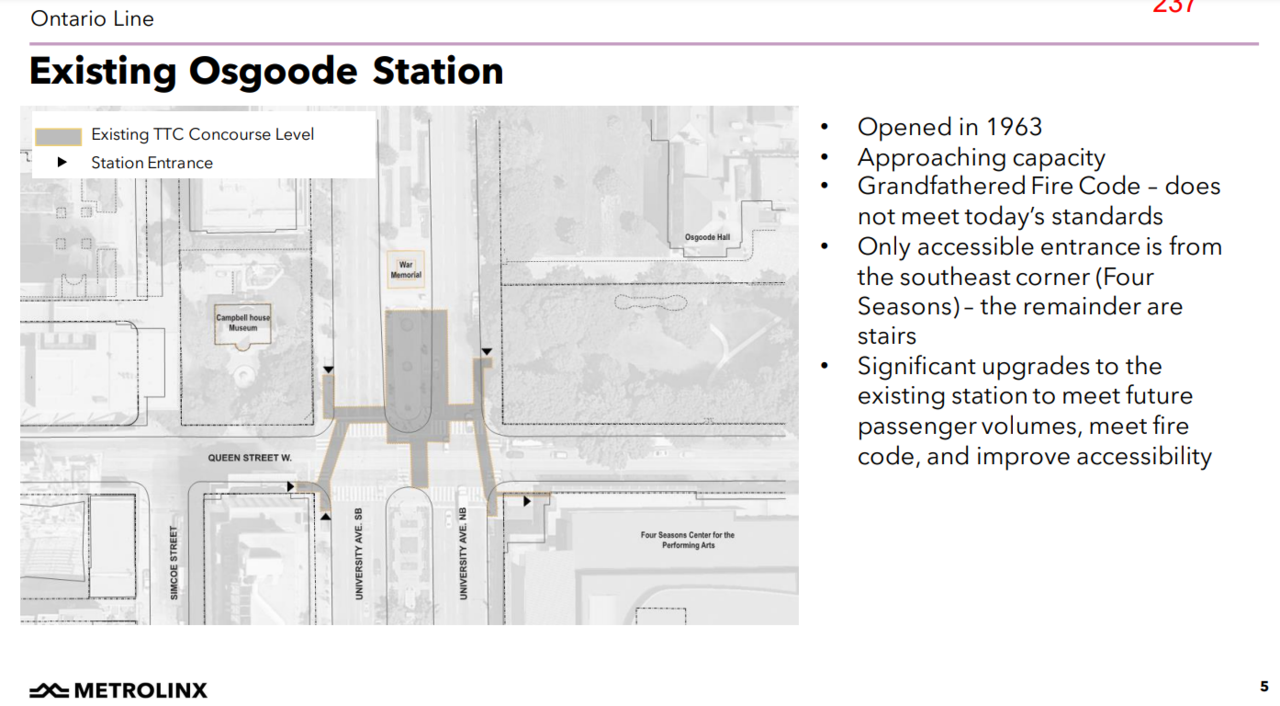

Osgoode Station Info

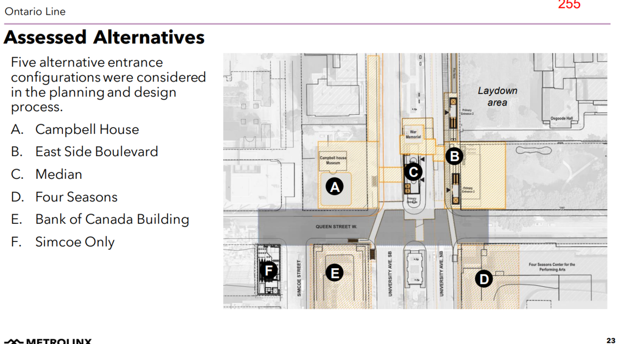

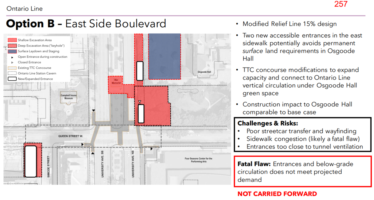

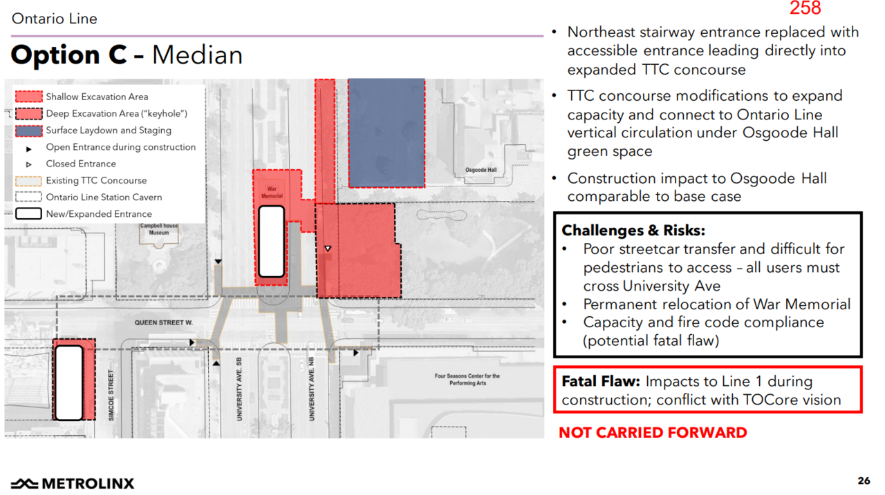

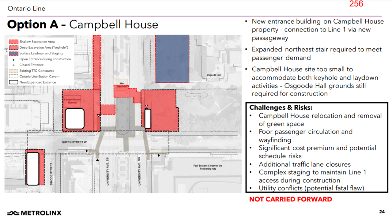

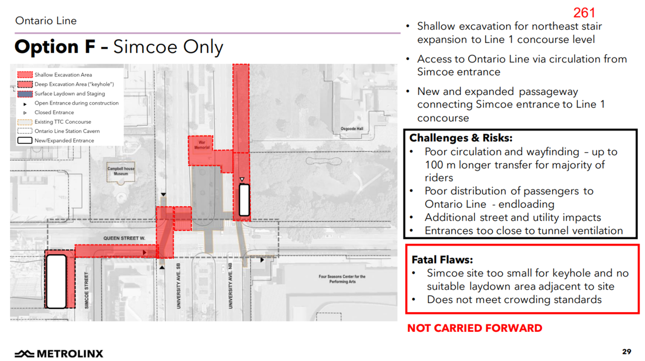

Metrolinx reasoning behind not using alternatives to chosen station design
