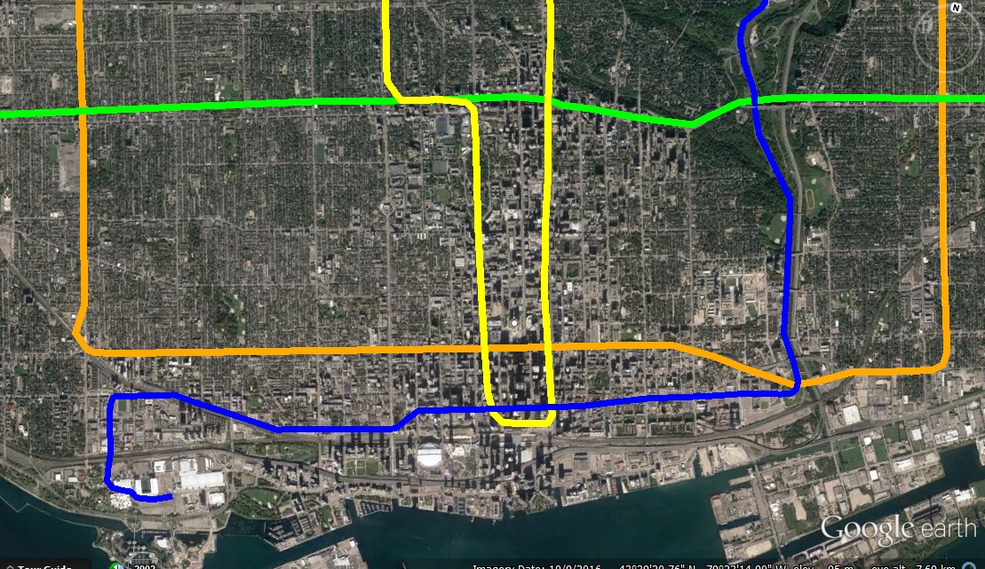

It doesn't make much sense to have the Relief Line West dip all the way from Queen St. down to Front St, even if it was part of the first phase - Relief Line South. IMO, this would truly be in the fantasy territory of a second Relief Line that goes along Dufferin-Front-King-Parliament. Let's just keep in the semi-fantasy territory of the current Relief Line of Dundas West/Jane-Roncelvalles-Queen-Eastern-Carlaw-Pape-Overlea-Don Mills.
Edit. Kind of like this (probably not north of Jane-Bloor though):

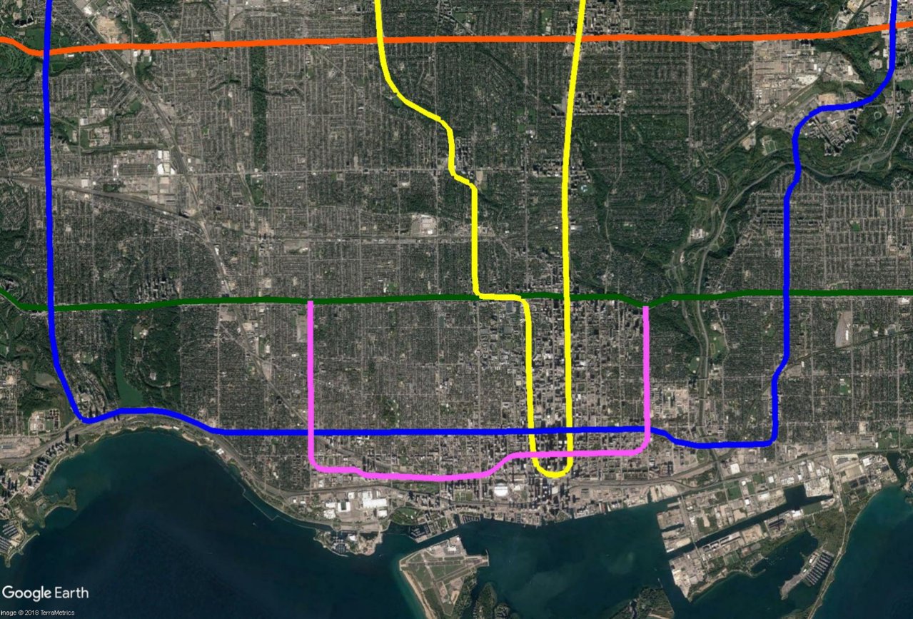

I imagined it coming down Bayview (elevated for less cost), and then ending at the Ex.
I still don't know where the conventional DRL would go in the north-west. Here it's shown as Dufferin, but I could easily imagine Parkside and Keele.
