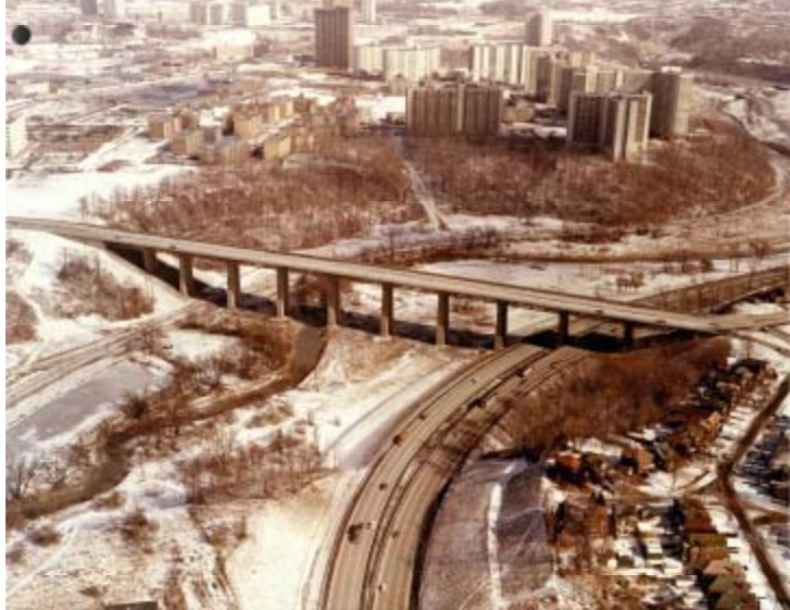

I found this older picture . It's a bit easier to see without all the trees.
182174

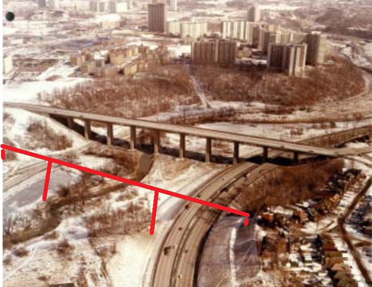

I would suspect that a three span bridge would be considered. The south abutment would be close to the reddish house, the first pier would be on the river side of the freeway, the next pier would be on the river side of the rail tracks, and the north abutment would be somewhere left just off the top left. This 3 span bridge would have spans of about 95 - 180 - 95 and I would picture a concrete bridge built as balanced cantilever - a relatively simple, but clean looking bridge. The cheapest bridge would be to use precast concrete girders with span of 45m - with the additional piers being a relatively minor cost. The City would likely want a cable stayed (or extradose) bridge.
^ @BurlOak One of the concerns for three separate bridges with approx 6 - 7m clearance connected by embankment as I proposed would be the potential for flooding, albeit that part of the valley appears to have been spared that. The Pottery Rd and Bayview connections remain intact and appear unaffected. A number of corrugated underpasses could be added for both trail passage, flooding relief if it did happen, and safe wildlife migration.
To build three separate bridges at a 6-7m embankment height drastically reduces costs, allows interchange with a yard and the RH line for stock movement, and vastly simplifies the yard area also being a staging point for Phase 2 into tunnel again north under Leaside. If a TBM(s) were to bore south from that location, it would also be a perfect use of the till to build the embankments. The very necessity for deep tunnelling in bedrock has a huge benefit in the till being rock. Stone two birds with one kill. I'll check later on the quality of the rock being suitable to be crushed. Excess till could be removed via freight on the RH line, albeit this would mandate the building of the bridges early in the construction phase, the embankment being infilled as boring progresses.

I am not sure that your 3 bridge idea will work. I don't know the elevations involved, or exact soil conditions, but there are a couple of cautions:
  1. A bridge with minimum clearance over DVP requires a height of 5m for clearance, plus the depth of the actual bridge girders, which for typical single span bridges would be somewhere between 18 to 24 times the span. If you want to span both lanes of DVP, plus have the abutments a safe distance back from the road, that span is likely over 60m length. That's a girder depth of 3m, and the overall embankment would be 9m - and more on the downhill side.
  2. Single span bridges are less efficient than multi-span bridges (18 to 24 span to depth compared to 24 to 40) - meaning that the girders are deeper (almost up to twice as deep) and look clunkier. If the spans are less than 40 to 45m, then prestressed concrete girders can be used which would be less costly. As soon as you go above this, a different, more expensive structure type would be needed.
  3. I imagine the slope of the valley is steep than the proper grade for the "subway" to travel, so the embankment would be much taller for the span that crosses the actual Don River.
  4. Your right about the flooding, but probably underestimating it. The design storm around here is Hurricane Hazel - which likely was closer to a 1000 year storm. It's something we haven't been close to seeing in the past 60 years. When the hydrology analysis is done, I am sure these embankments would be in the way.
  5. Those embankments have weight - about 20 kPa per metre height. When you add this giant weight to the underlying soil, it will likely settle. Depending on the soil conditions, this settlement occurs over years. It means that the tracks over the embankment would also settle. It also could mean that the GO line also settles. (of course this depends on the compressibility of the soil, the depth of soil to bedrock, proximity of bridge abutment to GO tracks, and the embankment height).
  6. The other consequence of the settlement of the underlying soil is downdrag forces. Essentially, piles are driven into the ground to support the bridge abutments (they typically go to bedrock). The soils grab the piles to some degree and pull down on the pile as the embankment and underlying soil settle. This adds large forces to the piles, and it greatly increases the cost of the substructure.
As I said, the least expense would be a continuous bridge spanning the valley to some degree. Depending on where the subway would emerge from the south hill, and re-enter the north hill, that would determine the total length of the bridge. Divide that by 40m, and it gets you the number of spans. Then maybe make some adjustments to avoid the DVP lanes and the normal water in the Don River. This also requires cranes in the valley to erect the concrete girders (which are pretty heavy), which are quite large construction equipment that need massive assess roads and basically clearing the entire path over which the bridge goes.
But if you want to add some aesthetics, the Balanced Cantilever would work well.
^ @BurlOak : Excellent points for discussion. No matter how outlandish some expressed ideas are, compared to the absolute vacuum of info from QP, and some of the wild ideas from "expert planners" (although it was Ford's concept, the bridge over the Don at Eastern in lieu of just tunnelling through with fully serviced and in-situ TBMs) these ideas are perfectly germane. I'd say we hit the mark pretty close with deducing 'metros' being the 'jaw dropping tech' albeit I defer from metros to a heavier and 'even more advanced' solution like London is using. (Thameslink, Great Northern, Crossrail, etc) which of course is virtually single deck RER EMU deluxe.
Some quick answers, some of your points require deeper digging to answer fairly later:
I checked both rail and US DOT highway specs to arrive at the figures I used. If it's out, it's only by degree for clearance. Your point on girder depth is well taken though. I'd say the cases for comparison already exist with the Pottery Rd and Bayview exists and embankments. So let me flip this over to state: "Built to the same elevation or perhaps a bit more than existing structures already extant in the Valley".

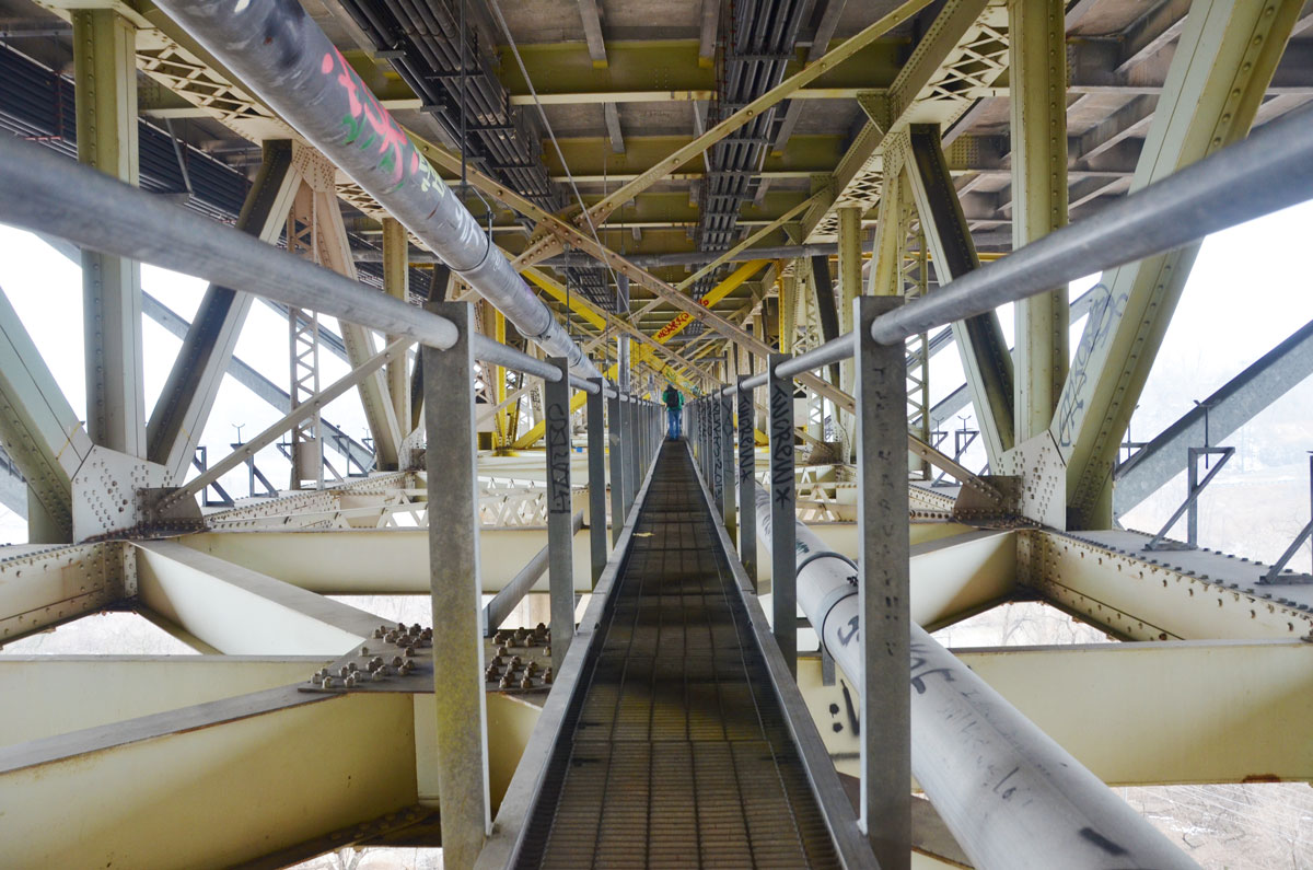

@BurlOak, the Millwood (aka: Leaside) bridge (pictured) is a double-truss bridge (upper-deck host roadway, lower deck is empty!), somewhat simillar to the older Prince Edward Viaduct 2.5km southwest, a double-truss arc bridge where upper-deck host roadway & lower-deck host Bloor-Danforth SUBWAY line 50 years after bridge was built). Could Millwood bridge's lower-deck host a "narrow new vehicle technology"???
182197
Part of lower truss is load-bearing (solid I-beam horizontal support in foreground), but other parts are not (thinner I-beam shaped horizontal supports in background). For lower truss to be used to host narrow rapid transit, it'll have to be strengthen.
182198
182199
182200

  • I don't know the design of this precisely, but I those solid beams are where the wind loading becomes larger (near the supports), while the open ones are where the wind forces are less. It looks to me that towards the middle of the spans, they have the open latticed bracing. I don't think that is strong enough to carry streetcars, so I assume when they say that the bridge was designed for rail traffic underdeck, they mean that the main trusses would be designed for the additional weight, but they transverse members between the trusses would have to be strengthened or replaced.
  • I understand that some of the additional capacity of this bridge has been used up with the addition of the extra lanes.
  • This bridge has pretty short spans - maybe 40m, while the Prince Edward Viaduct has main span of almost 100m. For, the shorter bridges, the self weight of the bridge is pretty small, and extra traffic would add a large percentage to the load on the bridge. For the longer spans, most of the loading is from self-weight, so designing for extra traffic load likely only requires minor strengthening. If the extra capacity is already used up, it means a whole set of additional strengthening.
  • Generally, I doubt its worth making any alterations or strengthening to a 100 year old bridge, as the remaining life may not be as great as we hoped for. I did toy with the idea of using this bridge in the past, but I don't think I want to rely on a 100 year old bridge to support a transit line that we want for 100+ years going forward.
