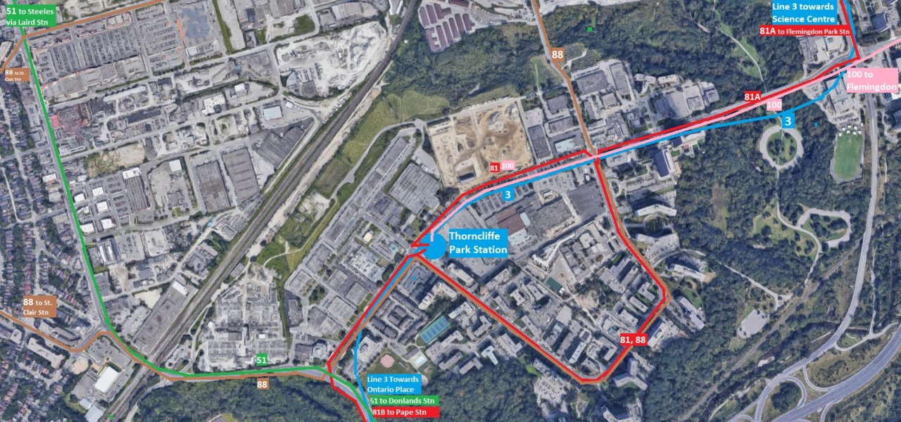

I made a map of what the optimal routing could be. Sorry the map is pretty pixelated.
The station is at the west corner because of the optimal connections and metrolinx recommended it for DRL North
-81 now runs mostly in the Thorncliffe loop connecting to the station and B branch goes to Pape stn (recommended by Hopkins123) and A branch goes to Flemingdon Park Stn.
-88 Stays the same but with street connection to Thorncliffe Stn
-100 starts at Thorncliffe Stn to flemingdon park so the route south of don river is eliminated
-51 (Leslie) will run from Donlands Station to Steeles via Laird Stn as proposed by the board shown here
Interesting routing but why not just give the two 81 branches separate route numbers? 81B retrains the current 81 designation and the 81A be called 181. They could also serve stops in oppose sides of the road. Then again why not just terminate the 25 here and the 925 won't go south of Eglinton. The 8 is going to be a busier route again to make up for the lost service on Broadview.

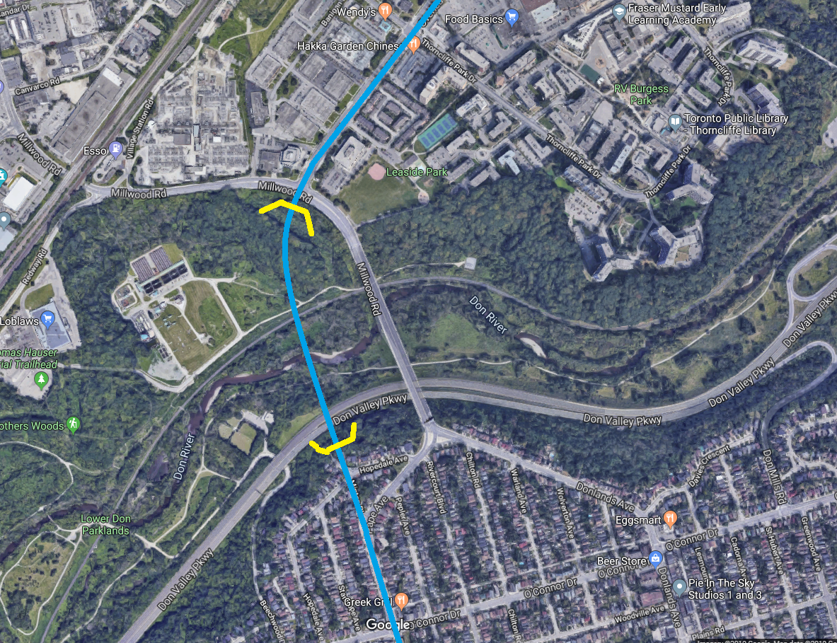

There is two questionable sections on Line 3 in this proposed map. (I'm not criticizing your map, just want to discuss about the alignment) The Millwood overpass cannot handle anymore weight so the alignment would have to be carried on a new crossing. I would place it to the west of the Millwood bridge. The second Don Valley crossing (over the west branch of Don River would likely be elevated to avoid the expensive cost of dropping 20m into the ground It would be expensive to build a launch shaft beside a high rise. I think Flemingdon Park Station should be at the intersection of Don Mills/Overlea Blvd. Spacing would be more balanced this way.

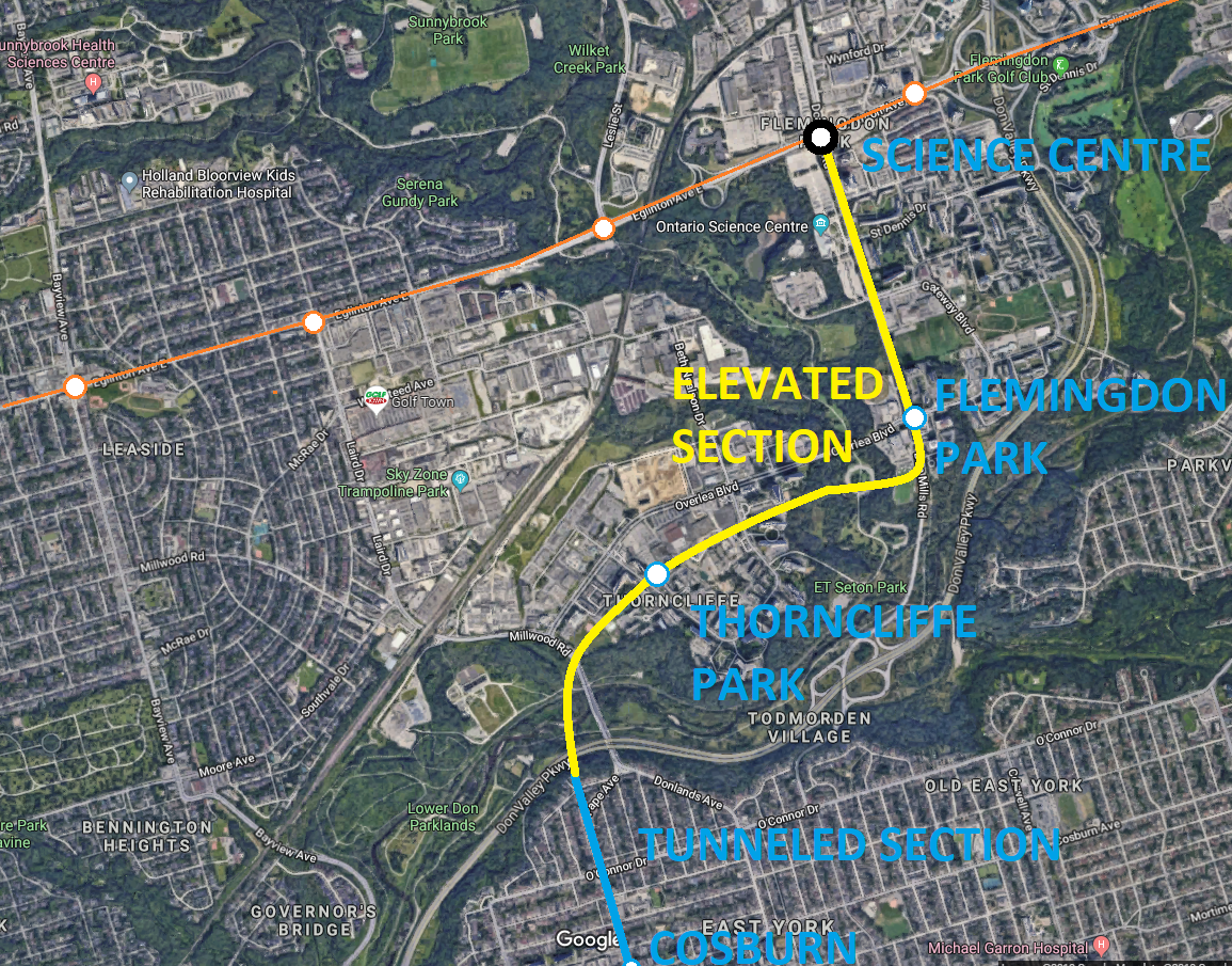

I propose the crossing be an elevated crossing matching up with Pape Ave and Overlea Blvd. They would have to but out a few houses to build the TBM launch shaft.
Continuing on with elevated transit, here's a more wild alignment I'll suggest. It's much cheaper to build the entire alignment north of the DVP on an elevated guideway. The line can fit between high rises over parking lots and behind East York Town Centre. The section above Don Mills could be underground but that would lead to an expensive Science Centre Station being built under the crosstown station box. Since, ML didn't even plan for the Relief Line to connect with the Crosstown, they could just elevated the station and use fast high capacity elevators to transfer people between the two lines.

I like elevated as much as the next guy.
I think elevated above Overlea is more likely than elevated through Thorncliffe. Despite this, I think cut-and-cover is the approach to take for both. In both cases, it would go over the West Don River, so that leaves only 1.1 to 1.5 km of underground, which is not worth launching a TBM for.

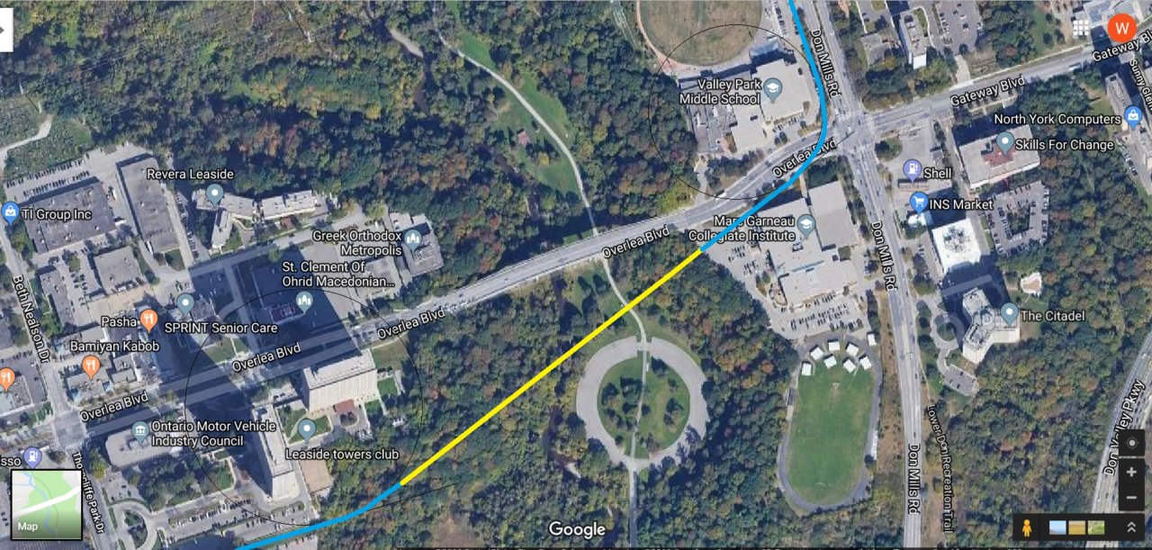

On the first map, you can't get a station at Overlea and Don Mills due to the curve and it would have to be at Gateway (north).
For elevated on Don Mills, the question is whether it will fit under the hydro lines.
That large open green rectangle space, left (west) of the Ontario Line and south of Millwood Road, is the North Toronto Wastewater Treatment Plant. The sewage water is under the green grass. They could build a vehicle storage yard OVER the treatment plant.
I meant to use the space just north-east of the (north) driveway leading to the treatment plant. There is about 150m x 150m that could be freed up there. May need to cut a few trees and need some retaining walls to level the yard.
Going back to the above, if you cut through Thorncliffe, and then head to Overlea/Don Mills intersection. You would be approaching on an angle, which makes the curve to get onto Don Mills a bit smoother. (I'm not sure if it's better to go down the centre of Don Mills or the west side).
Wouldn't the curve make more sense like this?
A wider curve coming in from the south side of Marc Garneau Collegiate and heading directly up Don Mills Rd would be simpler and could allow for a station directly at Don Mills and Overlea. Gateway North and Don Mills is running into being too proximal to Eglinton for a separate station whereas at Overlea its geographically isolated from everywhere else and would command better walk-in usage.

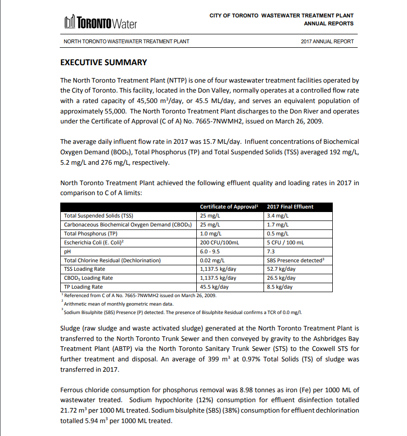

The Wastewater Treatment Plant may be more opportune than first meets the eye. Putting a yard above it may not be possible, due to methane emissions for a start, need for access another, but Googling on it appears to show it being superfluous to need. I'll dig further on this, but it's original intent of dumping into the Don is now greatly curtailed, and I suspect all of the flow rather than just some can be handled down at Ashbridge's:
https://www.toronto.ca/wp-content/uploads/2018/05/951a-2017-TNT-Annual-Report-Final.pdf
For any "trees that would be lost", green credentials could be balanced by eliminating the Treatment Plant. and using the space for a 'Green' cause. Excellent pics here:

No, no, no. The deep tunneling ended (hopefully) at just south of the new Millwood bridge.
It's maybe 1200m through Thorncliffe - not worth launching the TBM's, especially considering that there will be 100m (platform only) to 200m (including some utility rooms) of open excavation anyway. A TBM launch site (and extraction to a lessor degree) is much more disruptive then simple construction of a portal - so add another 50m to 100m to the above. Also, by being shallow, you can bridge over the West Don River and actually have that station at Overlea and Don Mills. If you tunnel under the West Don, the depth becomes prohibitive and the Flemindon station would not be feasible.

It will of course be up to the bid winner as to how they want to construct the line, but I digress on your presumption of cut and cover for that section, as Crosstown, TYSSE and other projects have set a precedent for tunnelling vs. cut and cover for Toronto.
I see this as the opposite to you: Why *wouldn't you* tunnel through Thorncliffe with the opportunity for such relatively easy access from two portals and the opportunity to keep the tunnel gradient so close to neutral and the ability to route much more directly instead of jogging around obstacles? Perhaps there's a difference in seeing this as light or heavy rail as that applies to acceptable gradients? I see this as being heavier than typical metros for a much greater capacity and speed of travel. I foresee building this to also host VIA HFR and GO RER emu as is being done in London, Paris and many other cities. That of course, is based on this being funded majority private, and a consortium looking at a larger picture, as opposed to the Ford-Fedeli fellatio of being penny-wise and pound stupid. It would actually be far more worthwhile for a consortium with deep enough pockets to entertain such an outlook. Again, world cities prove this.

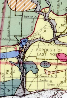

A lot will hinge on the shale substrate depth of Thorncliffe relative to the geology on the eastern side of the valley. I suspect it's very similar, or the river valley (ancient spillway) would have eroded Thorncliffe instead of going around it. Pure speculation, but I'll dig on that.
Addendum:
182405
http://www.geologyontario.mndm.gov.on.ca/mndmfiles/pub/data/imaging/P2204/p2204.pdf
Geology of Thorncliffe Park is similar or same as the area directly to the south of the Don River.
