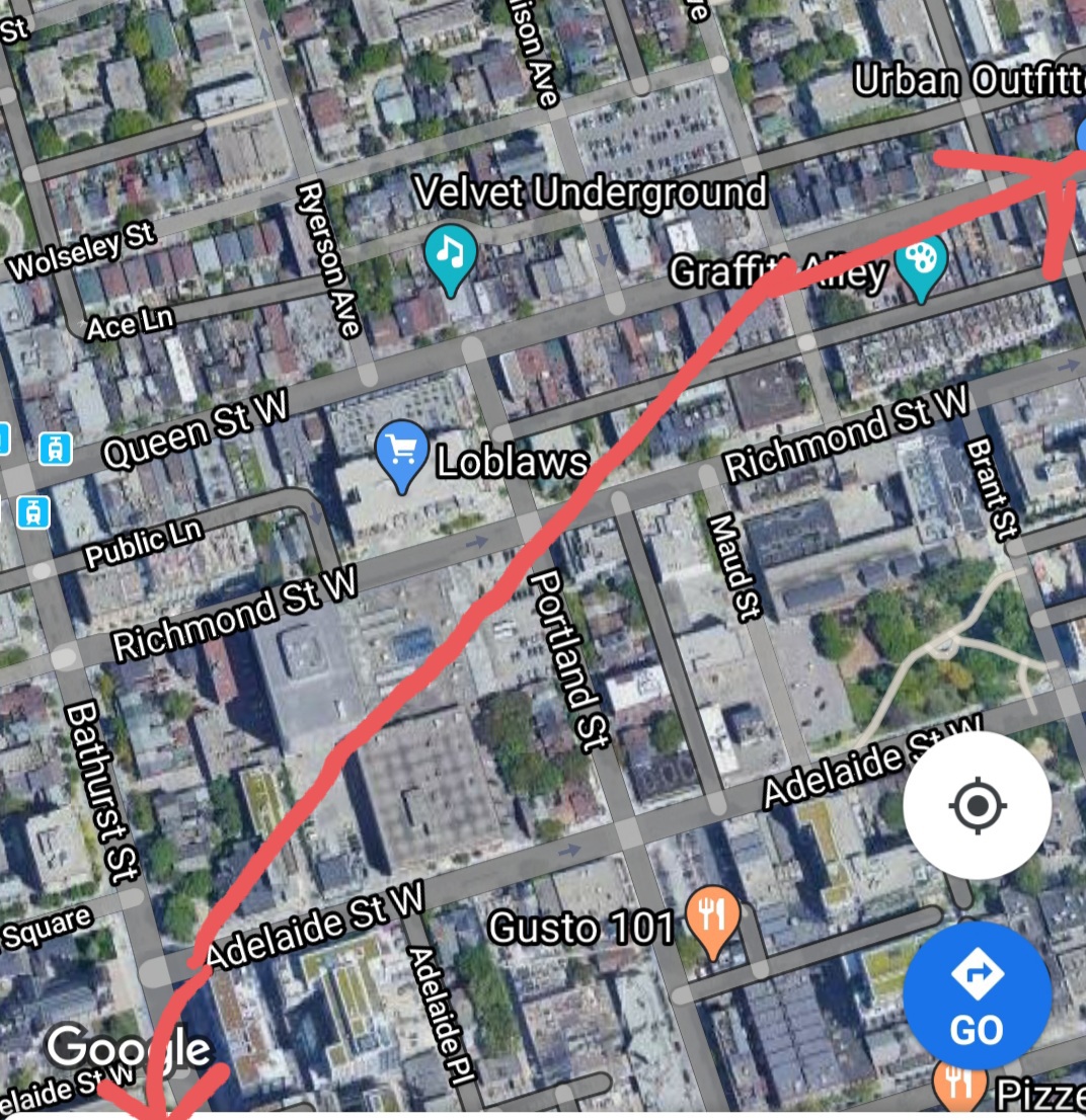

Just a rough guess on the route based on the above. I assume they are trying to avoid as many buildings as possible? This aerial might be outdated and some new construction may have started.
Yeah, they'd want to avoid any condo tower underground parkades.
The Canada Line TBM bored under the underground garage for a 35 storey condo called Brava in Vancouver,
and a "void space" (ie sinkhole) opened up under the parkade, so they had to remediate that.
Going under buildings isn't that big a deal, provided it is done properly. The TBMs used on the TYSSE passed under quite a few of them while they progressed, and yet the spot that gave them the most trouble - although in fairness, the trouble was caused by the property owner and not the construction itself - was when they passed under CN's York Subdivision.
No, the alignment here has more to do with trying to maximize the curve radius, and thus minimize any speed restrictions and ongoing maintenance, than anything else.
Going under a garage isn't a big deal. The big deal is if it's a deep enough garage that it actually gets in the way.
A 1-2 level underground won't be a problem, but a 4 level garage might be. You have to understand which buildings have deep garages and try to avoid those.
And of course if you really can't avoid it you can just dig deeper. The deeper you go though the deeper and more expensive stations get.
