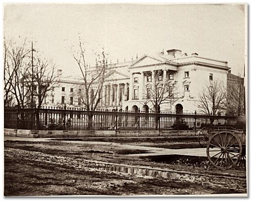

What I would like to know is for what possible reason is it necessary to have the TBM extraction done on the Osgoode Hall grounds. Is there something about the land make up east of Osgoode that we don’t know about? Can you imagine if someone proposed extracting a TBM out of the ground in Piccadilly Circus? In Times Square or under the Arc de Triomphe? But apparently there was no other way at all to go about it in this case?
This sets a very bad precedent that going forward this shady, dishonest, and incompetent organization will be allowed to do whatever they like in the pursuit of delivering their mediocre transit projects. This is a far bigger loss than any material damages they may do to the public realm.
This is probably the only site in the entire city that would be easily recognizable to people who walked these streets over 150 years ago. And some of those very trees getting chopped have been there all along, through the generations.
Osgoode Hall in 1868. Source: http://www.archives.gov.on.ca/en/explore/online/osgoode/execution.aspx
While I have a great sympathy for trees, and might favour sparing the 100-year old Ash tree present on site, if only because I believe there really is a better way to design this station for riders and for the broader public...........
None of the trees present today date from 1868, just saying.
