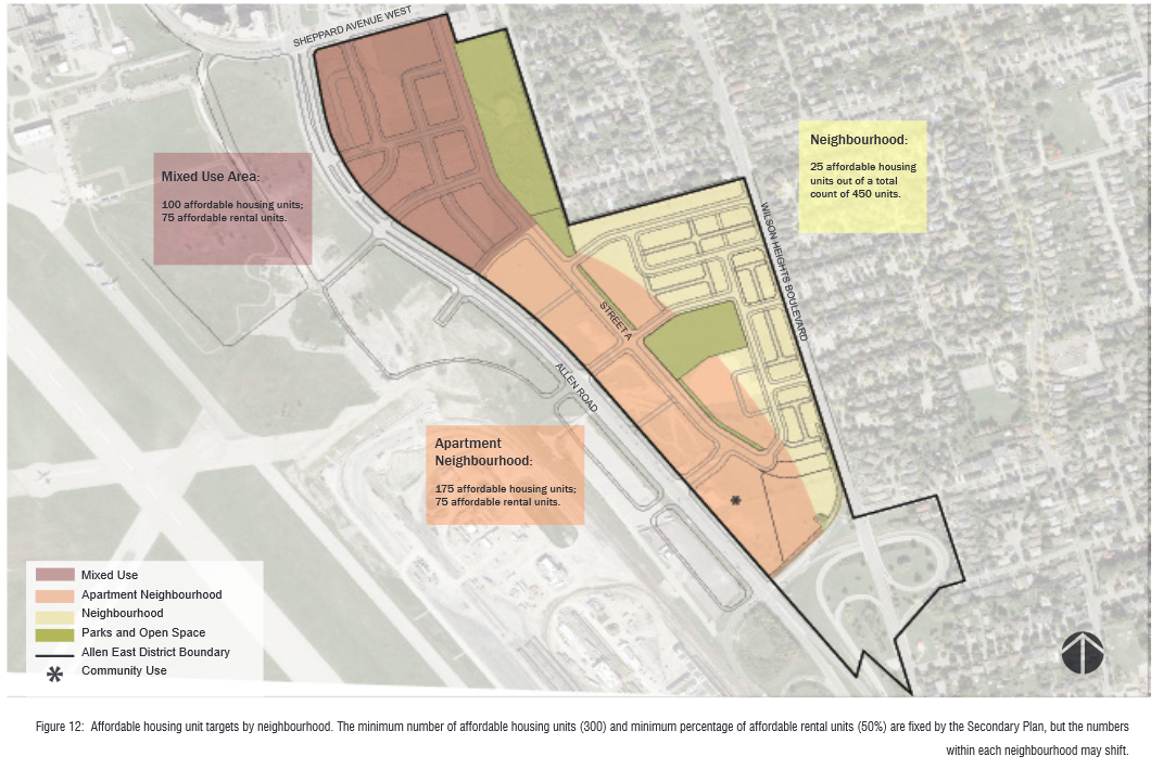

That subway station node at Sheppard and Allen is a great location for new Transit-Oriented Development with strong Affordable-Housing numbers. Hopefully they dedicate some or all of this land into the City's HOUSING NOW program.

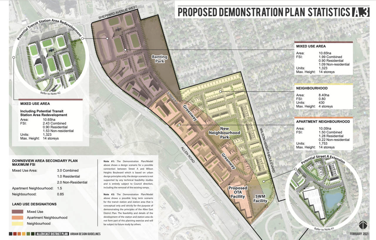

Note:
Building heights within the Mixed Use area are ultimately limited by the Transport Canada Standards for the North South runway currently operated by Bombardier. These standards set out maximum height limits up to approximately 45m. Should Schedule ‘D’ Airport Hazard Zoning Map be repealed in the future, additional height may be considered in the Apartment Neighbourhood, west of Street A, and the Mixed Use area subject to further study at the time a Zoning By-law Amendment application is submitted. [emphasis mine]

  • Firstly, finally this area is being redeveloped - took them long enough!
  • I'd like a little more "apartment neighbourhood" in the "neighbourhood" area, but it does provide a transition to the existing built form to the east
  • 14 storeys max isn't wonderful, but at least they're stating the obvious regarding the removal of the height limits when Downsview gets redeveloped. Would equal more affordable housing, too!
  • TTC needs to get with the program and allow the Sheppard West station to be redeveloped as part of this - I'm glad the plan includes designs for the station area while acknowledging that "TTC hasn't agreed to this"
  • Surprised there's not even a conceptual sketch of what Allen Road / the Allen Road West (Canada Lands) will look like when combined with this proposal.
  • The west side of Allen Road could do with some linear apartment buildings to buffer this area from the noise of Wilson Subway Yard - given that's TTC/City land, shouldn't be an issue to add that, right? Also would help to urbanise Allen Road, too
  • The Wilson Heights Blvd ramps do waste a lot of space, wow! Would make sense to reconfigure the ramps and put the stormwater management pond there instead...

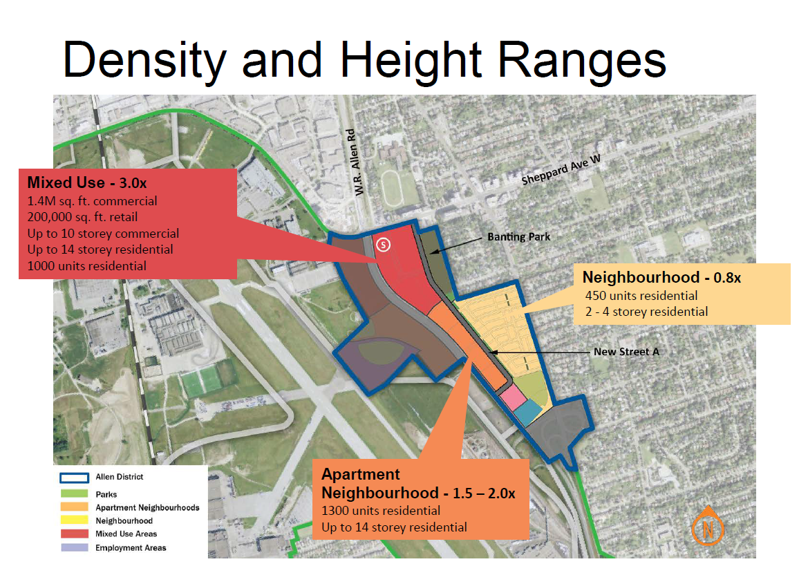

Comparing the 2016 numbers with the above numbers
Mixed Use AreaApartment NeighbourhoodNeighbourhoodTotal
20161,000 units1,300 units450 units2,750 units
20211,323 units1,753 units430 units3,506 units (uplift of 756)
So yeah, a bit of an increase - but the potential for much more if the height limit is removed!
