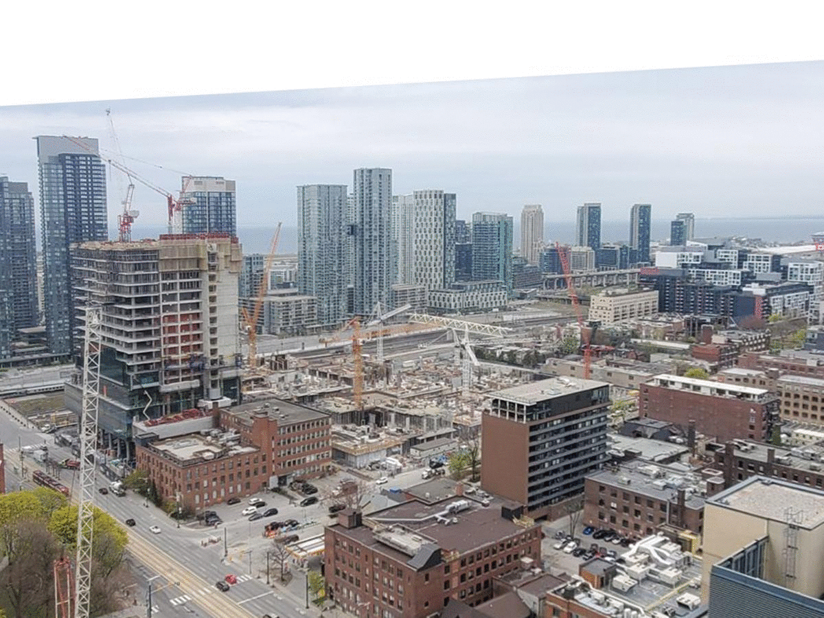

The way this is building out Wellington looks so good from this perspective above that @aznih_aznih posted. This is doing a great job of filling in the transition between the tower zones south of the tracks/east of Spadina and the topology of the King West area.
